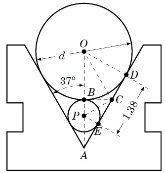

    Yet another (hopefully humoristic) slight detour from the topic of this thread,
    I want to share Example 7, "Solving Right Triangles" from the following:
    https://opencurriculum.org/5483/appl...ht-triangles/:
    "The machine tool diagram on the right shows a symmetric V-block,
    in which one circular roller sits on top of a smaller circular roller.
    Each roller touches both slanted sides of the V-block.
    Find the diameter d of the large roller, given the information in the diagram."
    Theoretical engineering at its best! Data given is assuming the following:
    First: Just make the rollers such that they only have an infinitesimally thin line of contact between each other,
    while both having same against the V-groove's sides (Piece of cake...)
    Next: Measure the distance between the two roller's contact points at the V-groove,
    where its included angle is 74 degrees...
    Reminds me of similar phrases from my books some 40 years back:
    "Omit friction, aerodynamic loads and the beam's own weight in your calculations."

    Theoretical engineering! The operative scope of Unlimited Resources, like an infinite diameter range of gauge pins.
    Suggested method by percentage looking better all the time...measure width, know 1/2 the included angle, get the sine.
    Occurs to me, while two contacting pins quite hard to determine, two decent size cylinders measured separately would achieve result easily.
