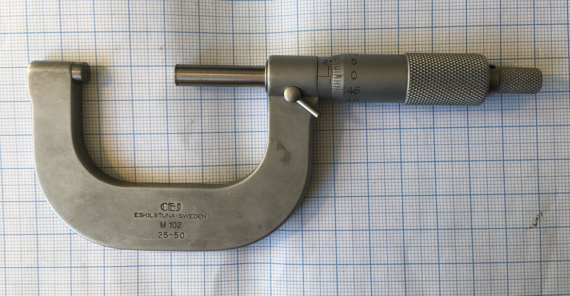

    No small gift: A C.E. Johansson (Yep - where the Jo Blocks came from) 25-50 mm grimy micrometer.
    He'd bought it in the worn-out original cardboard box at a flea market for 2 bucks...
    1 hour of cleaning, lubing ("Pjur" silicone oil for "sex toys" from the drug store*) and final adjustment:
    Right on the money - much better and more nice feel than my Chinese one of the same range.

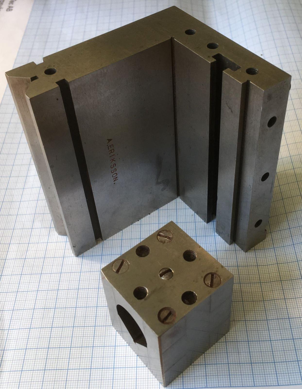

    I instantly spotted the over-engineered precision angle plate and the V-block
    (though I've never before seen any of those in my meagre life),
    and totally lacking impulse control, I blurted out the apparently correct reply.
    He seemed satisfied as he smiled, dumped them over to me and vanished down the corridor.

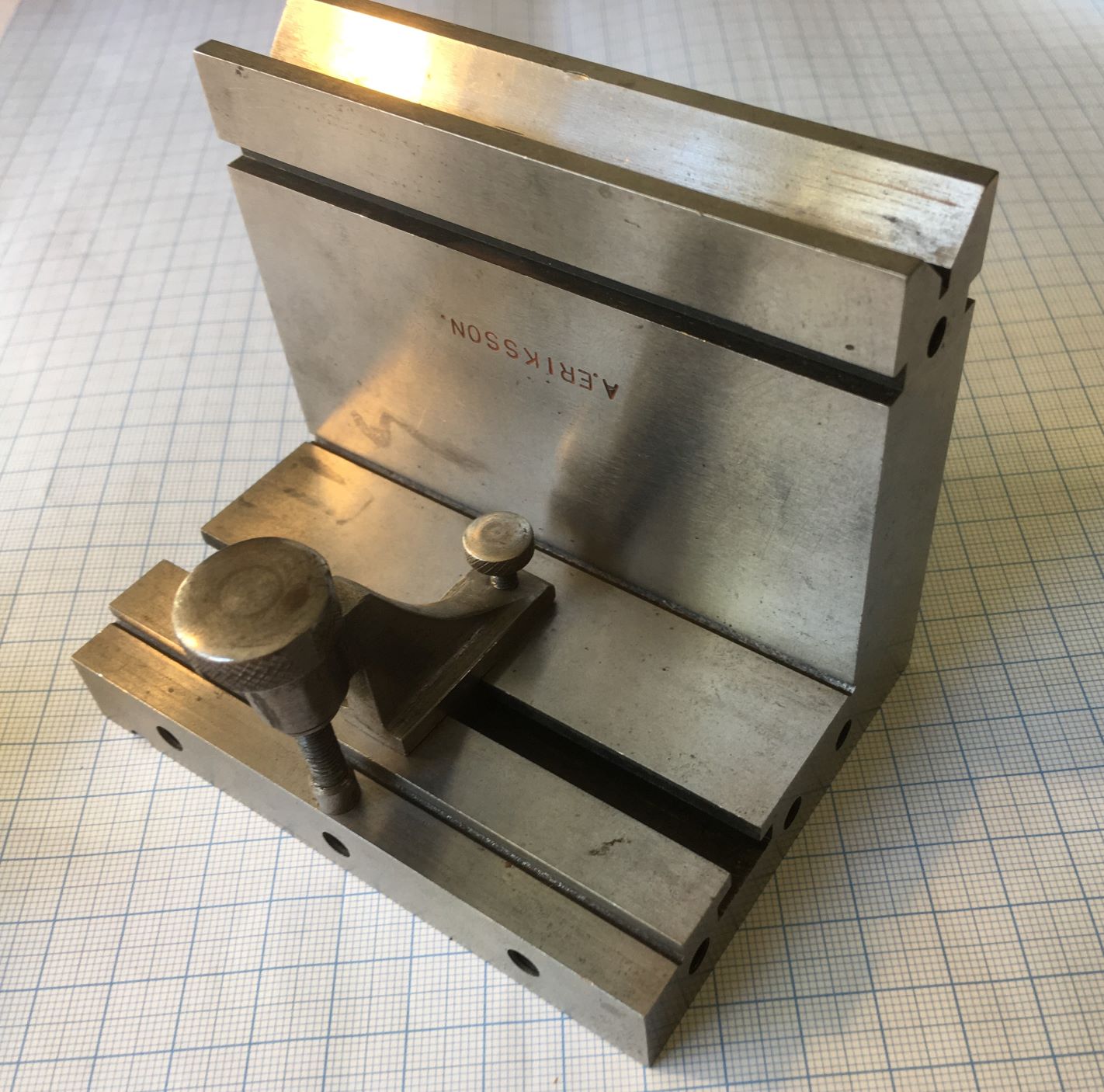

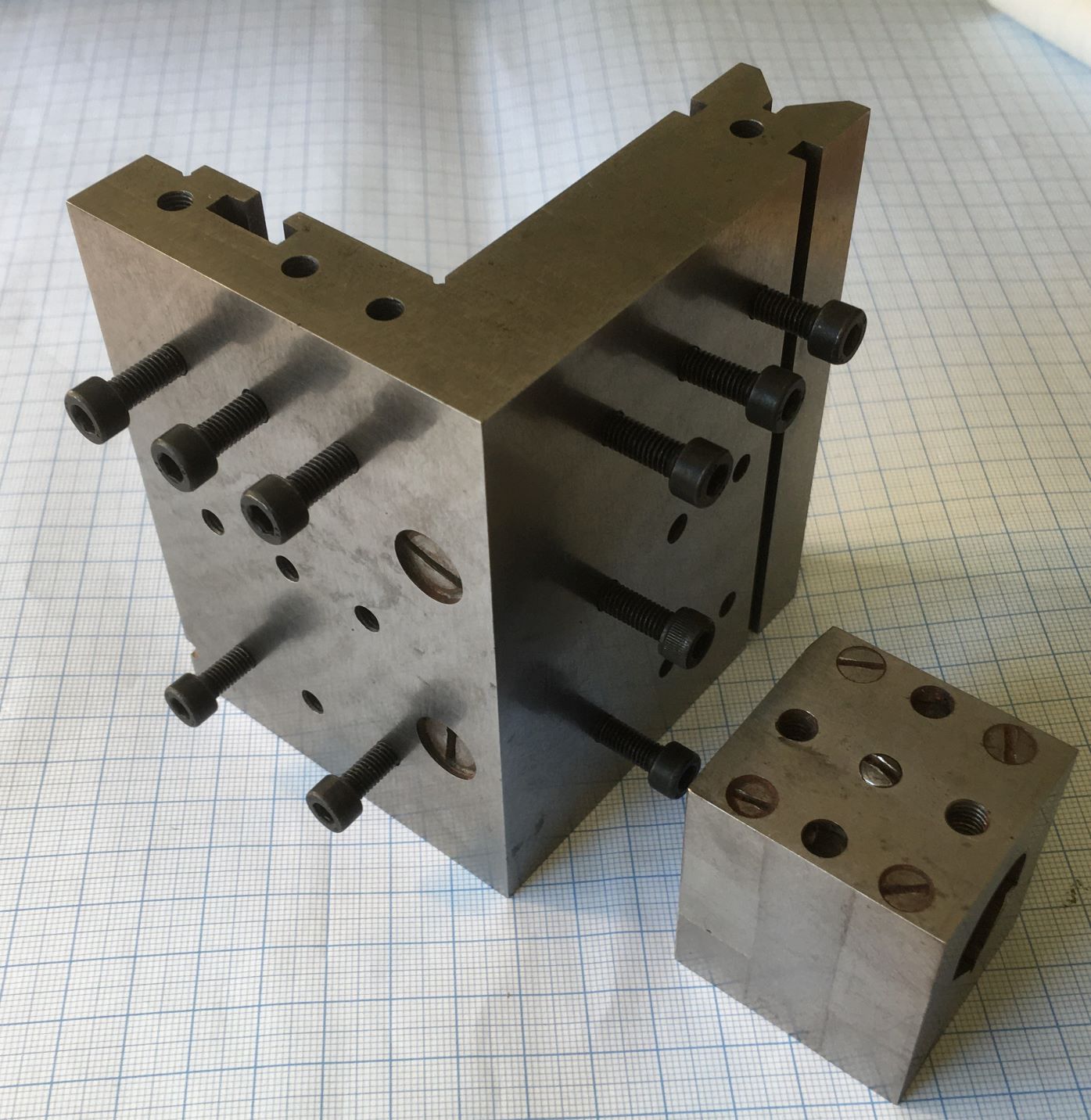

    Precision Angle plate & V-block-precision-angle-block-clamp.jpg Precision Angle plate & V-block-precision-angle-v-block.jpg Precision Angle plate & V-block-v-block-interior.jpg
    Info is scarce on the pieces: Bought in a flea market in small town close to Stockholm,
    previously habitated by small and big industries until the many crises thru the last 40 years.
    Probably the result from an (assumed) apprentice "A. Eriksson" stamped in the vee.
    Assumption based on the odd-ball dimensions, though the work itself & grinds are flawless,
    they've also suffered some abuse from tools and handling thru the years.
    1st (crude) Measures:
    Angle plate:
    102,5 mm wide. 85,9 high x 22,5 thick. 75,05 deep x 18,0 thick.
    Its T-slot: 13,8 wide by 4,2 mm high at bottom - slot 7,3 wide by 3,3 deep
    Clamp holes: M4 with 3 rows of c-c:s 16 x 32 mm on each side

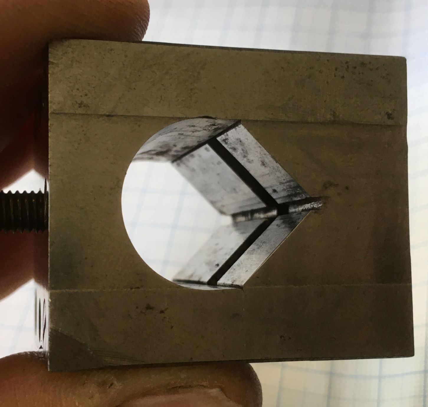

    V-block: 39 x 38,25 x 45 mm high, a two piece deal, hardly recognizable: pinned and bolted construction,
    internally transversely and centrally offset cut V-groove.
    Just wanted to share what Providence turned up (for free) to yours truly,
    while I was still desperately looking for a hardened wrist pin for a cylinder square!
    The pieces' final squareness and hardness measures will have to wait 'til my vacation starts in 2 weeks,
    when I'll completely geek down and at last return to my walk-in closet workshop!

    The angle plate is a most interesting tool and seems well made.
    Thanks for posting it!

    I predict you will tool-up a pair of yoke clamps for the Vee groove. People sweat under cutting the lugs for each side, so don't.
    Drill larger than max effective size Vee holds [minding that increased centerline].
    Stand up and tap for a clamp screw.
    Rotate 90°, drill and ream for a press fit dowel.
    Mill across that hole from clamp center an opening just wider than the block.
    Press short pins through either side.
    Saw off bridge at scrap end, and finish.
    If undercutting is desired, a decent Woodruff cutter will do. Hold the part up right in slotted, temporary jaws.
    Either way, a pair is worthwhile. Allows re-setting one while other stays in place.

    Thanks you guys for cheering and machining tips for saddle clamps-
    very unusual and clever solution with hardened dowel pins for lugs!
    I think I'll make a few after complementary checks for perpendicularity and flatness.
    The "front" clamp (3rd pic from last) seems made through benchwork only,
    very intricate profile and I assume the screws shows forms from the forties or fifties.
    The hold-down screw has a small anvil towards the milled and relieved ledge,
    anybody having a guess what (<15 mm thick) it was intended to hold 15 mm from the bottom surface?
    The top knurled screw, as well as the angle's top back shows witness marks from a few milling attempts.
    The angle's sides are not equally thick though - they both "thin out" some 5/100s of a mm from root to edge.
    I wonder what intended height the top V-groove was intended for, with what diameter for its rod?
    Interesting to see the angle's deviations/ tolerances and whether they can/ will be corrected...

    IIRC, mklotz & Tony Foale presented formulae to determine maximum effective round size for a Vee. Seems to me, 70% of full distance across as a chord reveals that diameter. I have near 0 luck with searches herein.
    Far as center height, that changes with each diameter; the block may have been made for a size that matched a steady or center.

    I certainly don't remember making such a calculation.
    If we want to determine the maximum size of cylinder the block can accommodate* we have to first establish the measuring configuration. Just spitballing, I would think something like...
    The chord between the two points of tangency of the cylinder with the V should be at least X distance below the line defining the width of the V opening. X might be defined as a percentage of the depth of the V measured perpendicular from the opening to the vertex.
    Of course, the angle of the V would need to be specified. Most are 90 degrees but 60 degree exist.
    Seems like we're not the only ones confused by this issue...
    https://www.practicalmachinist.com/v...y-mean-297809/
    * A tacit assumption here being that the cylinder may not be supported on the ends of the V but rather must be enclosed within the V.

    -So, for maximum dia "2r" to fit in a given V-groove (with included angle 2a),
    the dia's top must not have a greater stick-up than r+r sin a?
    Or your "X" is at least (r sin a) below the top of the V?
    Am I mistaken this late night after a full week's work?
    But before that - to even get the angle, I'll first need two dowels of different dias,
    a surface plate and an indicator with stand just to get started...
