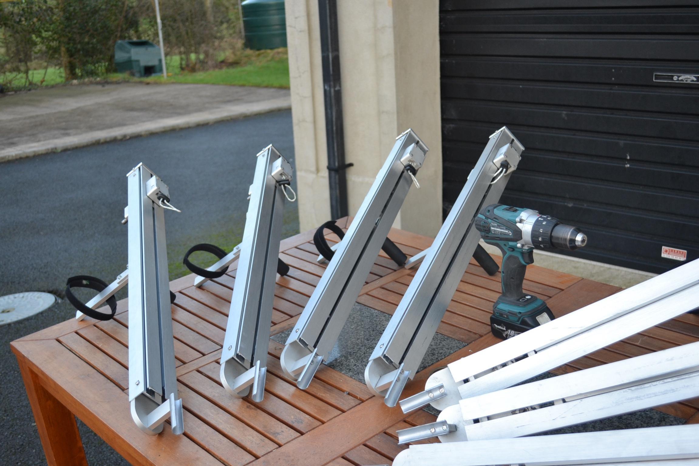

    So, a few weeks after open heart surgery for an aortic aneurysm repair, I thought I'd power wash my patio. Trying to start the power washer was a silly idea (and really, really sore !). So I built this tool to do the job. I'm raffling one of the tools with funds raised being donated to the World Heart Federation. I hope you like it. All comments welcome !!
    Have a look at the link below.
    See picture of newest version (bespoke extrusion and properly machined parts). I having some of these factory made.Hopefully they'll be available end of July.

    Great tool! I'd thought the pull action would be sluggish, but no.

    Thanks for that - To get over the 'sluggish' problem I put a little trick inside the unit. When the cord is being returned to the engine the drill is still actually working by charging (or stretching) a strong bungee cord. That means the on the pull stroke the drill is assisted by the energy stored in the cord - ie both the drill and the energy in the cord act together and this provides an almighty pull strength . That old saw required a strong pull, the tool is more than up for the job.

    So that's it! Thanks for elaborating, that was a clever hack.
