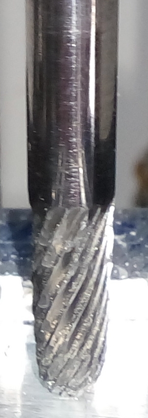

    A quick and easy lawn mower repair

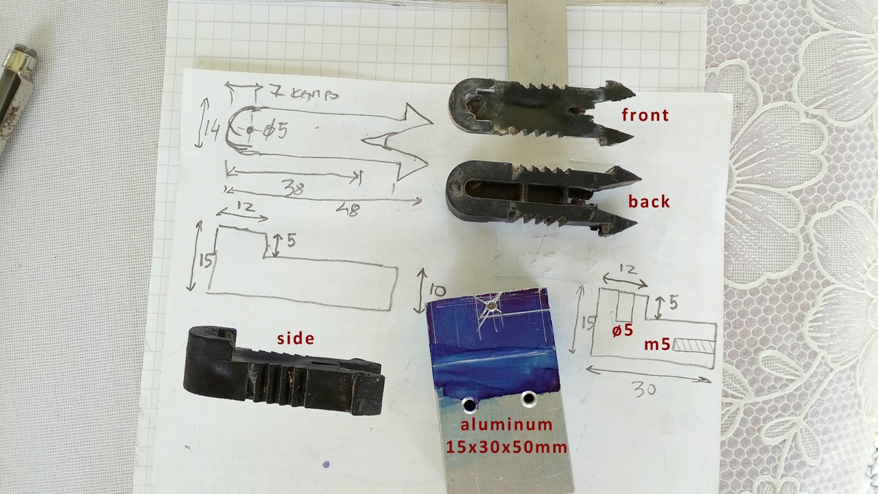

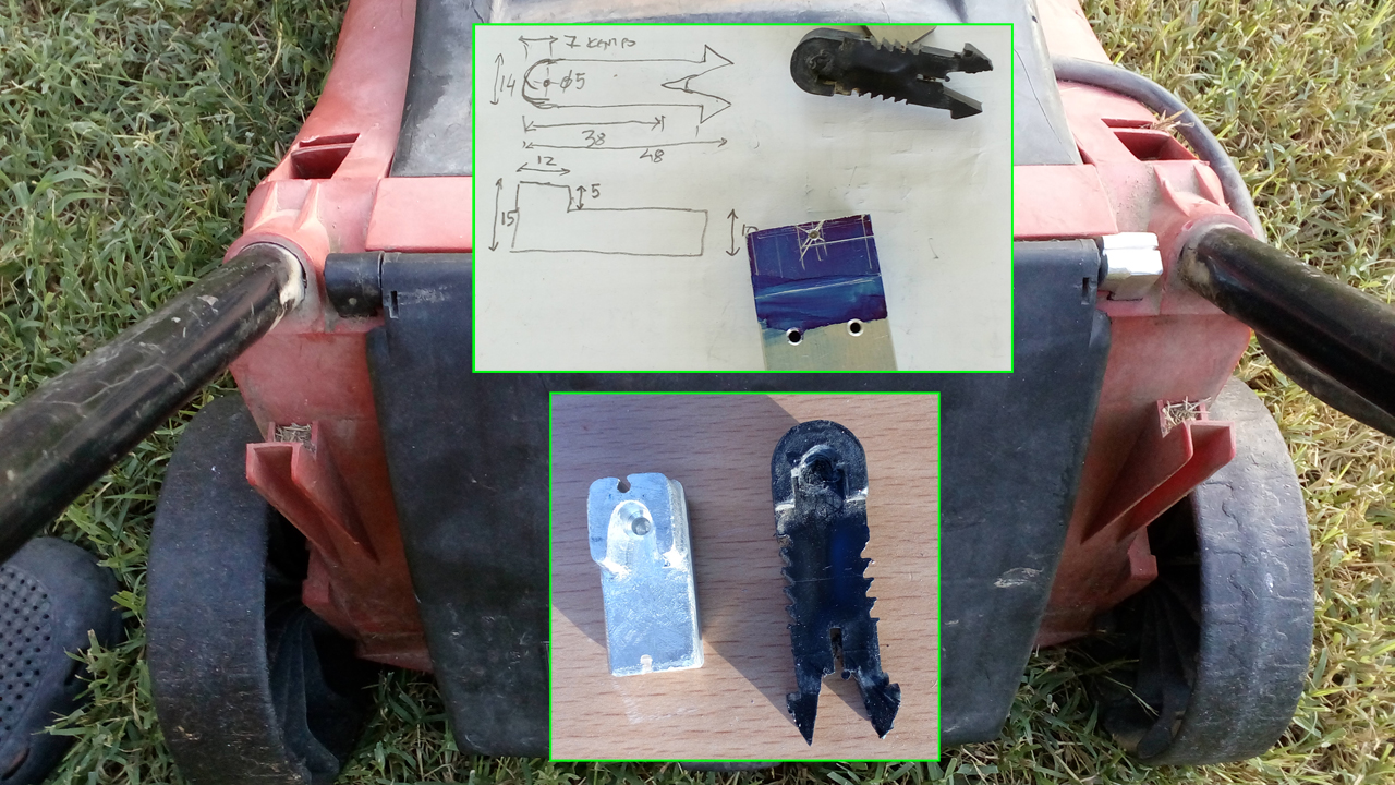

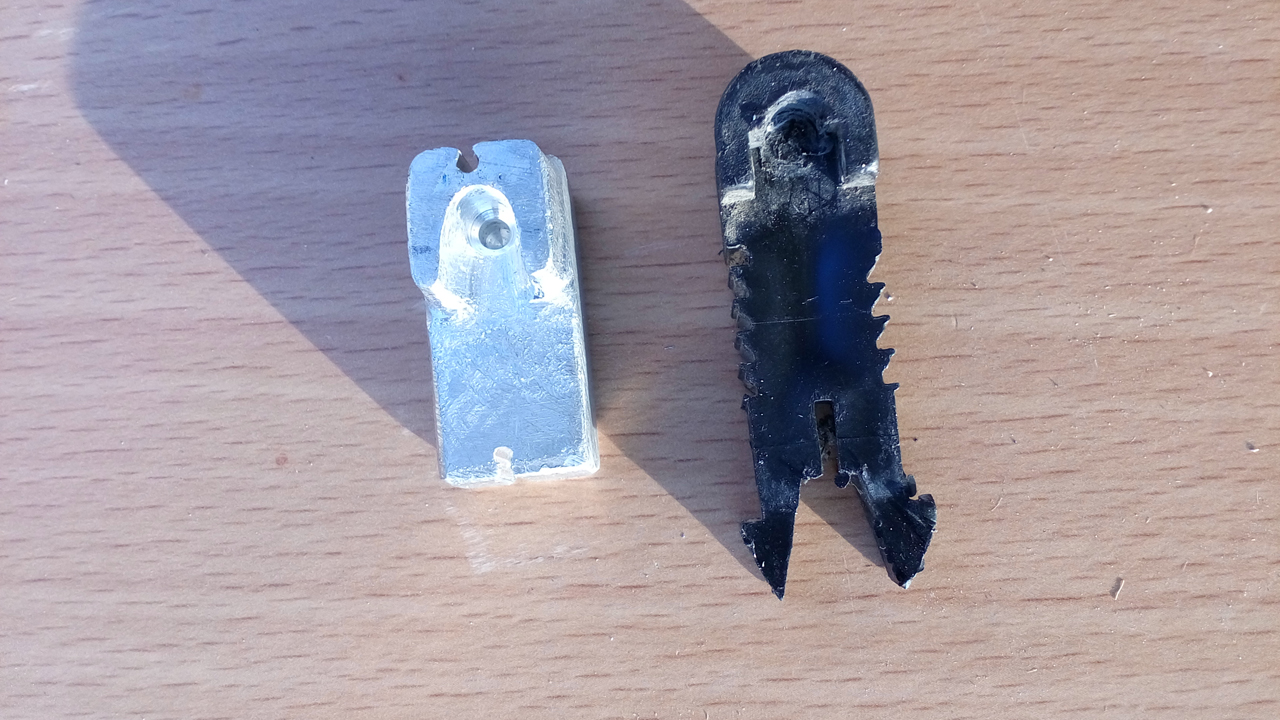

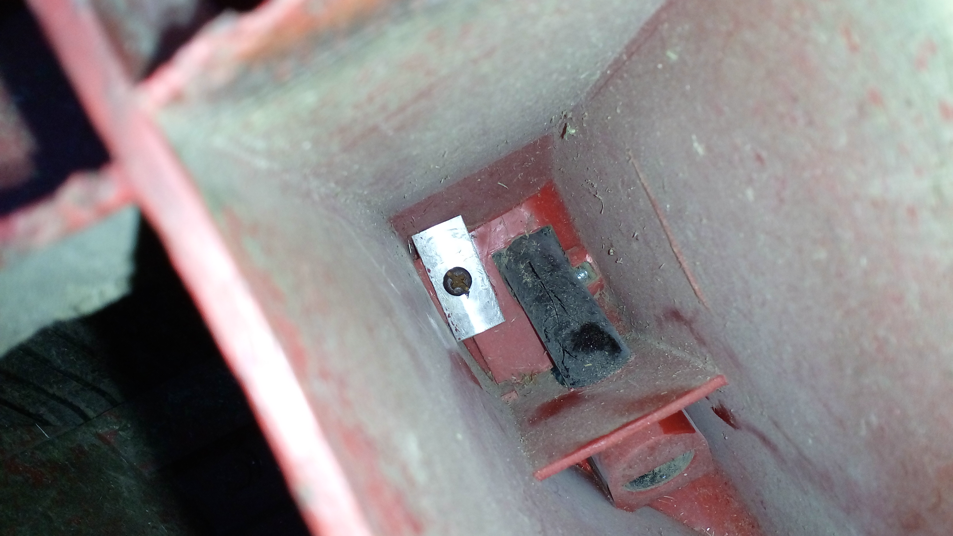

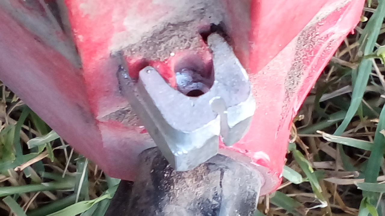

    Replacement the damaged/broken plastic fitment with a new one made it from a piece of aluminum using simple tools;
    Hacksaw, file, drill press, drill bits (ø3 - 4.2 - 5mm), m5x0.8 tap and a cutting/engraving tool
    that I am not sure what is the correct terminology in English.
    A quick and easy lawn mower repair-first-frame.jpg A quick and easy lawn mower repair-img_20180815_123435-3-pos2-3.jpg
    A quick and easy lawn mower repair-img_20180815_191117.jpg A quick and easy lawn mower repair-img_20180815_195910.jpg

    Nice job making a new collection bag mount, it should give you a good service for a very long time.
    You may have been able to save yourself a lot of pre drilling with a different tooth count hacksaw blade.
    I try ti keep an 18 or 24 tooth blade around for things like that. the fine tooth blades clog up too much for me. Like you no doubt found out since you had to drill a line of holes before making the shape cuts.
    In some areas the coarse tooth blades are hard to find but worth it.

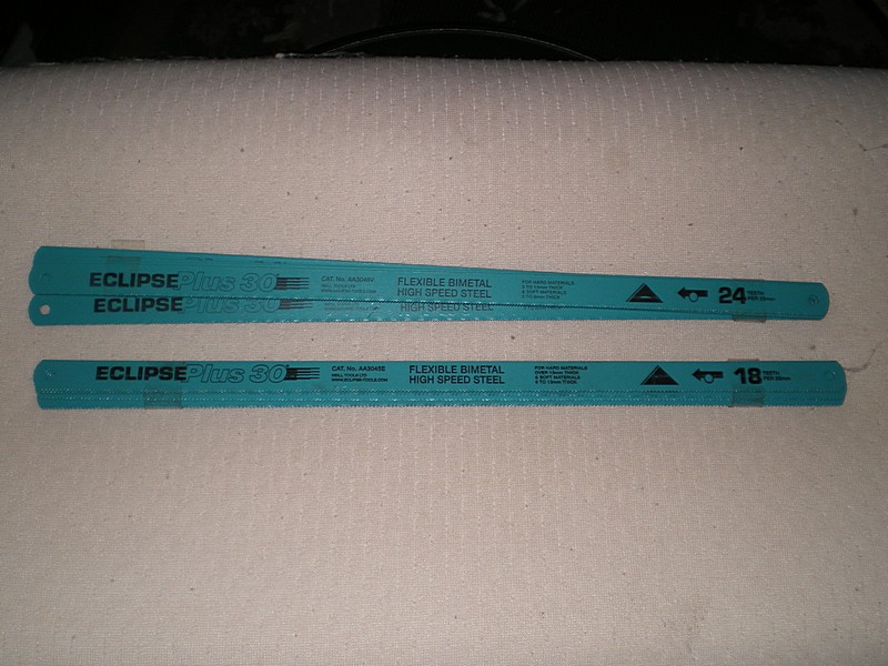

    Quote Originally Posted by kess View Post
    I have searched many times and I can’t find such blades at my city's market any more.
    Perhaps it is an accessory that dying, if it hasn't die yet.
    But I think that we can live without that.
    Kess these are plentiful from Ebay suppliers and this type I have found the best for my hacksaw machine and hand frame. 24T can be useful for thin stock and harder metals.

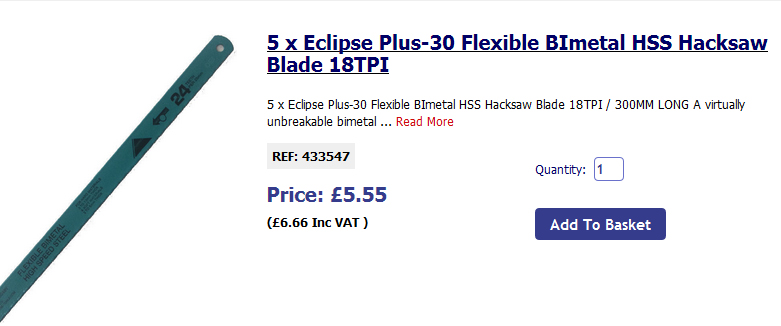

    Ηι Toolmaker51,
    Doing a quick search I found today in England, the blades of the brand that Olderdan has proposed.
    As my son lives in England, I will call him bring me a pack of 18 and a pack of 24tpi when he comes for Christmas.
    I do not mention the link because I'm not sure if allowed by the forum's rules.
    Regards
