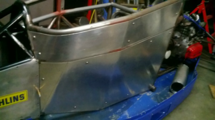

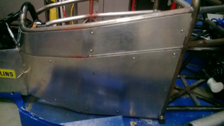

    Some more progress on the car. Made new inner body panels and mounts, these really soaked up a lot of time.Racecar project and chassis jig-ip1.jpgRacecar project and chassis jig-ip2.jpg

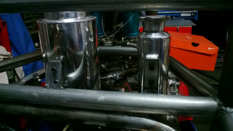

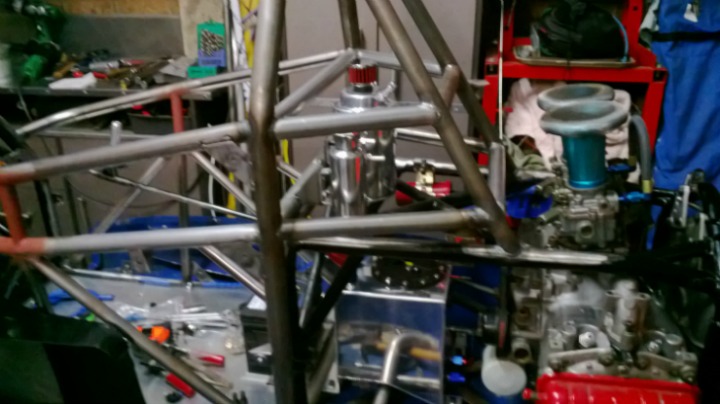

    Fitted an new fuel tank, header tank and oil catch can.
    Racecar project and chassis jig-ht1.jpgRacecar project and chassis jig-ht2.jpg

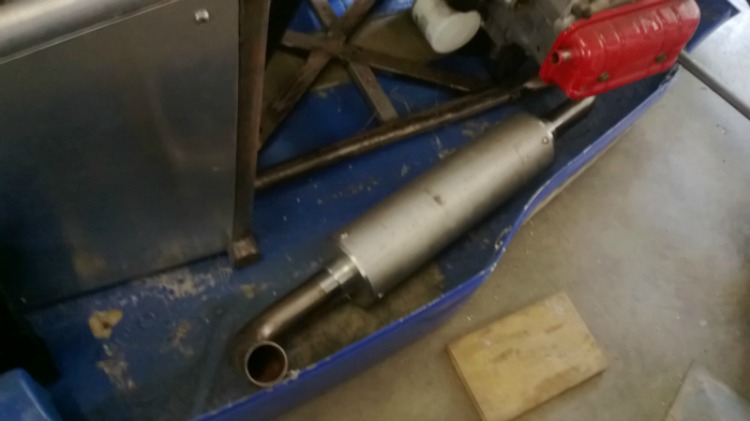

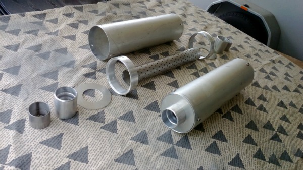

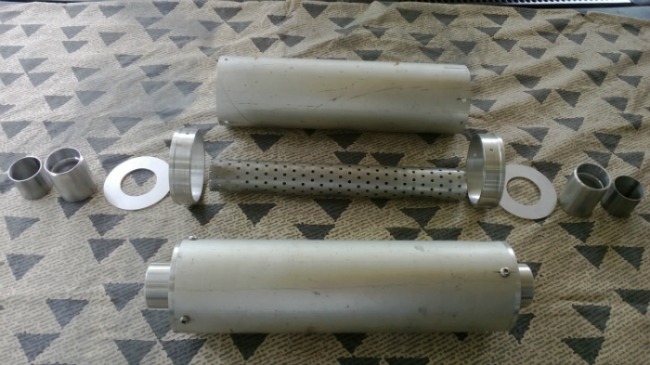

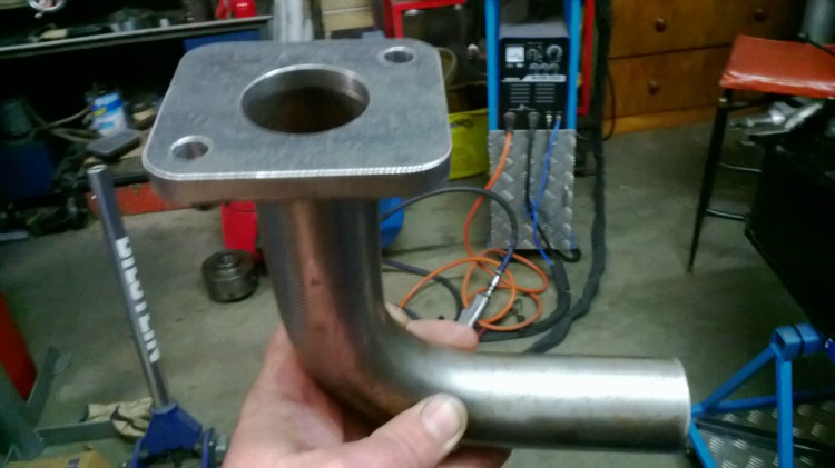

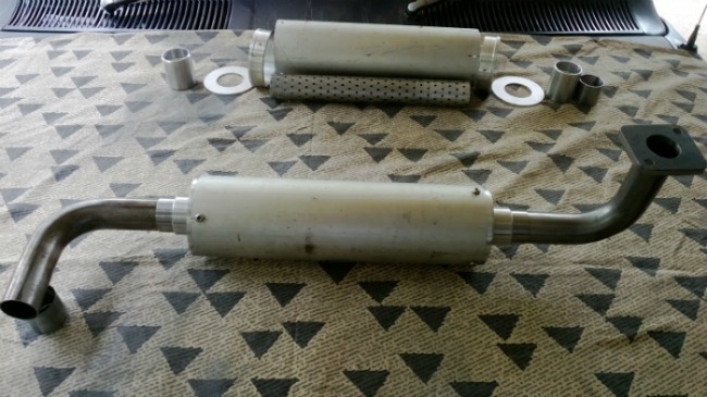

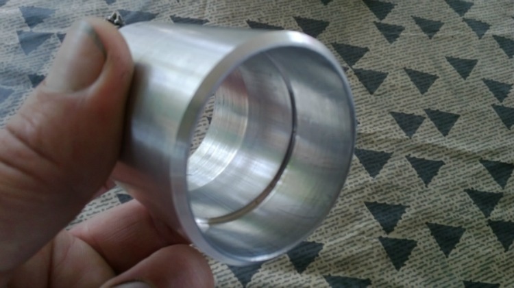

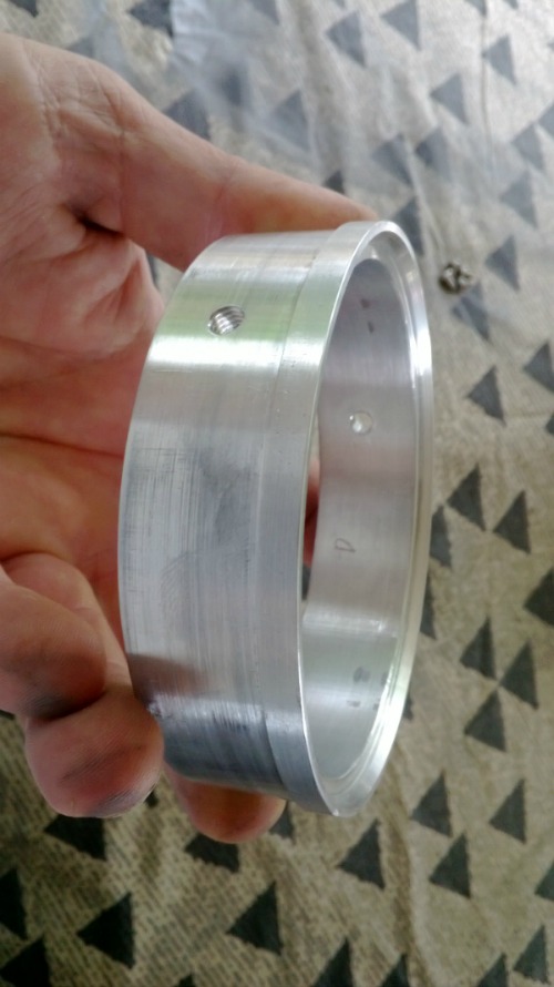

    I am making my own mufflers as I could not get commercially available ones to suit what I wanted. The main muffler body is 100mm by 1.5 wall, I had intended to machine the end caps from 1 billet but that was going to become expensive so I machined end cap rings from 100mm x 6mm wall tube, the rings were tapped m6 in 3 positions on each cap to allow me to disassemble to repack the mufflers. and made end plates from 3mm plate. The end cap socket I made from 50mm x 6mm wall, they were bored to fit the perforated tube on one end and an adaptor sleeve on the other end which will be welded to the exhaust tube. are all yet to be welded together. Just hope the sound is OK.
    Racecar project and chassis jig-ex6.jpgRacecar project and chassis jig-ex5.jpgRacecar project and chassis jig-ex2.jpgRacecar project and chassis jig-ex3.jpgRacecar project and chassis jig-ex4.jpgRacecar project and chassis jig-ex7.jpgRacecar project and chassis jig-ex1.jpg

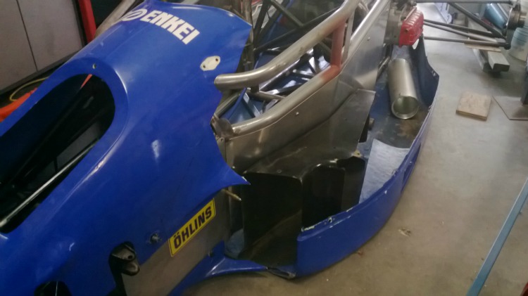

    I decided to run the exhausts forward in the body exiting out the side of the undertray, this made the exhausts much easier to make rather than running them through the suspension links and out the back.

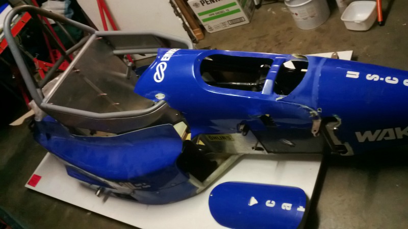

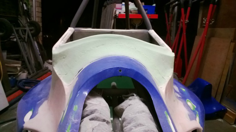

    I have cut the original fibreglass bodywork to allow widening and am in the process of fitting all of that together with radiator ducts and new mounts.Racecar project and chassis jig-xp1.jpg

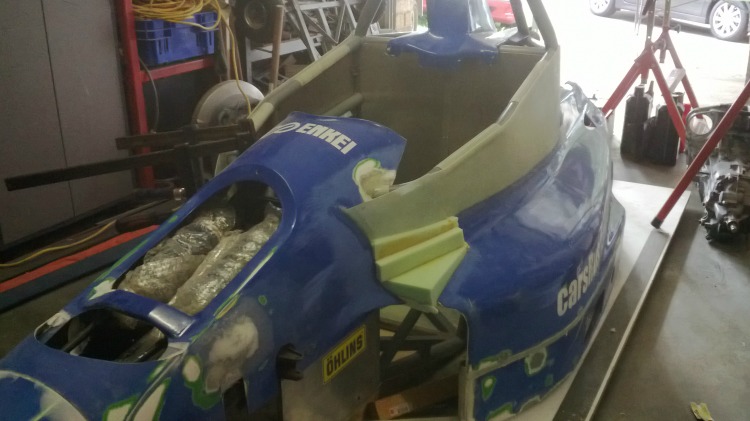

    I have the fiberglass bodywork mostly complete but still some work to go. The original bodywork needed some freehand blending which was helped by the use of polyurethane foam blocks and some flat fiberglass sheet which I laminated. When finished to a final shape this was glassed over and the foam was removed from the inside and glassed on the inside. I could have left the foam in place but polyurethane foam creates a cyanide gas when burnt. Not that I intend burning the thing, but you never know.
    The side pod bottom edge was raised by 10mm to allow more support around the dzus fastener holes as the old ones were very close to the edge and cracked easily. Exhaust outlet flanges were fitted to the undertray and will be riveted on. New mounts have been made for the nose hatch which allows access to the shocks and pedal assemblies.

    The original head rest was sectioned and raised in height and blended with the surrounding bodywork and air box.
