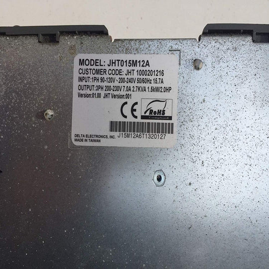

    I thought I would look for the motor (a replacement part) online, not much to see, but I did find a controller for a Matrix T7xi and here is the label on it:
    reversible pole receptacle-motor-control-board-t7xe-t5x-t7xi-t7x-controller-0000094477-works-w-matrix-treadmill-motor-52994.jpg
    So - that motor controller output is for a three phase AC motor and likely is a VFD. Check the controller of the treadmill you are getting and you may find the info you need...

    The motor model # is JM11-007. It is for a Matrix brand treadmill. It's AC 60Hz 3ph and 1500w (230v X 6.5A) thus 2hp. I'll have 2 motors and 3 treadmill decks. I intend to power the 2 outer decks and to cover all 3 with a single conveyor belt to assure a smooth surface for lateral transition/footwork and to make sure the decks turn synchronously.
    I have the controls from one of the treadmills, which includes speed control. My thought is to gang the 2 motors through a single gang receptacle (connect with a 2 receptacle pigtail?) with the one speed control wired upstream from the receptacle and still within the gang box. I also want to reverse the motor direction, which I'd like to do within the gang box.

    These motors have their speed controlled by voltage not frequency, most are DC anyway needing a frequency of zero.
    He has three phase motors from the treadmills - thus they are controlled by frequency using a VFD - variable frequency drive.
    Three phase motors are induction motors. While there is a voltage component of the VFD, the primary control of speed is the frequency of the AC 3 phase waveform (there is a voltage component in VFDs which is used to keep the motor from overheating by keeping the magnetic flux within the design parameters).
    Yes there are many treadmills that as DC motors, but not these...
