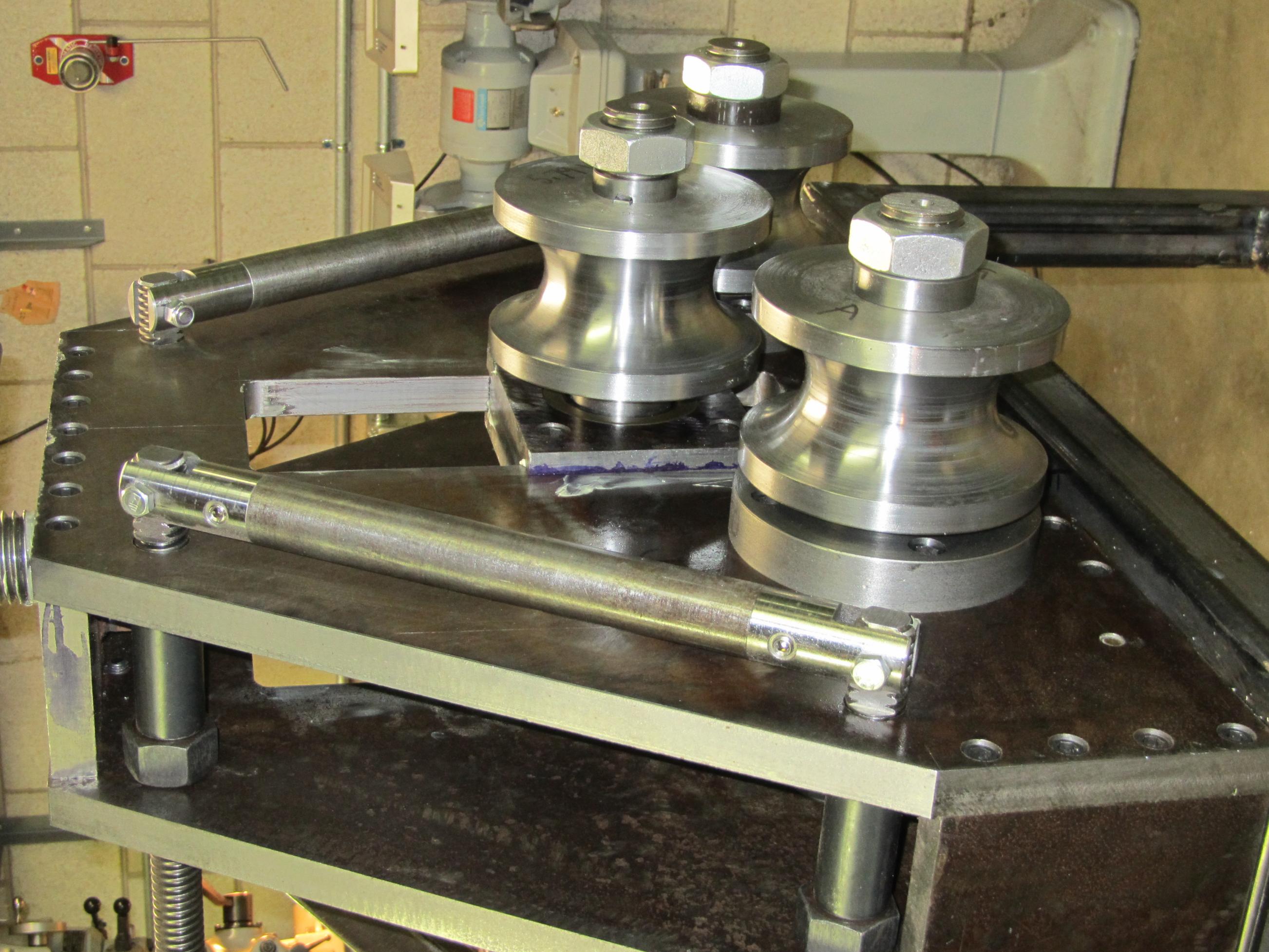

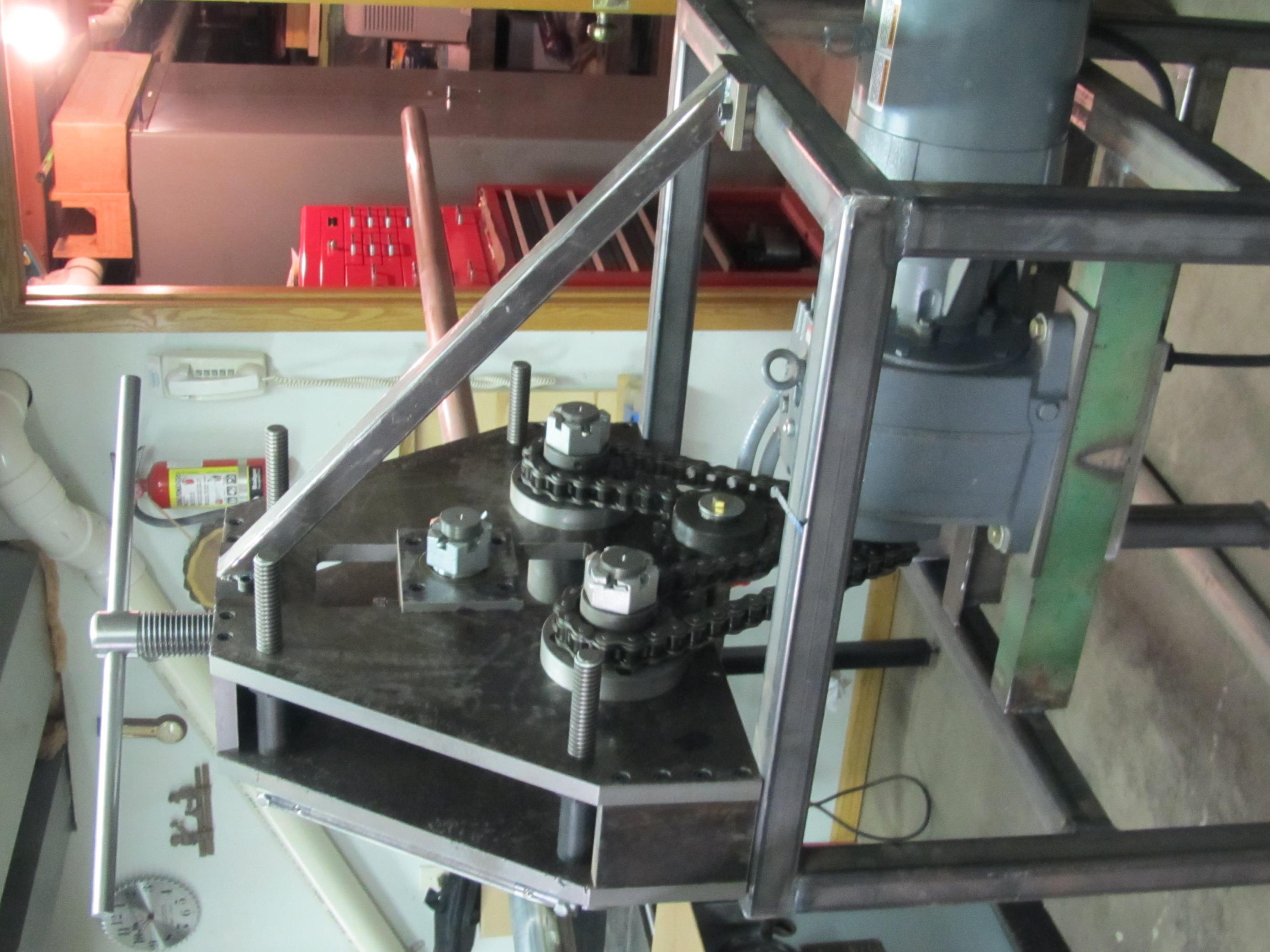

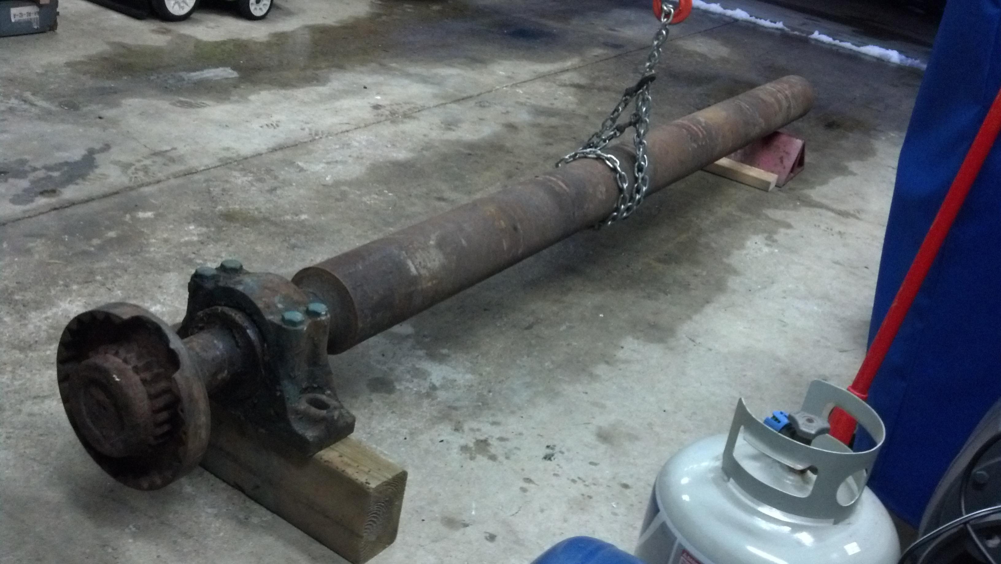

    In the process of building a boat I ran into a problem which required the fabrication of a new tool. The rub rails for the boat are schedule 40 aluminum pipe 2 1/2" in diameter. They require significant bending along a radius of approximately 14'. I tried numerous ways to bend the pipe without a roller and wound up kinking the pipe every time. After consulting some commercial boat builders the general consensus was that a ring roller was needed. Heavy duty commercial ring rollers are extremely expensive so I decided to build one. My design utilizes 7/8" plate sides (that just happened to be the thickness I could find used). The shafts are a little less than 2" in diameter, riding on huge tapered roller bearings that are adjusted for end play using castle nuts and cotter pins. The roller shafts are driven with #80 chain and a huge gear box. I've use a VFD to control the speed and direction of the rollers. All the dies for the roller were made from a piece of 6" diameter steel repurposed from a sewage treatment plant in Michigan. The roller has worked very well, bending huge pipes without any kinking. The pipes are bent then compared to a full-size template of the radius. After the pipes are bent they are split on a band saw. Sorry for some of the pictures, the downloading software rotates them and I can't fix the problem. If anyone knows how to fix this problem let me know, I have more tools to post.

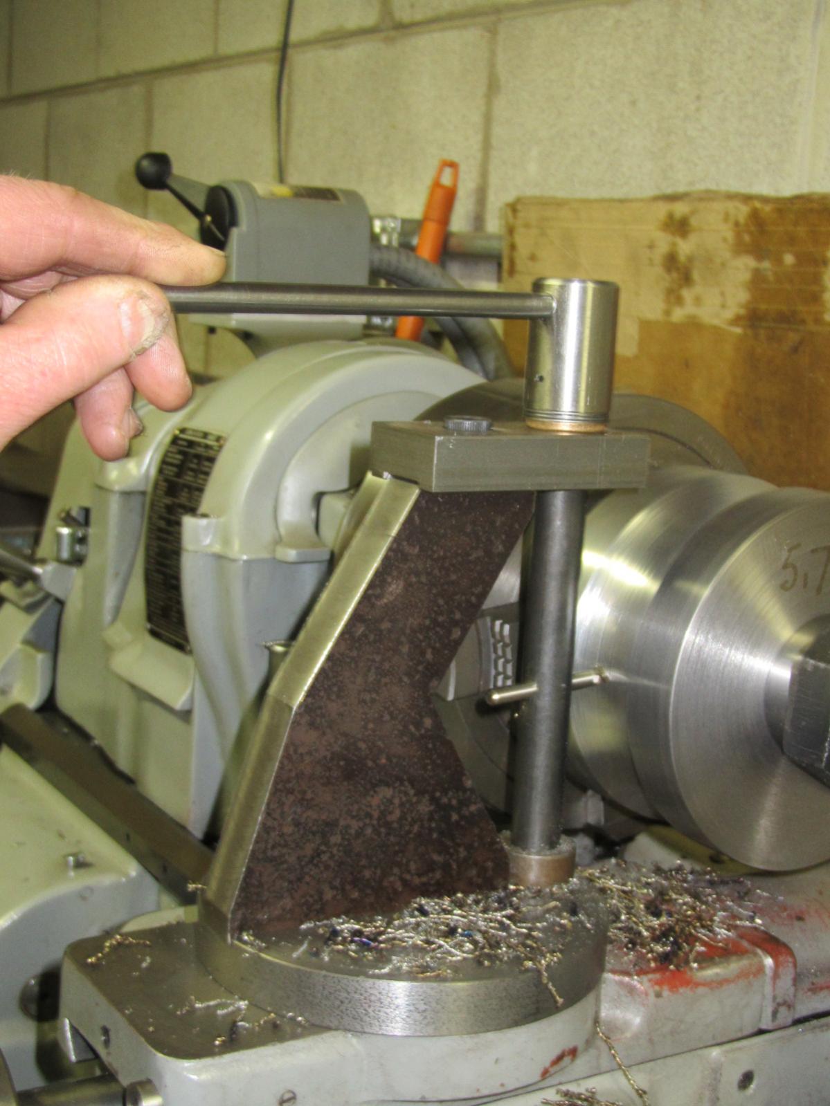

    Thanks Iliketobuild! We've added your Radius Turning Tool to our Machining category, as well as to your builder page: Iliketobuild's Homemade Tools. Your receipt:

    It was fun to make but took lots of precision machining to get everything to fit and work smoothly.

    Speaking of precision machining, I like the large-sized radius cutting tool you built for your lathe. Looks like it can handle some large parts.

    Iliketobuild's Tools
    Yes, it works surprisingly well, made it out of some scrap material I had laying around. It is custom fit for my 13" Southbend lathe.
