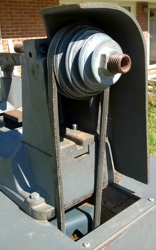

    I have a rockwell/Delta wood lathe and I need help. I want to put a wooden wheel on the spindle end at the motor end. The spindle working end has a 1" x 8" spindle end. On the opposite end, where I want to add a wheel, nothing with a 1" x 8" will screw on the spindle. Does it have left hand threads? Any help would be appreciated. Thanks, zetuskid

    Similar to this is what I want to do is put a wheel on the end of the spindle.

    i went to this site lathes.co what it said was the 14 X 36 rockwell used a threaded 1" X8 thd RH on the inboard and a 1" X8 thd LH on the outboard end, i would start with a 1" x8 left hand nut to make my bowl turning faceplate, buck it underlined it and wiped out half of the site so here it is again www.lathes.co forward slashdennorske fwd slash page3 dot html buck

    Thank you so much Buck. That explains a lot. Thanks for your follow-up and research. I just knew you guys would come through.

    The outboard is a 1" 8 TPI LH thread. Suggest you purchase a LH Delta 3" or 6" faceplate (some are LH AND RH) and add a turned wood disk to it.

    If you look carefully at the photo, you can see from the slope of the thread that this is a left hand thread. In all things like this, just imagine whether or not the tool offered up to the job is trying to tighten or loosen the the chuck. The torque produced by the tool must always be attempting to tighten it.

    Thank you, that's a very good suggestion. Thanks for responding. I appreciate it very much.
    Thank you. Very good advise and info. Thank you!
