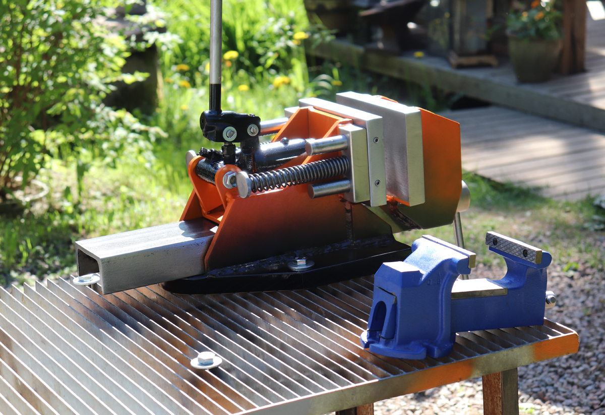

This is my second prototype about vise that can be used with a screw or hydraulic jack.
Attachment 35333

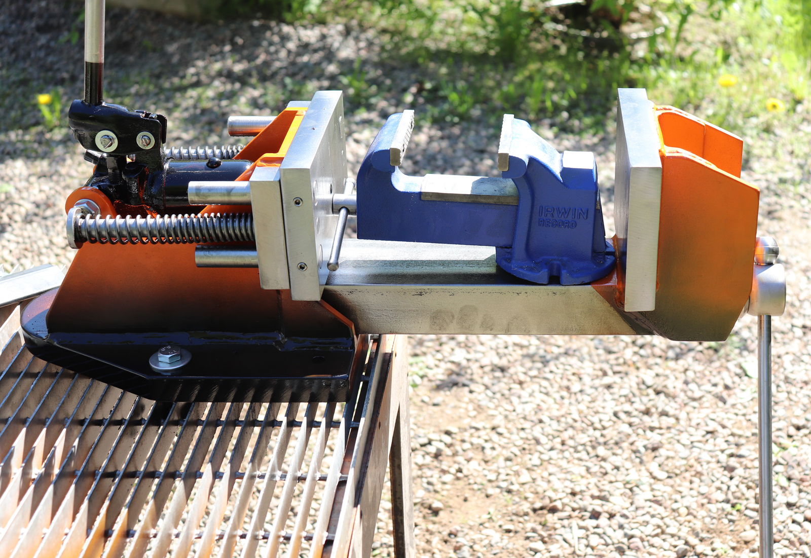

This design gives wider opening than "regular" hydraulic vises.
