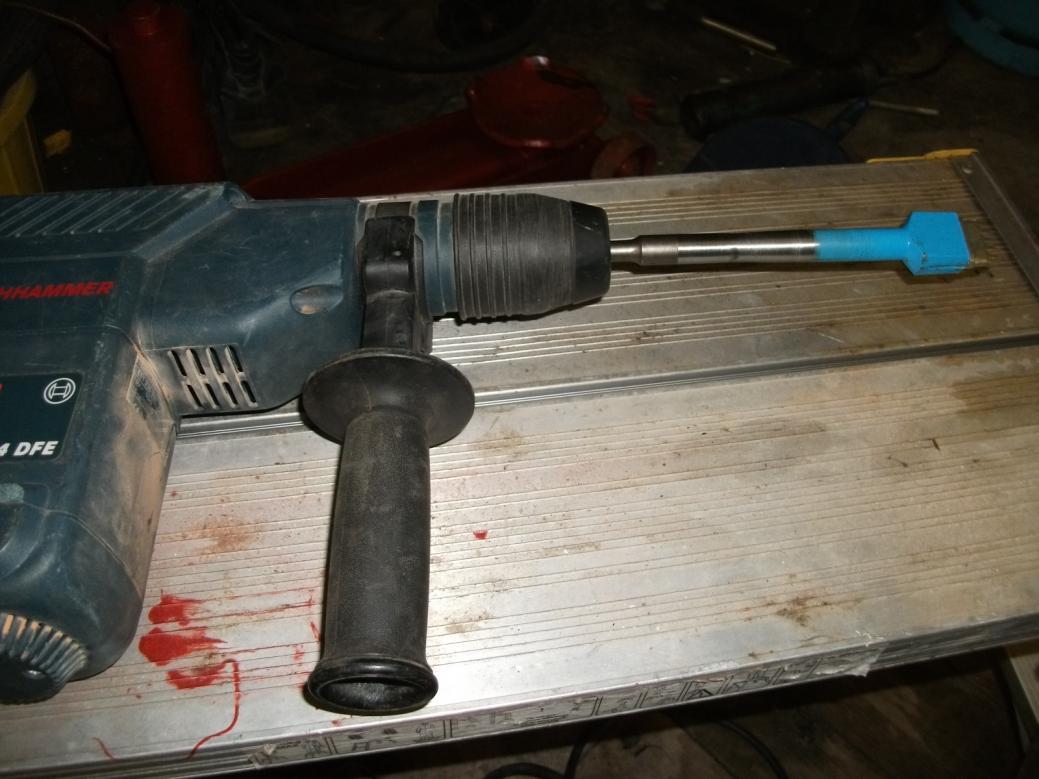

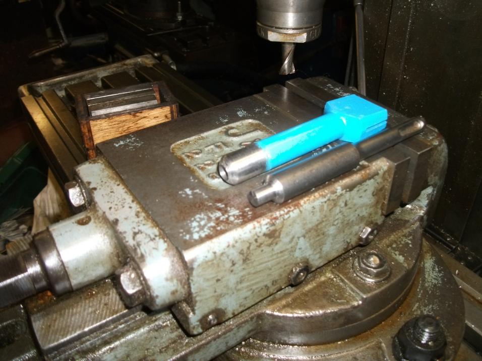

    heres a home made sds scutch chissel. a new one was priced at £30.00 this one cost £2.oo to make its a hand held chissel cut in half and another old sds chissel halved . one side was bored out and tapered the other turned down with spigot and tapered . both welded together and ground down . its tried and tested and works great

    what exactly is an sds skutch chisel?? and what is it used for.

    It's evidently used for rapid removal of materials such as masonry. See here:
    What is a scutch chisel?

    thanks Ken I have one wider thought, I have used it to break concrete but my concrete Hilti tool just has chisel type ends. I like the idea and could see doing the same with mine.
