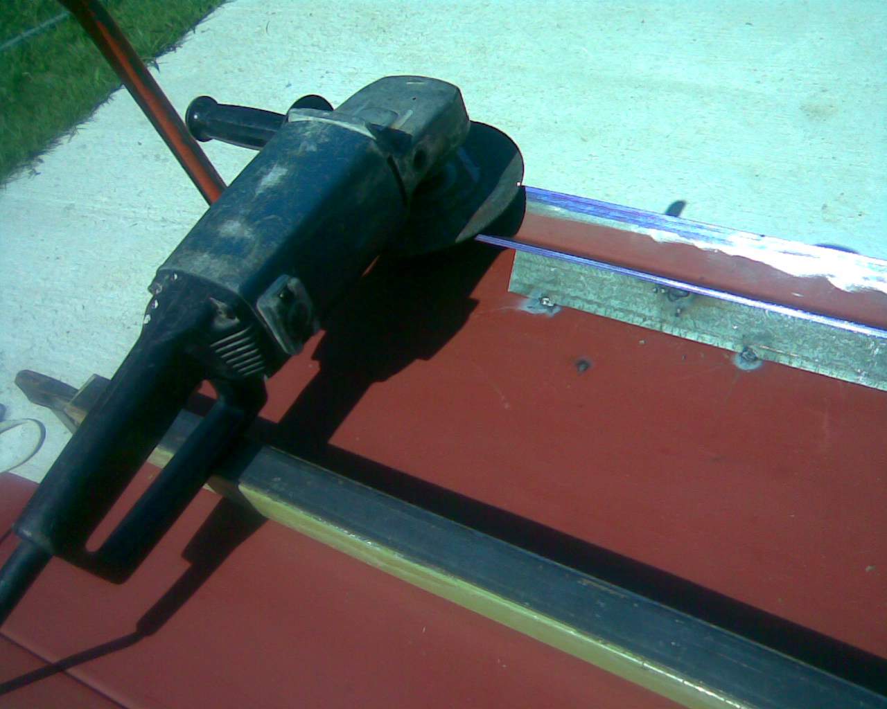

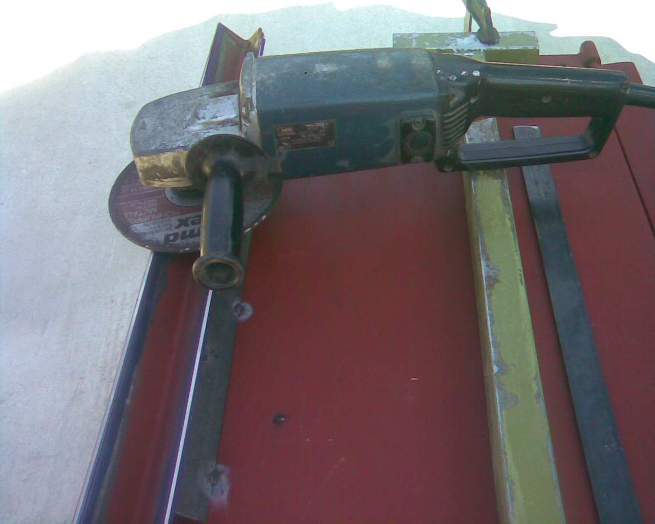

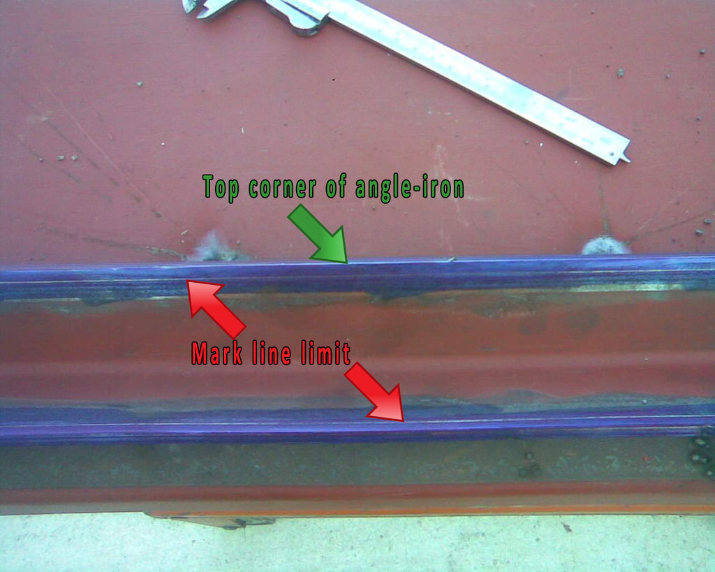

    One more. How did you grind the bending edge
  8. #7
    Supporting Member kess's Avatar
    Dec 2015
    Thessaloniki Greece
    161
    83
    Thanked 341 Times in 89 Posts
    kess's Tools

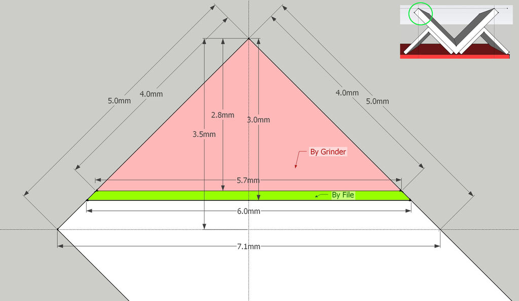

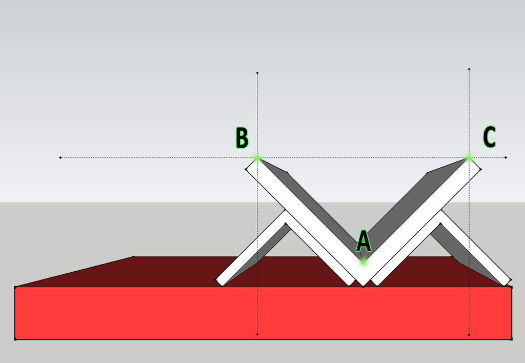

    Hi G.Paul,
    Mount the clamp onto a flat and stable metal surface (I had use my hydraulic portable table) using two pieces of angle-iron (e.g. 30x30mm or 35x35mm.
    Sheetmetal Brake full set plans & materias-4.jpg Sheetmetal Brake full set plans & materias-3.jpg
    Be sure that the hypotenuse (BC) of the triangle (ABC) of your clamp is absolute parallel with the surface of your base and do welds to keep it all in place.
    Clean up the paint or the rust at the inner sides of angle iron about 10-15mm from corner. Paint with Aniline paint and wait for a while to dry.
    Using a caliper or a Vernier, mark a straight line at the entire length on both inner sides at 4mm from the corner.
    (Aniline paint is a very thin paint that used for clean and easy to view marks at metal treatment. You can make it, using 400ml Alcohol, 50ml Shellac, 18~20ml Aniline and very good shake.)
    Place a square tube and lock it with clamps so as to using it as slide-base for grinder.
    Place a flat bar 3mm thick onto the tube.
    According to dimensions of your grinder the height of the slider (tube+flat bar 3mm) must be so as the grinding disk to be absolutely parallel to surface of base and be adjacent to both sides of angle-iron.
    Don’t use a flat bar thicker than 3mm, but you can use a combination of bars one over the other, (the top bar must be the 3mm thick bar).
    The total height of grinding is 3mm but we need to make only 2.8mm leaving the rest 0.2mm for the final sharpening by file.
    So when start the grinding, watch the lines, and be careful, to not exceed the limits.
    The use of a new unused 180mm grinding disk is required for best performance.
    Start grinding sliding the grinder gently from one end to other.
    At starting do not use any pressure on the grinder, let it work with its own weight, and then push it very gently and with the same pressure from one end to other.
    If you are not sure that you can control your pressure just slide and let it to work alone. May be take little more time but we need a very good grinding without gaps.
    After some passes and when the grinding sides, start to have different width or have already grind about 1.5mm of the height, remove the (3mm) flat bar and continue to slide the grinder direct up to the tube.
    According to setup (main base, clamp, and grinder slide-base) the grinding axis is parallel to main base.
    The more grinding, the most offset of the grinding axis to downwards,
    (The center is: at the point that the grinders handle, be adjacent to the slider).
    The side of angle iron that is closer to slider has less grind (or more height) from the far away side.
    But we need 3mm grind at the both sides.
    Removing from the height of slider 3mmt (the flat bar), the grinding axis will move upwards creating an opposite offset that equate the grinding height on both sides.
    When the grinding axis becomes parallel to main base, then the height will be the same at both sides of angle-iron.
    Using a flat file refine the last 0.2mm.
    Regards

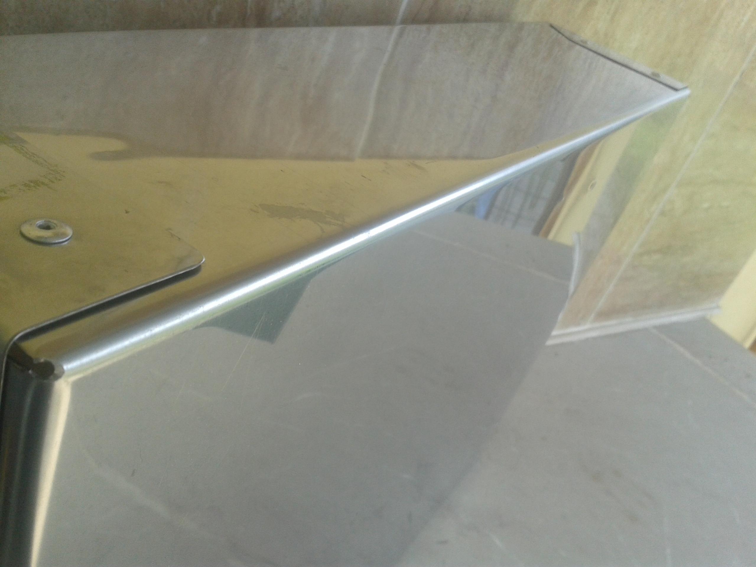

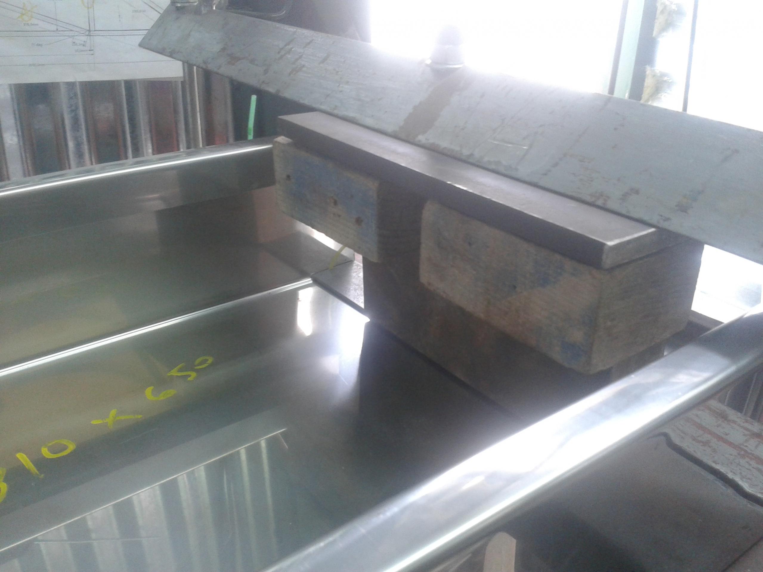

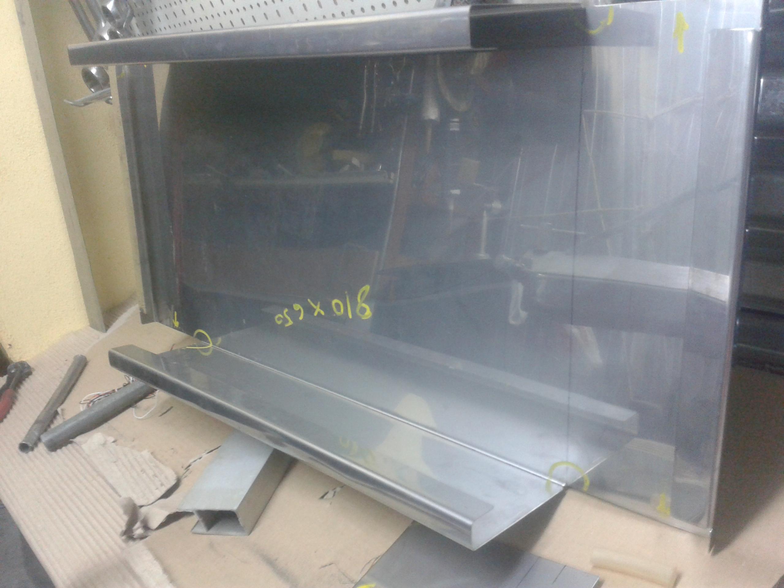

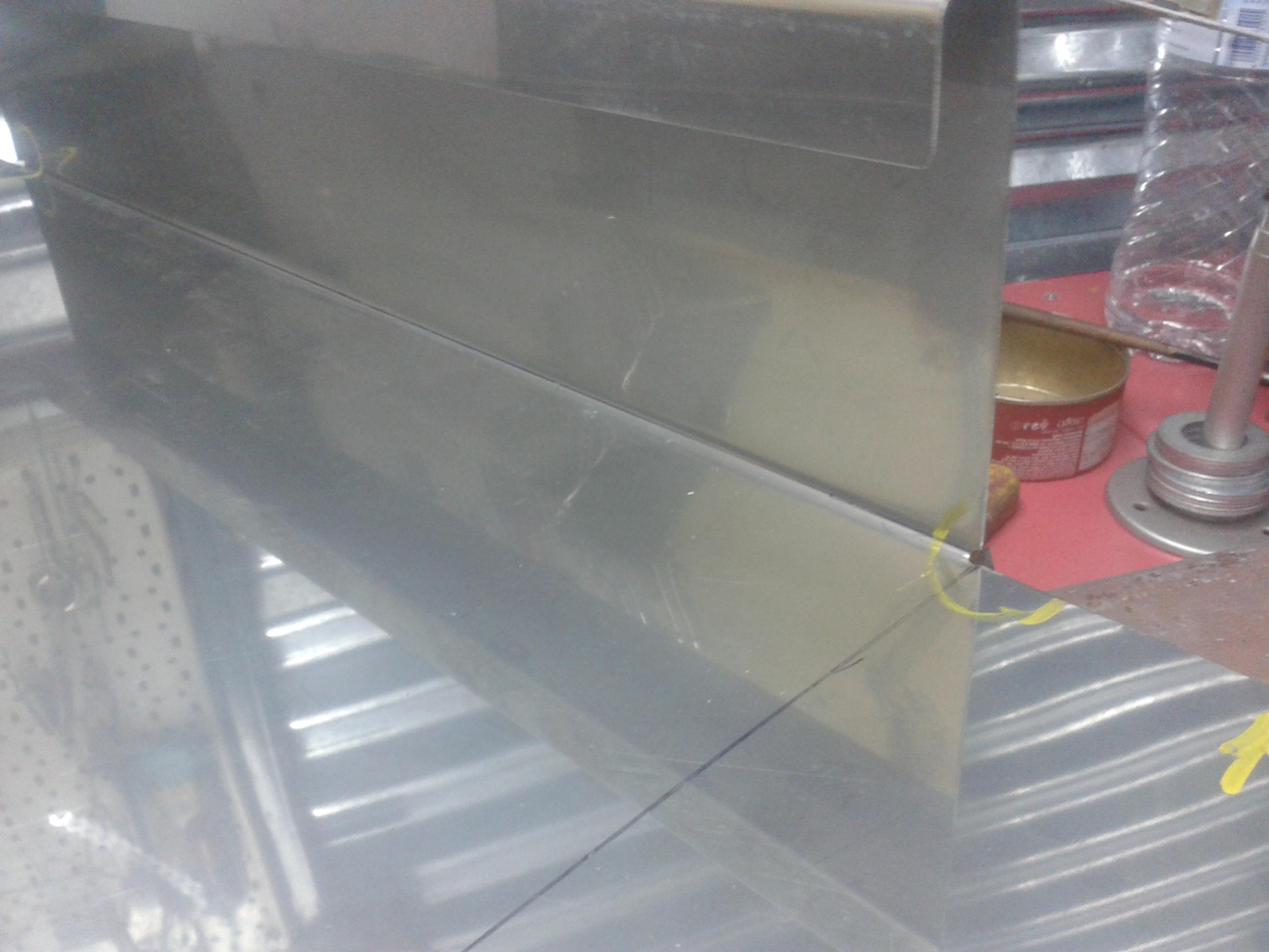

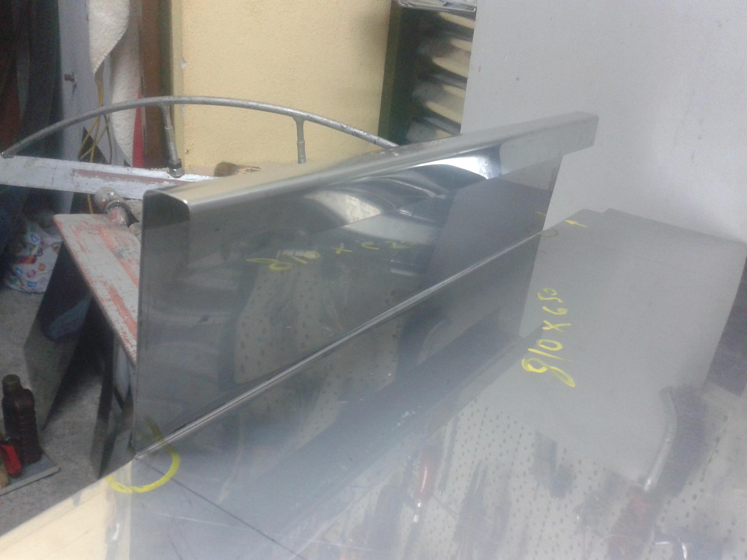

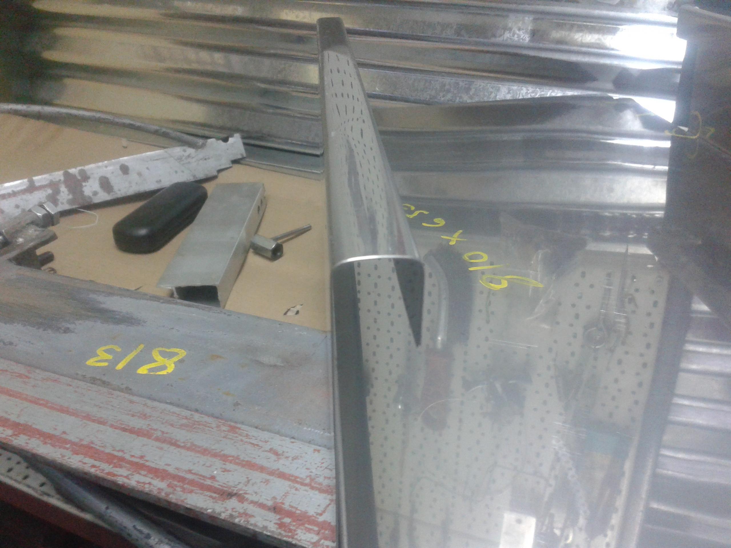

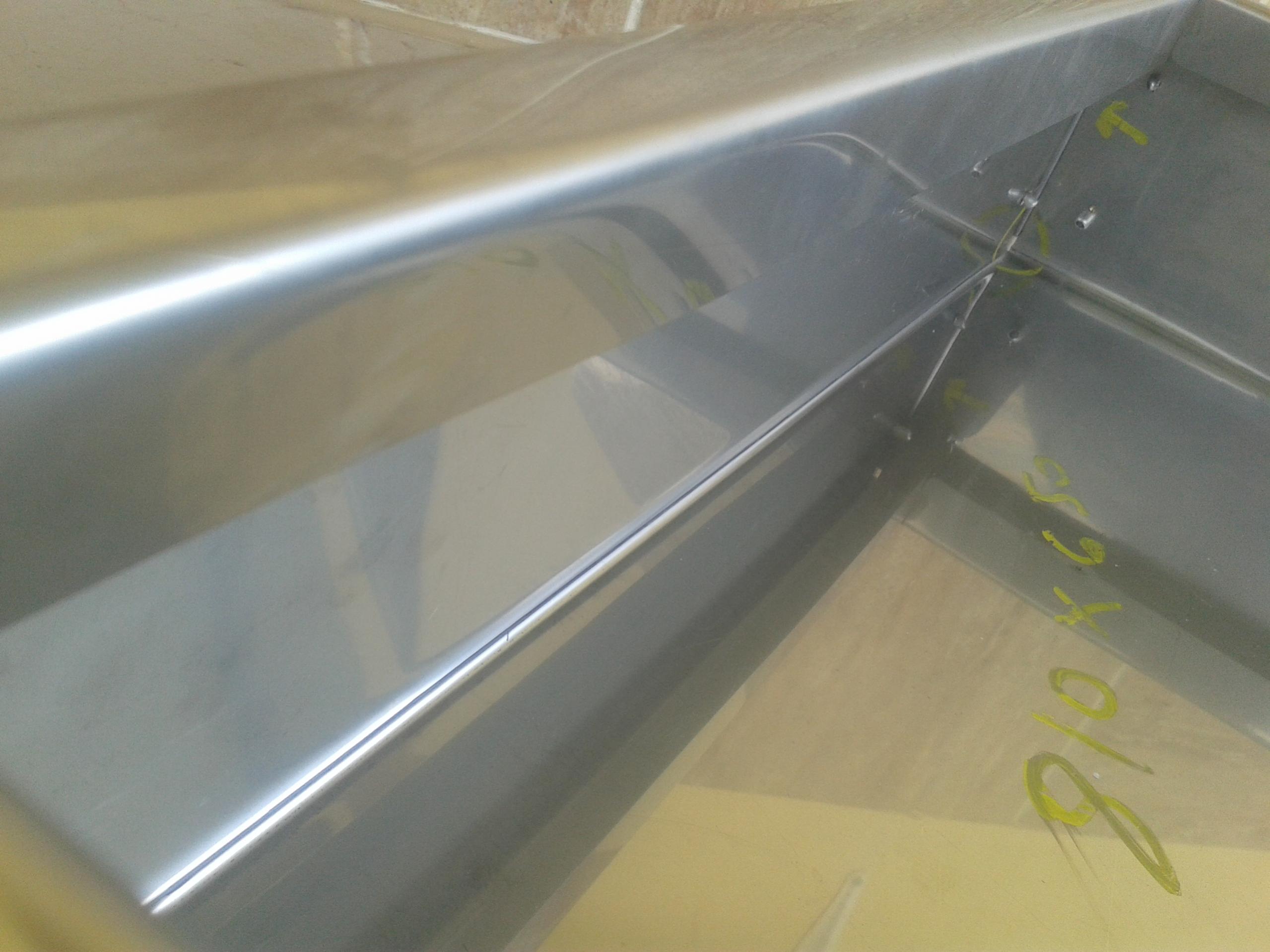

    kess's Tools

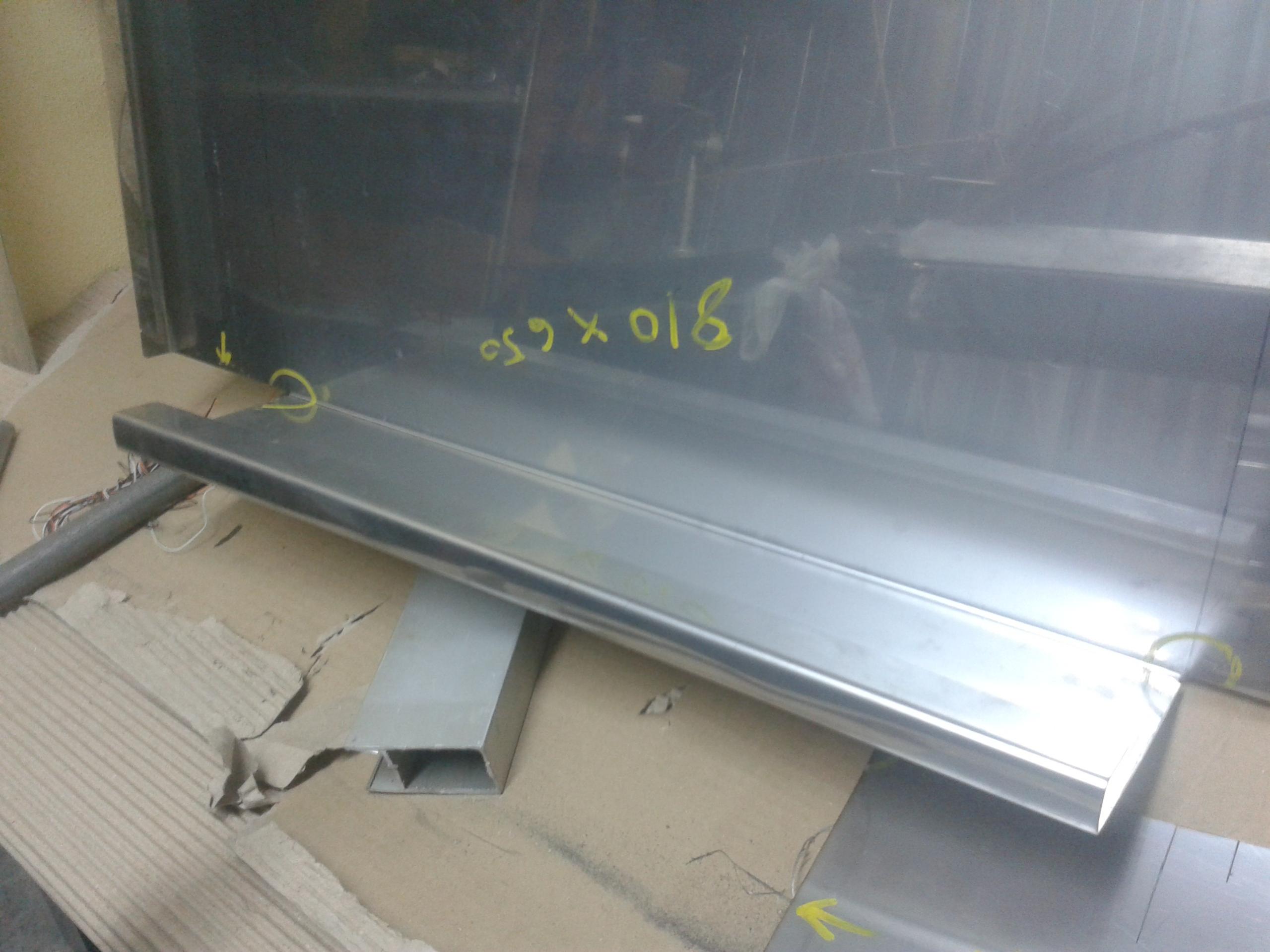

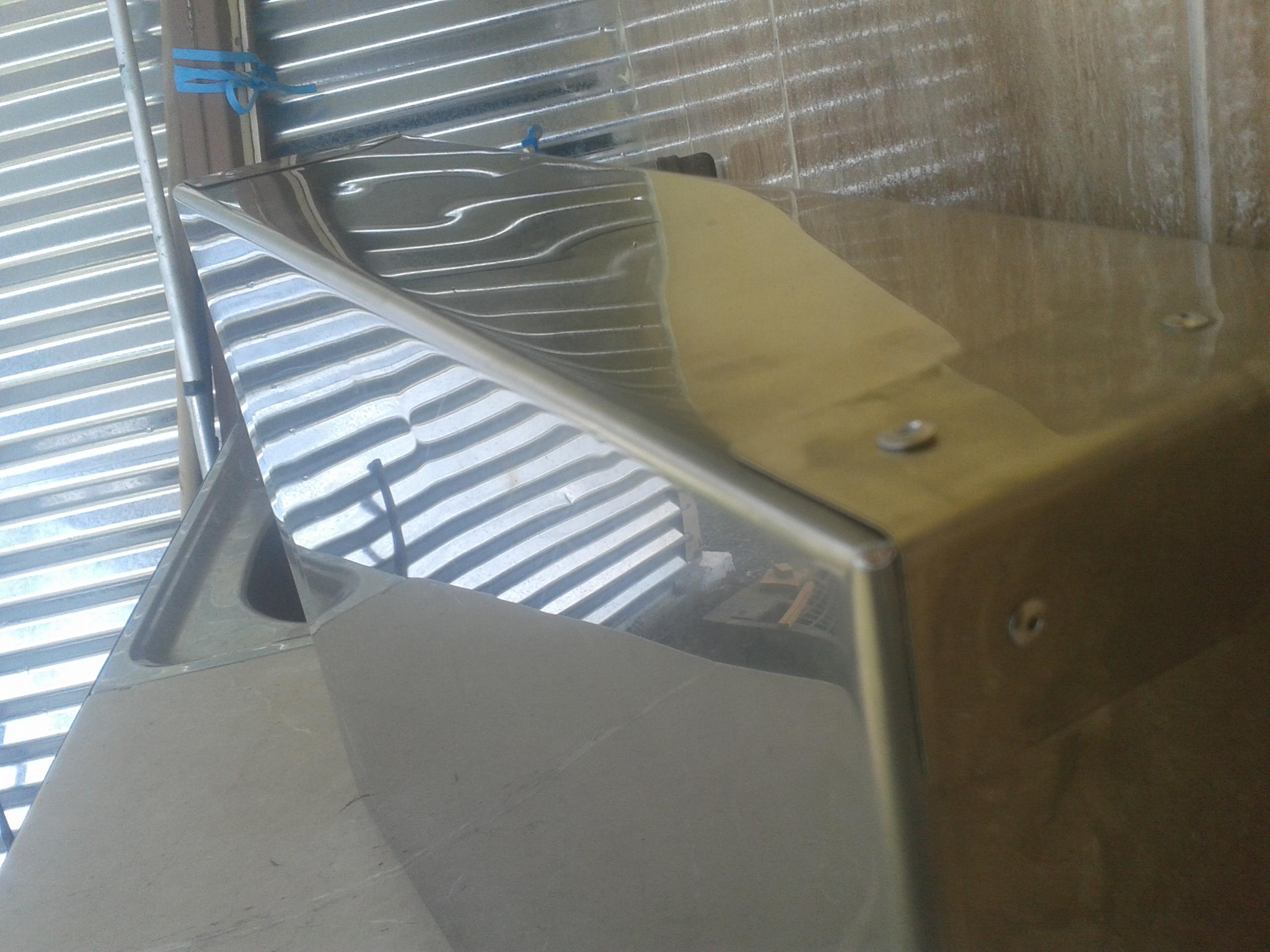

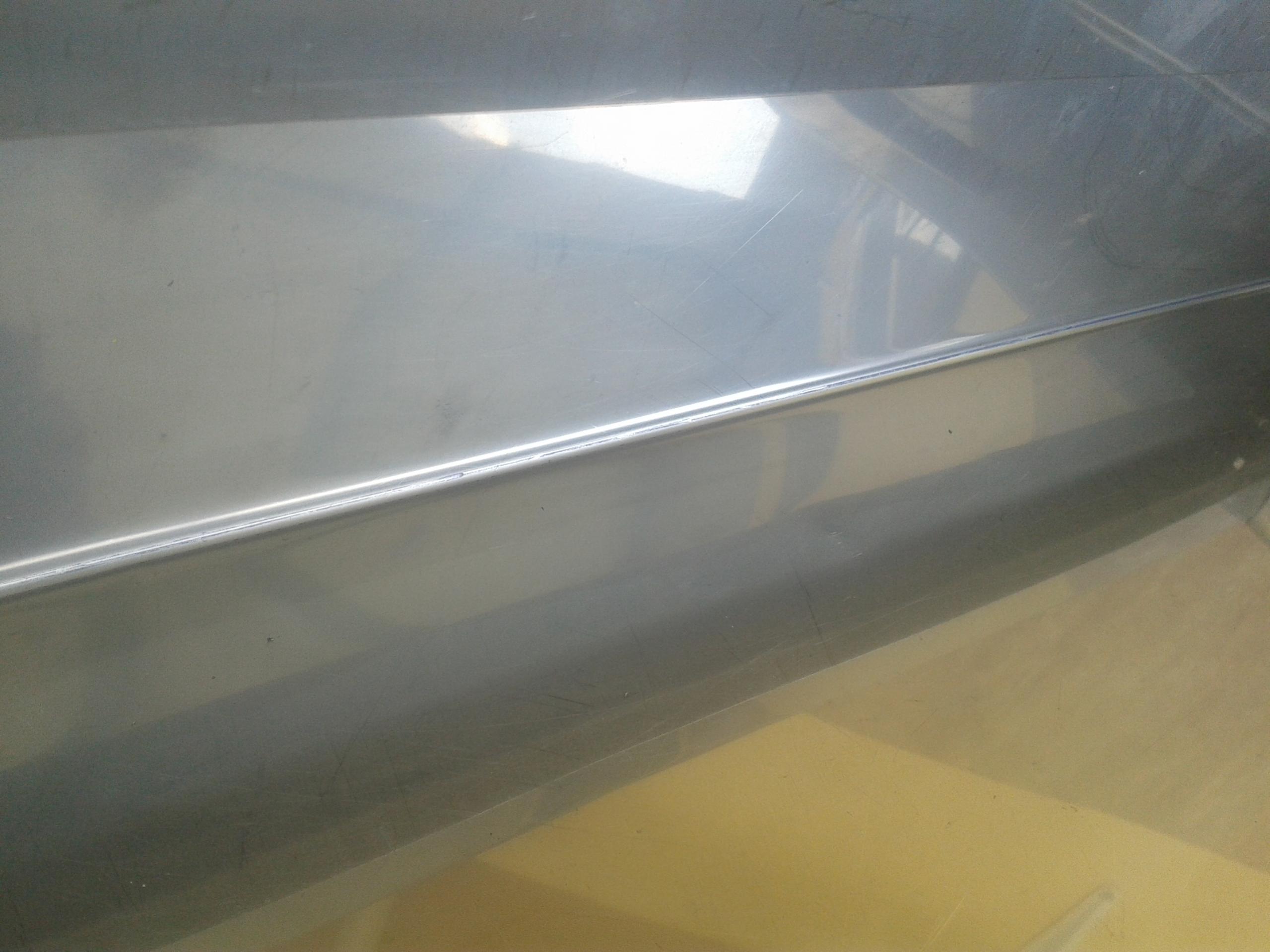

    Quote Originally Posted by kess View Post
    SheetMetal Brake Free full set Plans and materials.
    The basic plan is the same for the simple and the modified version.
    You can view the whole step by step building process at the previus three video parts.
    Part1
    Sheet Metal Bender Brake The Make (DIY) & First Use Stainless Steel BBQ
    Part2
    Sheet Metal Bender Brake Part2 (DIY) Sharpening the Edges of Brake Clamp
    Part3
    Sheet Metal Bender Brake Part3 (DIY) Fully Modified
    These are some photos with bends that have made it by this brake.
    The sheet metal is Stainless steel AISI 304 at 0.70mm thickness.
    Sheetmetal Brake full set plans & materias-20160521_201132.jpg Sheetmetal Brake full set plans & materias-20160521_201228.jpg
    Sheetmetal Brake full set plans & materias-20160521_201251.jpg Sheetmetal Brake full set plans & materias-20160521_211803.jpg
    Sheetmetal Brake full set plans & materias-20160521_211821.jpg Sheetmetal Brake full set plans & materias-20160522_104539.jpg
    Sheetmetal Brake full set plans & materias-20160522_172404.jpg Sheetmetal Brake full set plans & materias-20160522_172425.jpg
    Sheetmetal Brake full set plans & materias-20160522_172439.jpg Sheetmetal Brake full set plans & materias-20160522_172511.jpg
