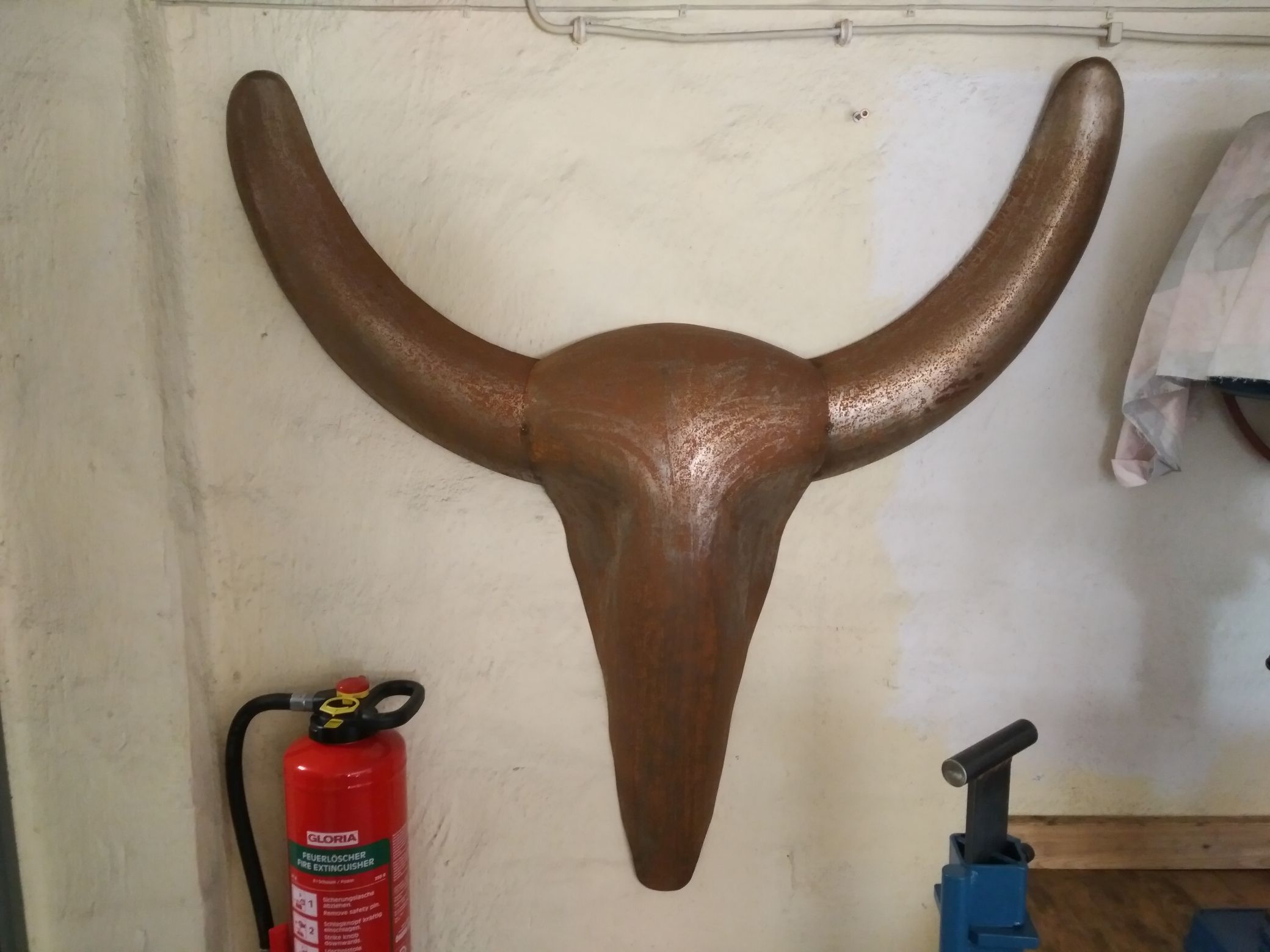

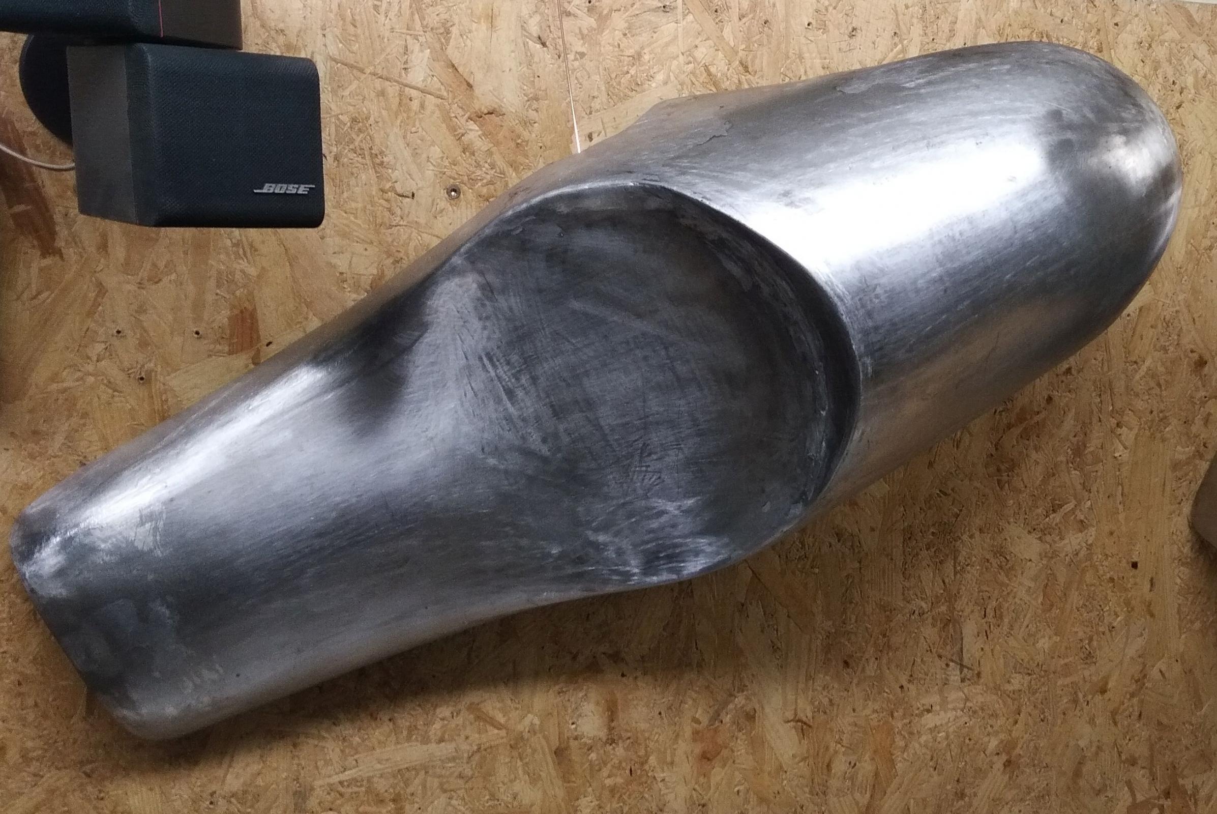

I am mainly using it for bodywork on motorcycles or artwork (see pic)
Cheers
Charst
