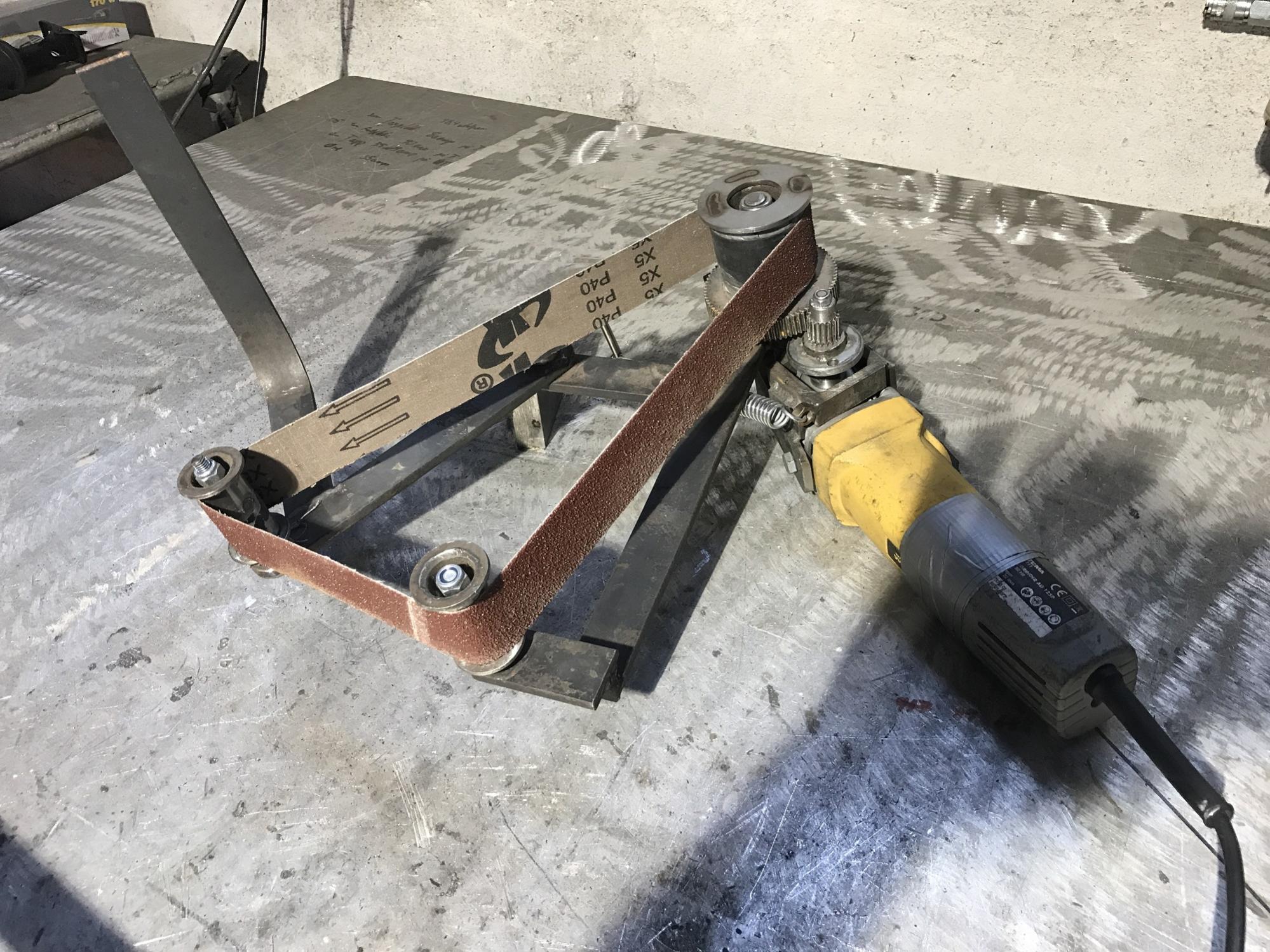

    Quote Originally Posted by stainless stål View Post
    First, I would like to thank you all for your kind comments
    Then:
    I have actually made such a sander for angle grinder a while ago. The speed of an angle grinder is too high so it must be regulated down, as I have done with gears, as you can see in the picture. It works fine so I'll make some safety covers around the gears.
    Simple homemade tools for repairing dents in stainless steel tubes for boat rails.-img_0362.jpg
    Regards
    Olav
    You can use one of those Router Speed Controllers from Harbor Freight (or elsewhere) to regulate the speed of the angle grinder. Those router controllers will turn single speed universal brush motors into variable speed tools. You can even use one on a shop vacuum to decrease suction.

    In lieu of using a small right angle grinder to make one of these pipe sanders a rt angle polisher could be used many come with variable speed and their max RPM is only around 3000 RPM or less
