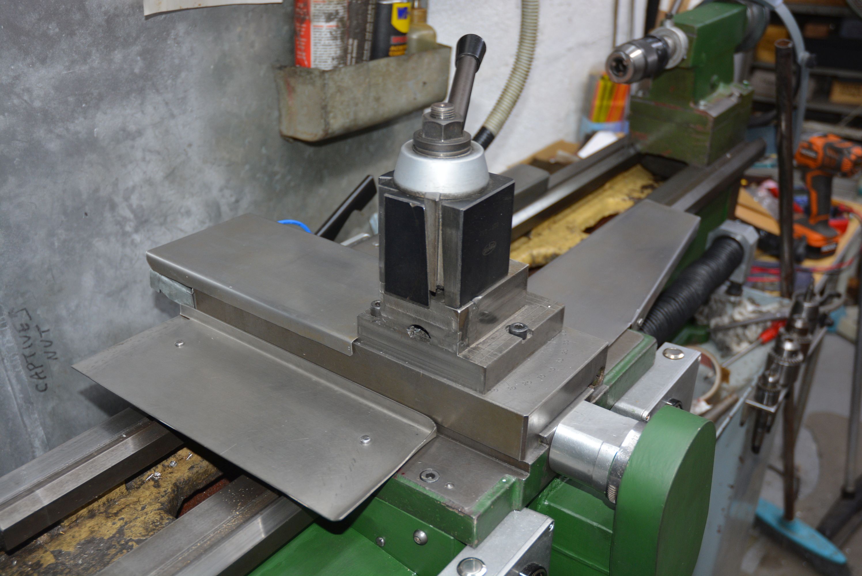

    I no longer have the ability to use this ball turner, since I electrocuted my lathe I have no need for taper or ball mechanical turning devices. My electronic control and software takes care of it all for me. What am I talking about? Look here
    Ball screw and electronic lathe conversion
    So I now use a solid toolpost support without a compound.

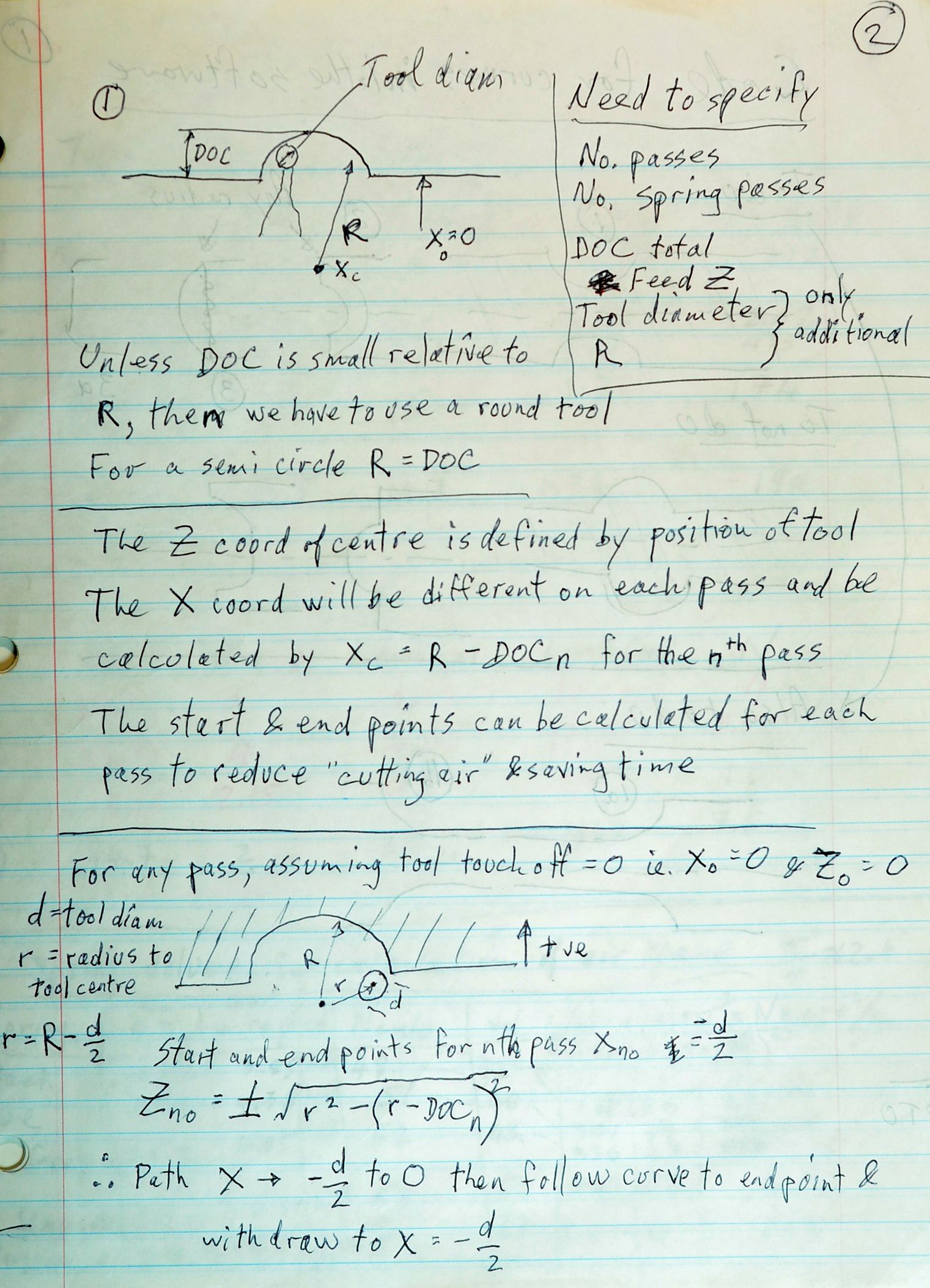

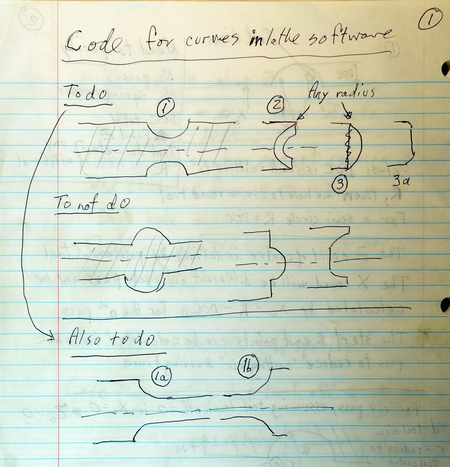

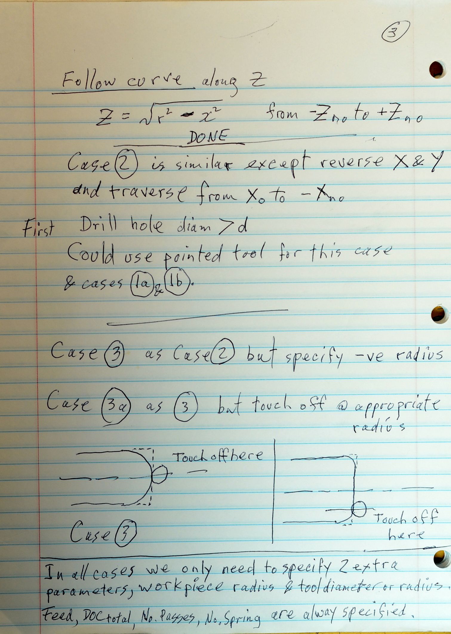

    For the electrocuted lathe
    Single piece, simple ball turner.-curveturn-01.jpg Single piece, simple ball turner.-curveturn-02.jpg Single piece, simple ball turner.-curveturn-03.jpg

    No you are wrong, it doesn't take the fun out of it. It is much more fun using the lathe now.
