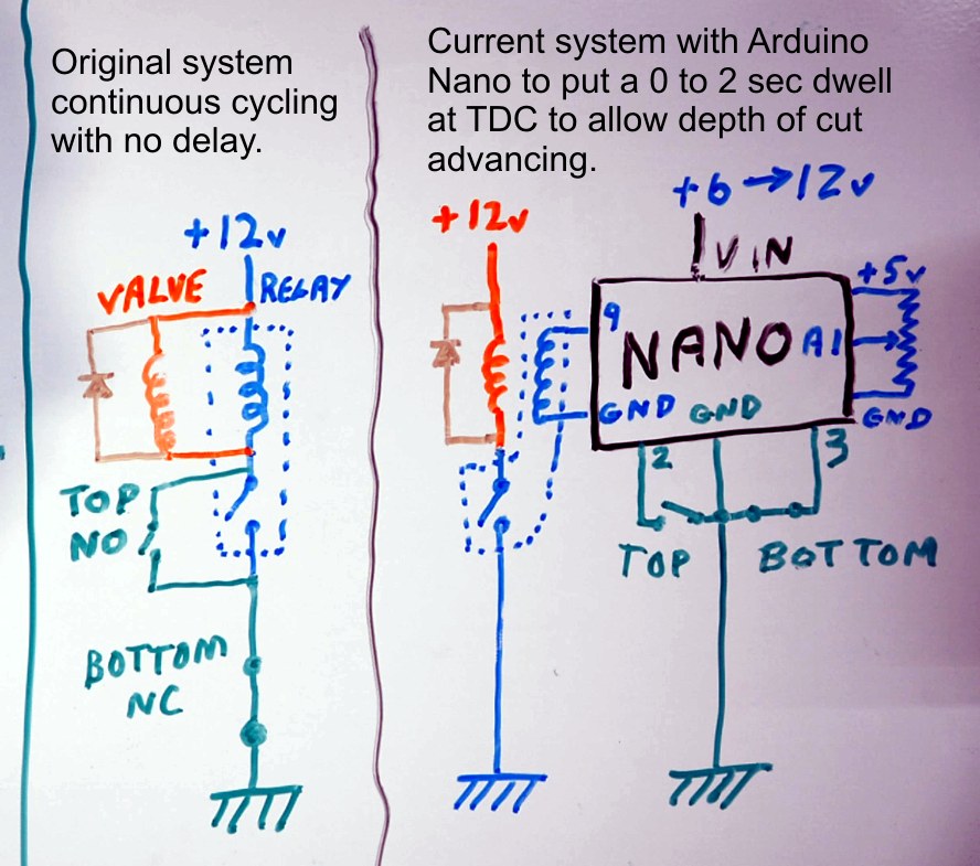

    This post ties up some loose ends and describes the control. Schematics are shown below and the Arduino programme code is shown in the intro comments of this video;
    Here is the schematic for the control, which is fully explained in the video.

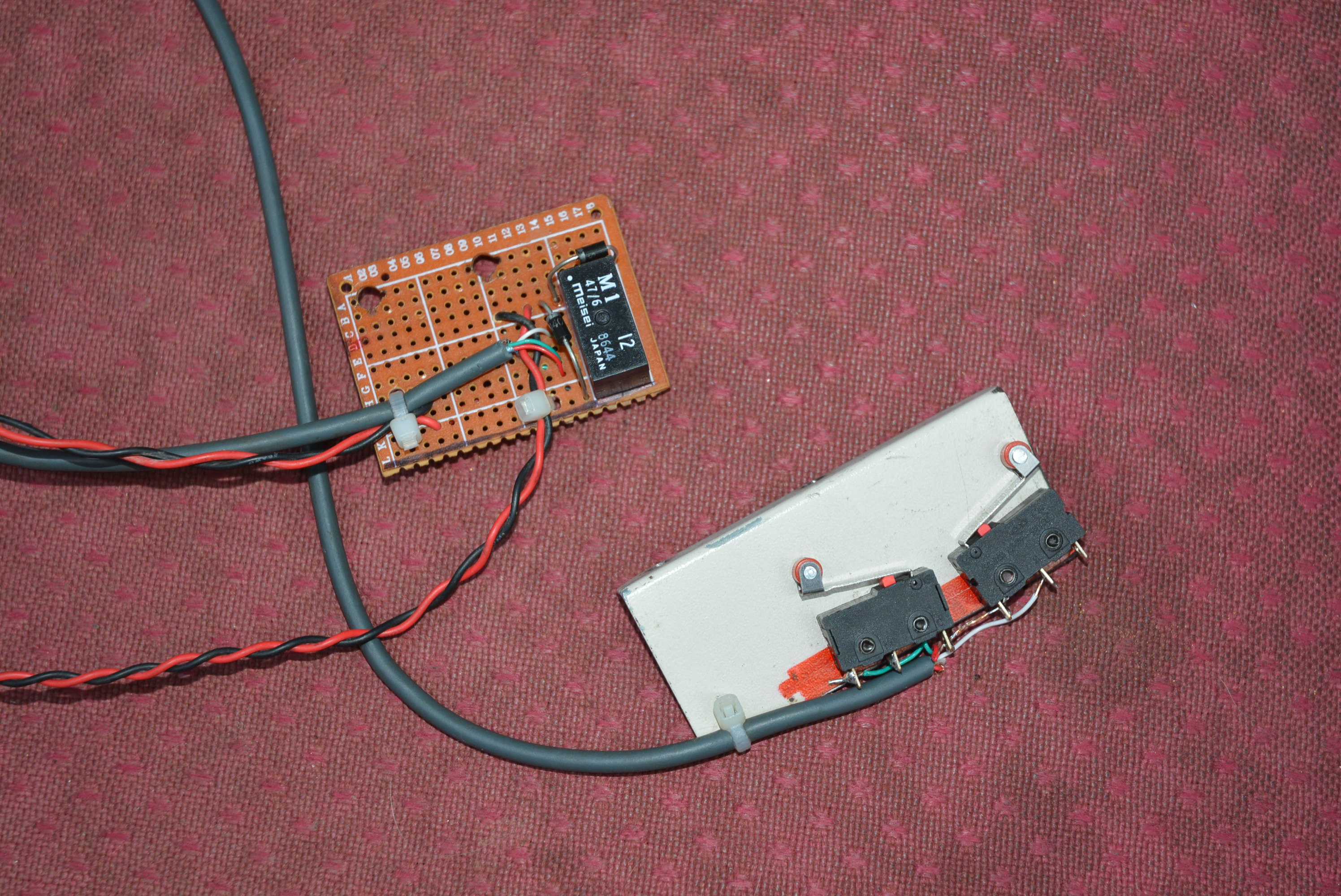

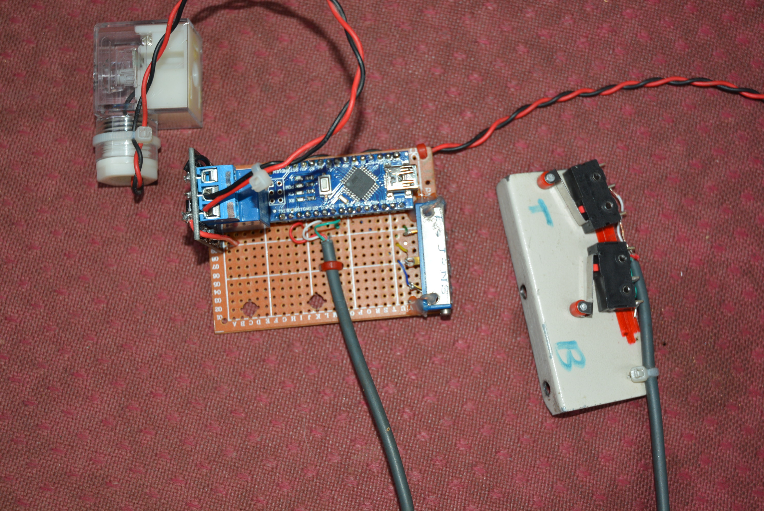

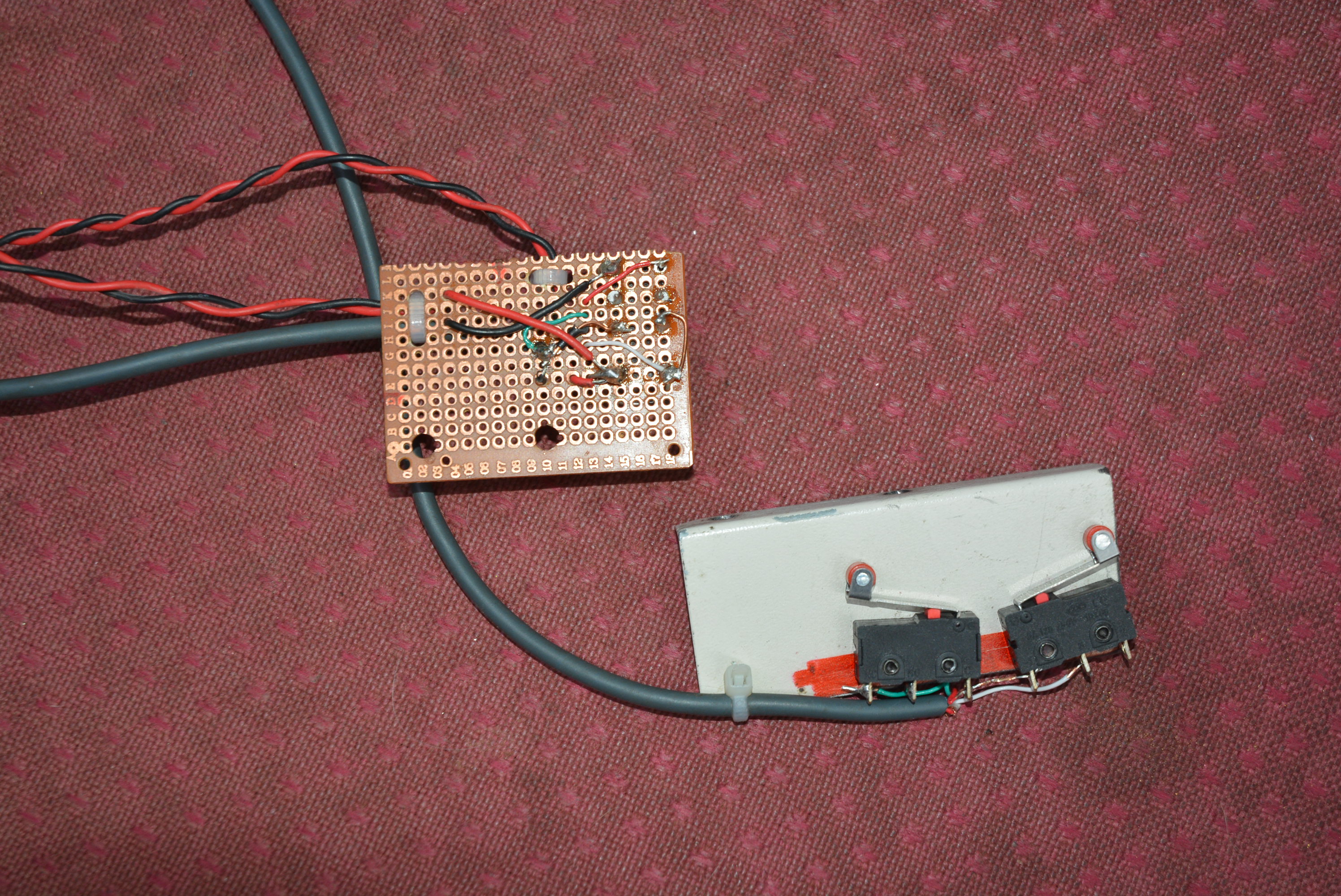

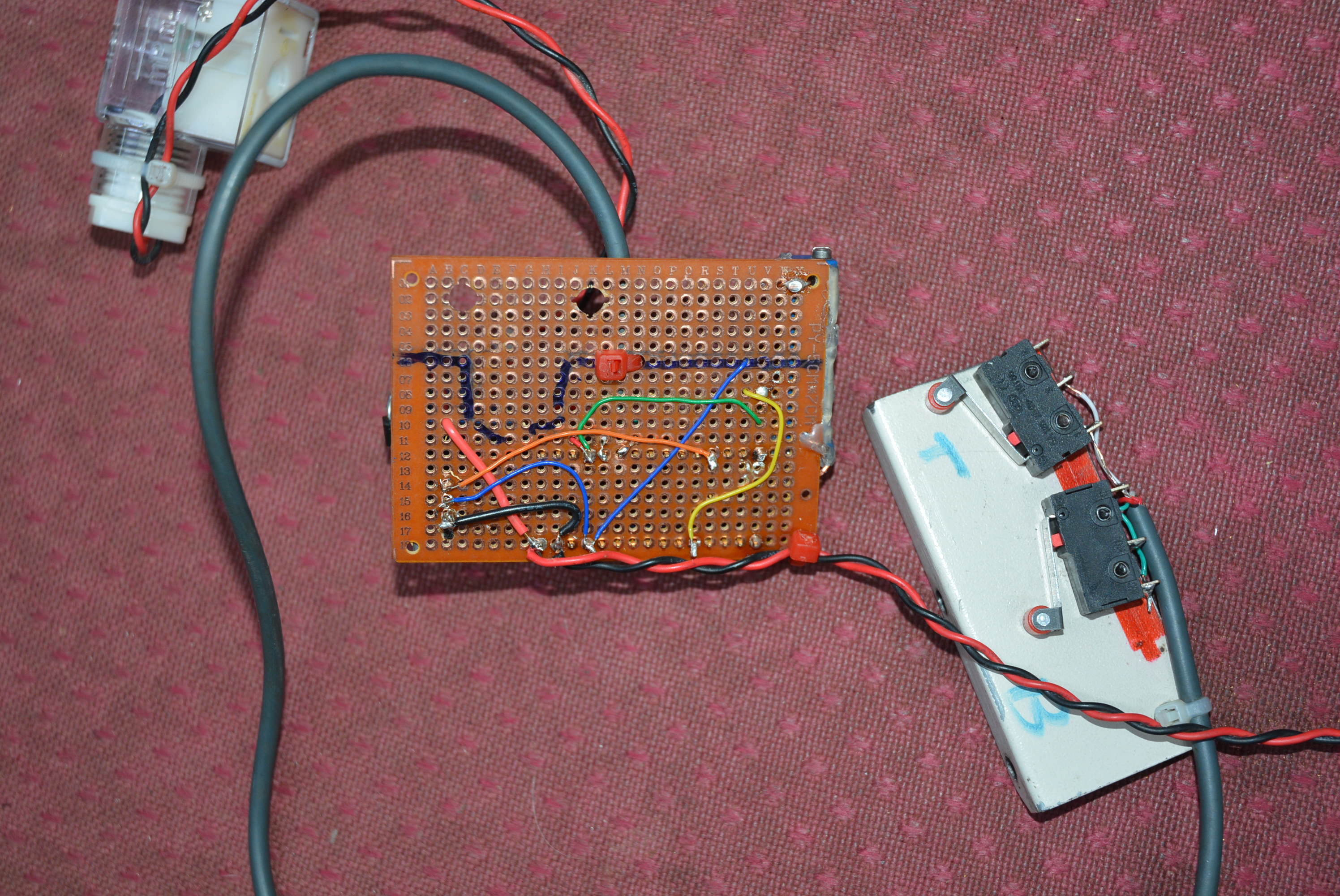

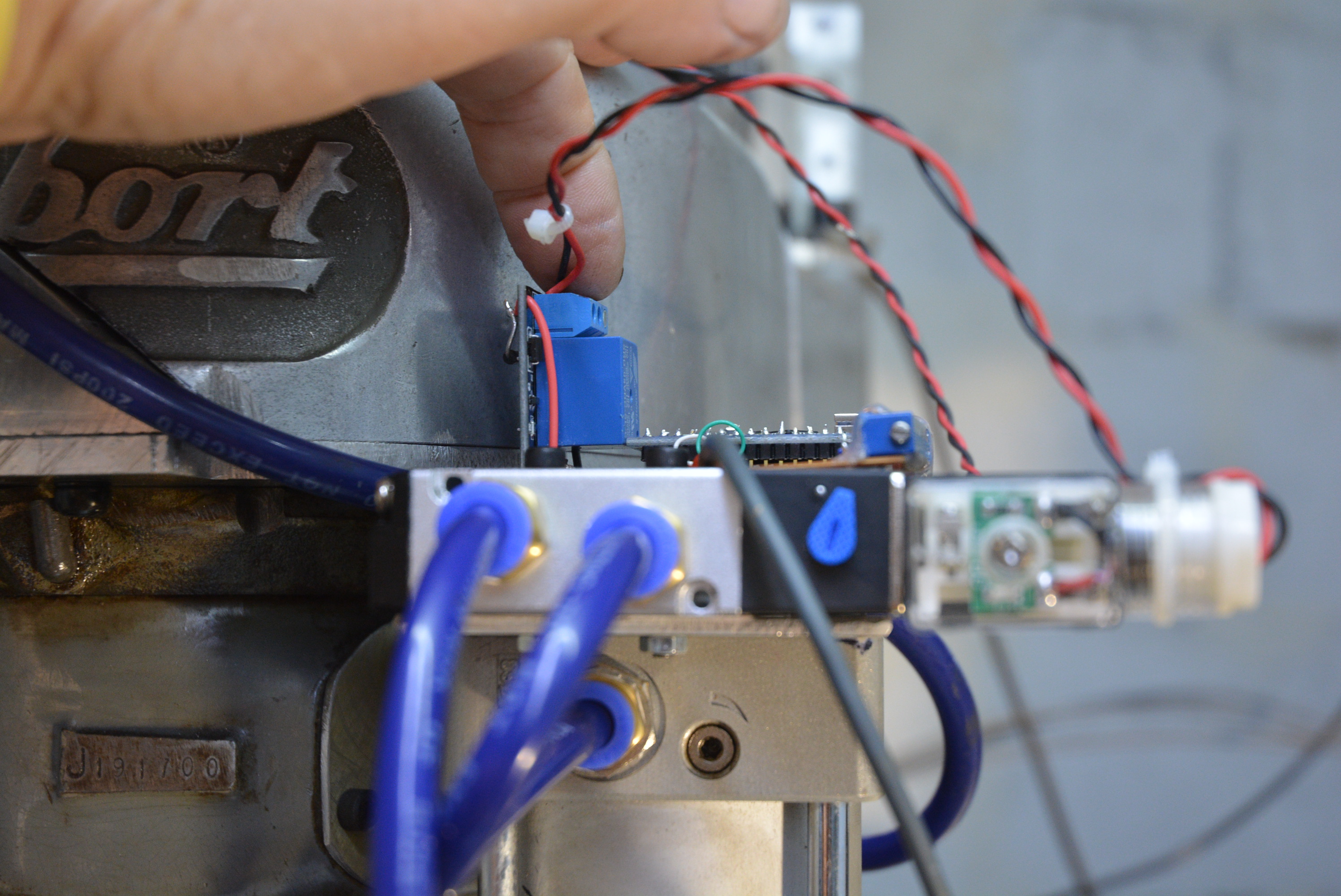

    and some random pix of the Arduino and pre-Arduino boards, which show just how simple it really is.

ID:	39850 Pre-Arduino control.

ID:	39852 Arduino control.

ID:	39853 Control board bolted to top of solenoid valve. Finger points to relay.
