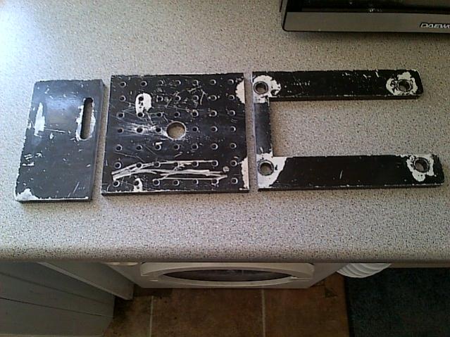

    needed to make up small spacers and was struggling to hold securely so made up clamp plate from some scrap 6mm plate.
    started by cutting piece i needed out then marking out holes at 20mm centres.
    next drilled a 19mm hole in centre followed by drilling and tapping other holes m6.
    now i can clamp small bits to it then clamp plate to drill press tableClick image for larger version.
