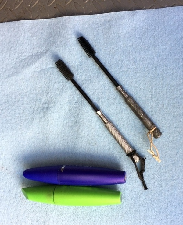

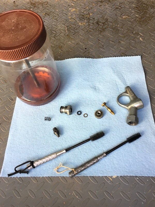

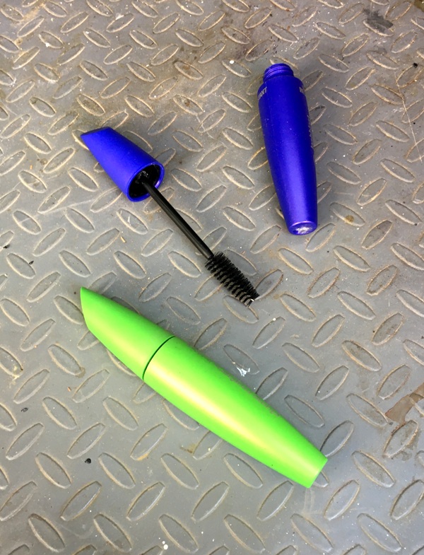

Using old mascara brushes and discarded razor handles, I made these handy tools for the workshop. They are useful for cleaning the interior of small parts.
Attachment 36908
Attachment 36913
Attachment 36910
Regards.

How do you clean the mascara from the brushes?

Great point, sossol. I use these as well, had not thought of improving the handle.
Neil, I just wash them in warm water with dawn dish detergent.
There exist tiny brushes made for cleaning between teeth - a substitute for dental floss. They have the advantage of not having to be cleaned prior to use in the shop. Chain drugstores have them or they're available from Amazon...

For something a bit more durable, go to the sporting goods store and get some rifle bore brushes...

run them through your eyebrows. LOLOn a serious side I really like this idea and immediately started thinking about bore brushes which could use nicely machined handles. This is certainly one of those ideas that falls into the category of "why didn't I think of that". Which is also why this web site is so great, hundreds of good ideas every week (even if you don't use them) keeps the mind primed when you need to solve a problem.
Don't overlook the shotgun swabs. I use them to clean Morse taper bores, e.g. tailstock) because they seem to have a magnetic attraction for swarf, much as Swiffer products do for dust, but I'm sure there are other cleaning applications that could benefit from their use.

I like this idea and will make some. But I have a stash of small brushes of varying sizes bought at Japanese stores. These stores always have assortment of brushes. Course all mine were bought in a dollar store kind of place though not a dollar store that carries all kinds of stuff. This store is at what I call japan town in San francisco. They have reasonable long twisted wire handles.
