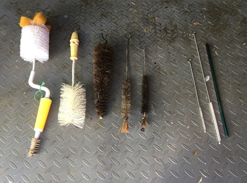

Of course I have a collection of commercial brushes, but let's not forget that the essence of this forum is about what you can make at home.
Attachment 36940
Well, many times it includes repurposing. I needed a very small wire brush that was at the end of a handle. Could not find anything. Then while doing something else the idea popped into my head. So I pulled out a bunch of wire out of those cheap wire brushes. Then I stuck it into the end of those acid brushes and crimped it down hard to hold the wires in. I thought I would have to solder them in but so far so good. And has served its purpose well.
