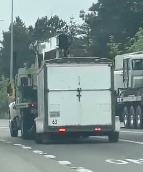

    Wow! The trailer brakes worked. Something I have never seen...

    It appears the backup safety chains were utilized.

    Battery backup is working fine; taillights are still functioning

    Quote Originally Posted by gatz View Post
    As I see it;
    Tail lights are still functioning because the pigtail is still plugged into the truck. On all of the trailers
    I have ever worked on, the battery is for brake activation only. When the trailer finally broke totally
    free of the truck, the pigtail pulled out or broke and the lightes went dead. Then brake safety cable
    pulled the pin on the trailers emergency brake switch.
    What truck?
    The truck the WAS pulling the trailer.

    Or in the case of surge brakes, a cable pulled on the master cylinder and locked it on...
