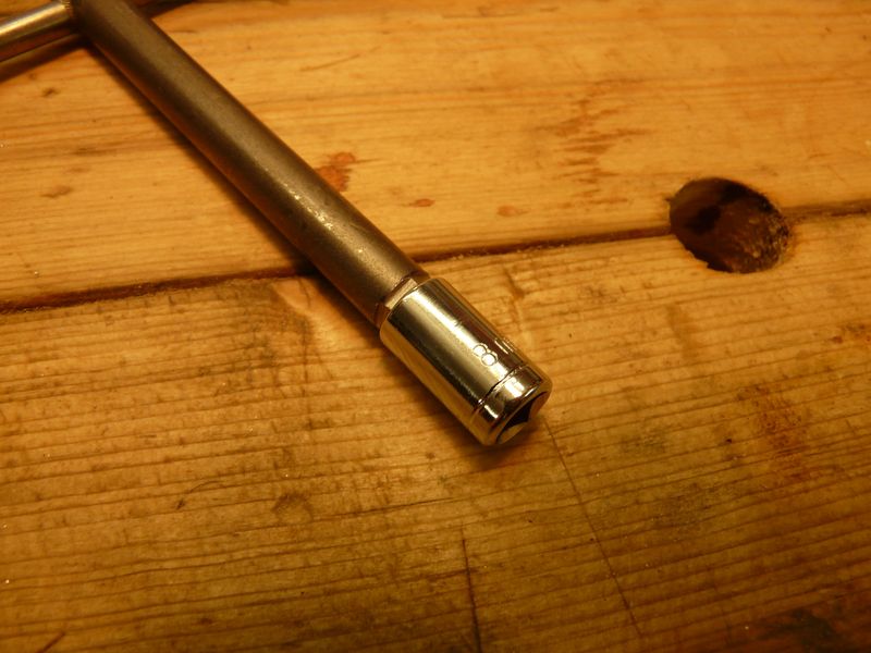

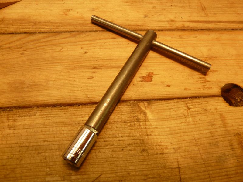

    Hi folks,
    This is a homemade T wrench made for handling 6.35 mm / 1/4" square nuts or square screw heads.
    The tip is quite paradoxal, actually I used a reversed hex socket, I milled an hex shape on the shaft and inserted the socket tight, so that I can use the square end of the socket.
    Attached Thumbnails Attached Thumbnails T wrench for square nut-carre_femelle_01.jpg
    Cheers !
    Christophe
