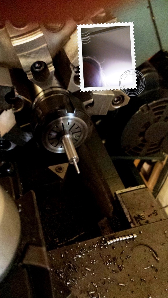

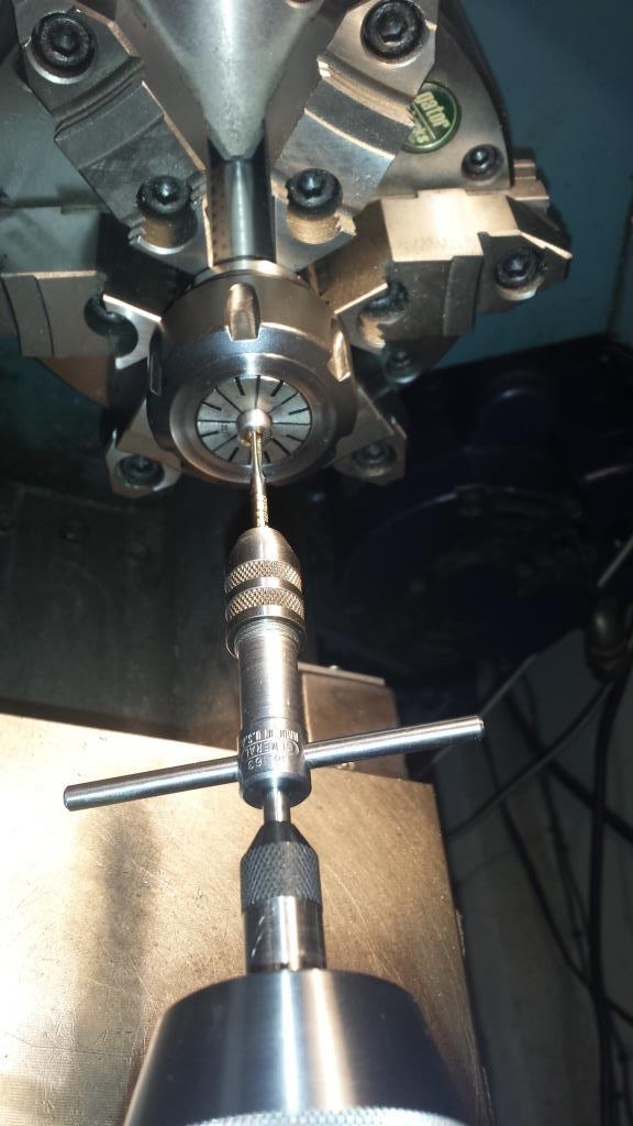

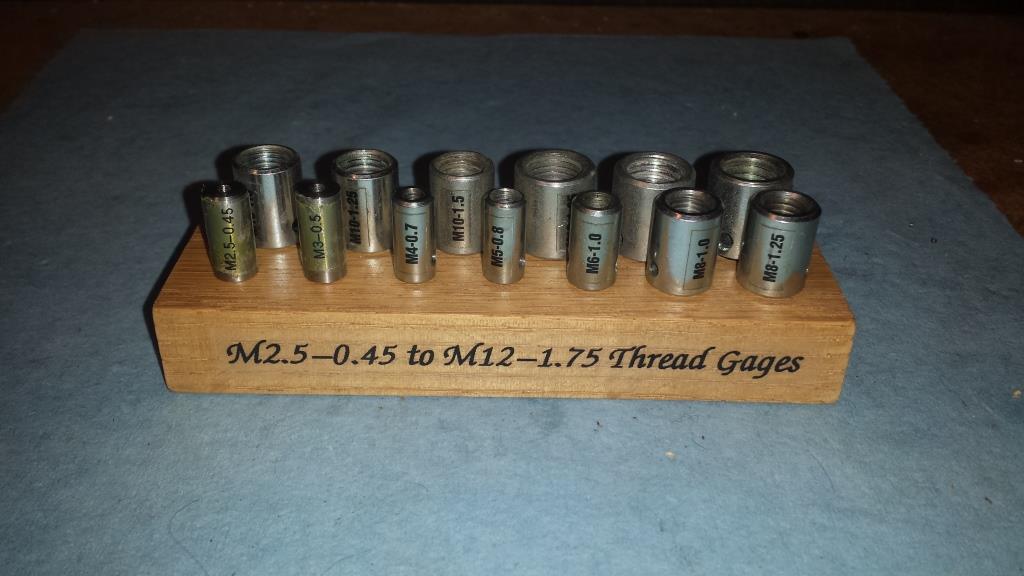

    I finally finished my metric thread identification caddy. I didn't have the M2.5-0.45 and the M3-0.5 gages and made these from 12L14 steel.
    The machining was very easy using taps and dies to make the thread gages.
    Thread Identifier Caddy-machining-new-m2.5-0.45-thread-gage.jpg Thread Identifier Caddy-creating-2.5-mm-thread-gage.jpg

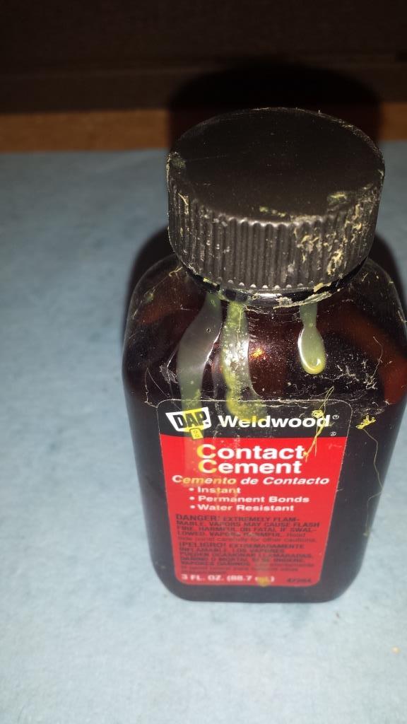

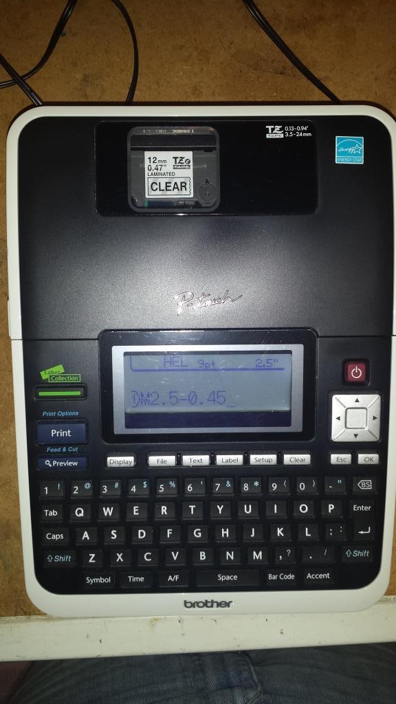

    I used a P-Touch labeller for thread gage ID but had to use contact cement to permanently attach the clear labels.
    Thread Identifier Caddy-p-touch-label-maker.jpg Thread Identifier Caddy-extra-contact-cement-glue-p-touch-labels.jpg

    Whenever I buy a new tap/die set (I usually buy the two together), I use them to make a screw and nut sample to keep in the pill bottle with the tap/die. This provides me gauges for testing threads produced later with the tools as well as identifiers for unknown threads. I thoroughly recommend this habit.
    Despite having both inferial and metric thread checkers, for some reason it never occurred to me to make the sample as a single piece and mount them in a holder for ready reference. I must train myself to do that in the future.

    I was taken by surprise during my simple addition of making the M2.5-0.45 and M3-0.5 thread gages when I discovered the die diameters for cutting the treads were 20 mm and not 13/16" in diameters. I bought the dies years ago and never thought to check the diameters until I started using them. I do not have any die stocks or a lathe die stock for the 20 mm diameter dies.
    I made a simple 20 mm ID sleeve with three pass-through screw holding holes for holding the dies in a 1" (25.4 mm) tailstock die holder. I will publish at HMT the very simply but useful selve for accommodating the smaller 20 mm die diameters.
