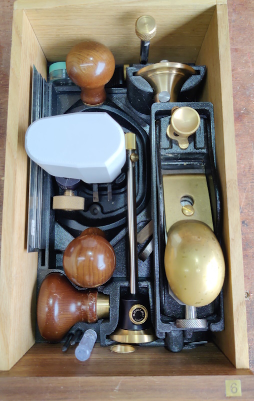

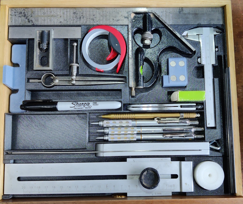

Since I originally posted the tool chest on here, I've 3D-printed drawer liners for all the drawers to hold the tools that I want to take with me when travelling and to stop them knocking against each other and damaging sharp edges etc. There are a couple of photos below; to see all the drawer liners and read about the process of designing them, have a look in the tool chest build log on my website (the bit about the drawer liners starts on page 126 of the build).

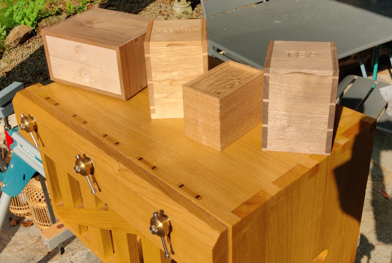

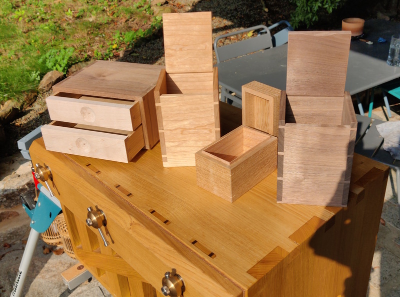

During the holiday, I made four boxes which you can see in the next two images:
Attachment 47902
Attachment 47903
They were all made using the hand tools I took with me on holiday (although the timber had been resawn on the bandsaw prior to the trip). The two similar looking boxes are tea caddies (for storing loose-leaf tea). One is American Black Walnut (ABW) and the other is Cherry.
The smallest box is made of English Oak. It has mitred and splined corners; the splines (and the liner) are Red Oak. The main reason I made that box was to test the mitre shooting capabilities of the chest's shooting board (which worked really well).
The final box has two drawers. It's not quite finished as I need to turn a couple of knobs out of ABW (which needs my home-made lathe, which unsurprisingly I didn't take on holiday with me)! The body is ABW; the drawer fronts and the back of the body are Maple and the drawer sides and base are Sweet Chestnut.

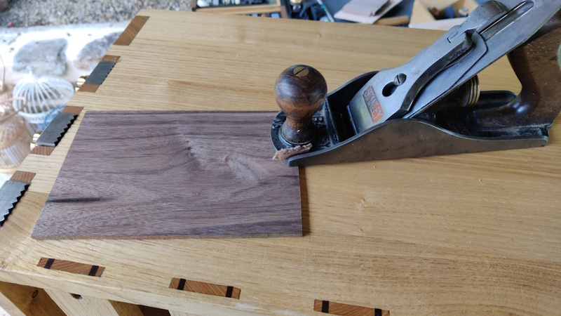

Planing a bit of ABW:
Attachment 47904

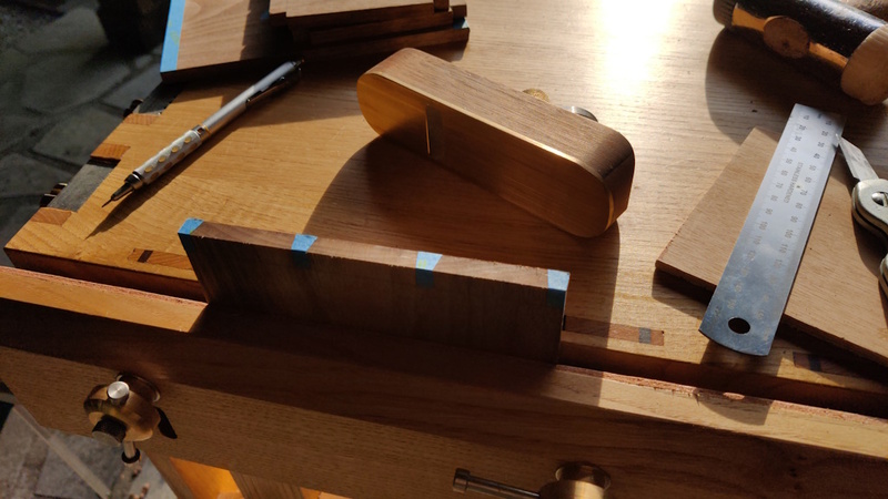

Using the vice to mark out and cut tail sockets for dovetail joints:
Attachment 47905

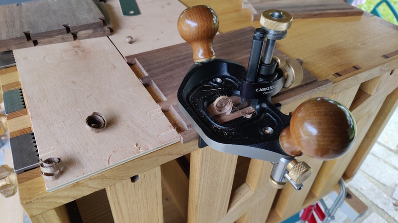

Ploughing a groove with the router plane:
Attachment 47906

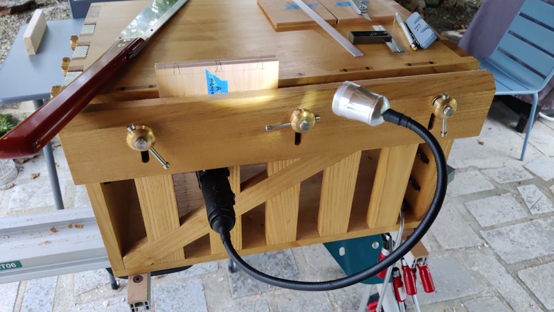

A lamp clamped onto the back to help with visibility on a rather overcast day:
Attachment 47907

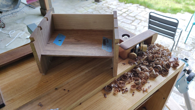

Adjusting and fitting the inner shelf of the drawer box:
Attachment 47908

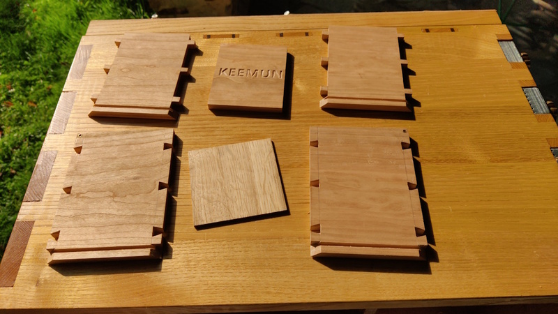

All the pieces of one of the tea caddies ready for assembly:
Attachment 47909

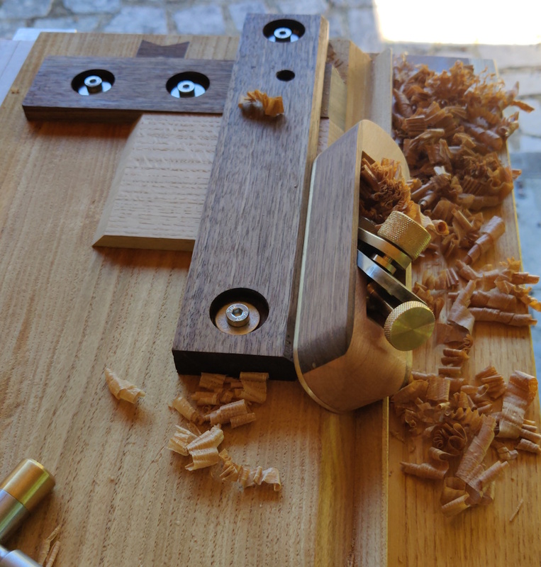

Using my home-made block plane with the mitre shooting feature of the shooting plane, when making the small oak box:
Attachment 47910
