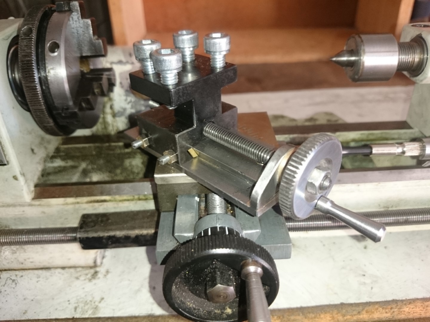

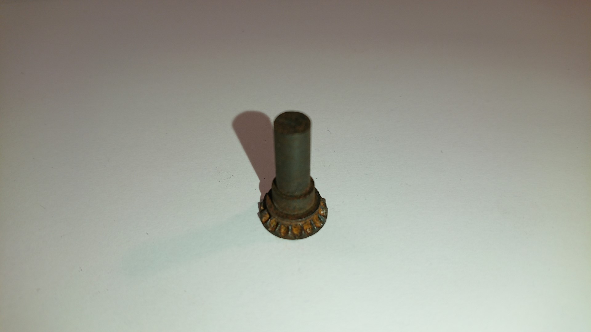

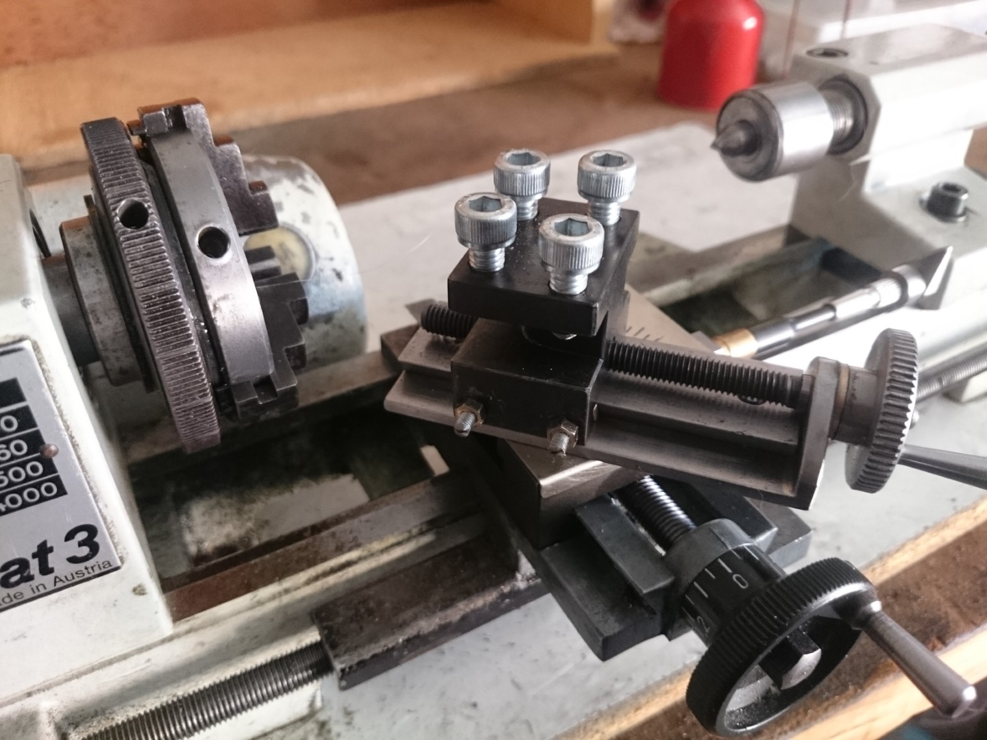

    Once upon a time... I owned a Unimat 3. I made all sorts of knife components, pommels, guards, threaded rods and folding knife locking devices. I even made a heavy duty cutter assembly for a small manual pantograph to cut inlays and a puzzle Cryptex for my daughter's 21st. The poor little Unimat was often thrashed beyond intended limits and a cordless drill supplied a makeshift power feed. Annoyed to change the angle on the compound by winding the slide back to access the nut as we do on most modern mini lathes I made this new compound for it. Didn't have a mill back then so the task was quite laborious with hand tools. Hard to see in the pictures but just to the right you can just make out a part of an el cheepo watchmakers screwdriver with a lever on the end. This was attached to a pinion which turned a cog underneath the compound. The other pic is a failed attempt to cut a cog via the engraving machine, the final cog had a thread and was O1 tool steel.
