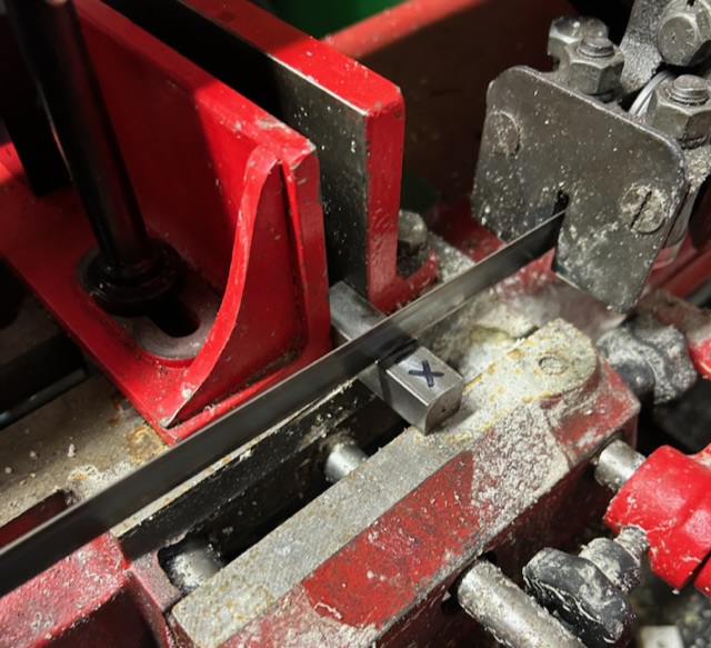

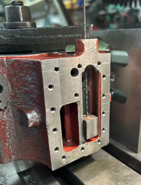

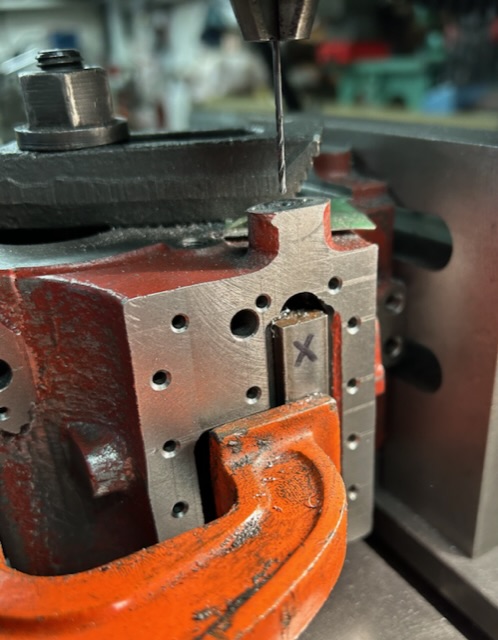

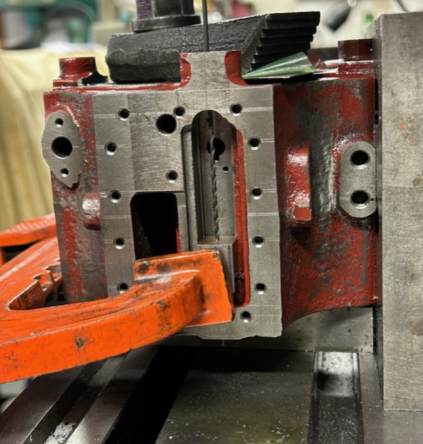

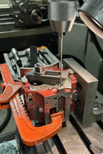

The casting was first marked out and clamped to the mill table and angle plate. The spindle aligned over the required position for the hole. Centre drilled and drilled with a standard 3/32 diameter drill. A scrap piece of steel 1/2” square was then de-burred and clamped into the machined area were the regulator will ride up and down. This piece of steel was then spot drilled from the first 3/32 hole. The orientation of the block marked and cutoff to create a guide bush. The guide bush was then clamped as close as possible to the next hole to guide the long series drill. Without the guide bush the drill would have wondered off.

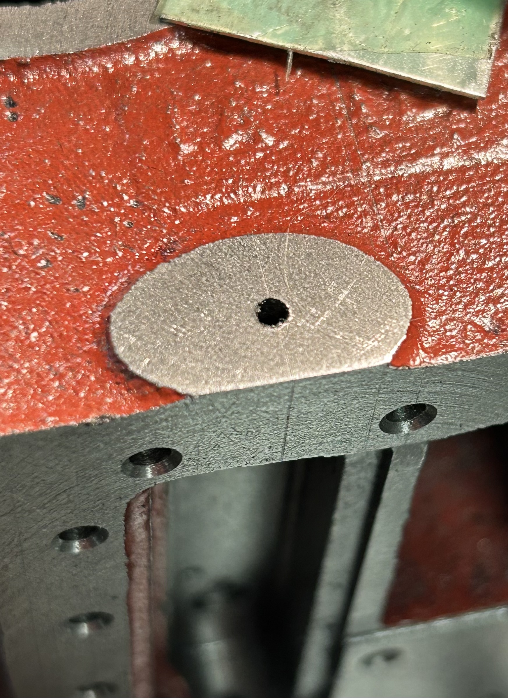

The hole came out spot on to the marked out hole position on the opposite side of the casting.

Attachment 44816Drilling hole and spotting through into square guide bush.
Attachment 44818Cutting guide bush.
Attachment 44819Guide bush in position ready to be clamped in place.
Attachment 44820Clamped guide bush in position.
Attachment 448213/32 drill supported in guide bush and hole drilled with long series drill.
Attachment 44817Opposite side, hole on marked out lines.
