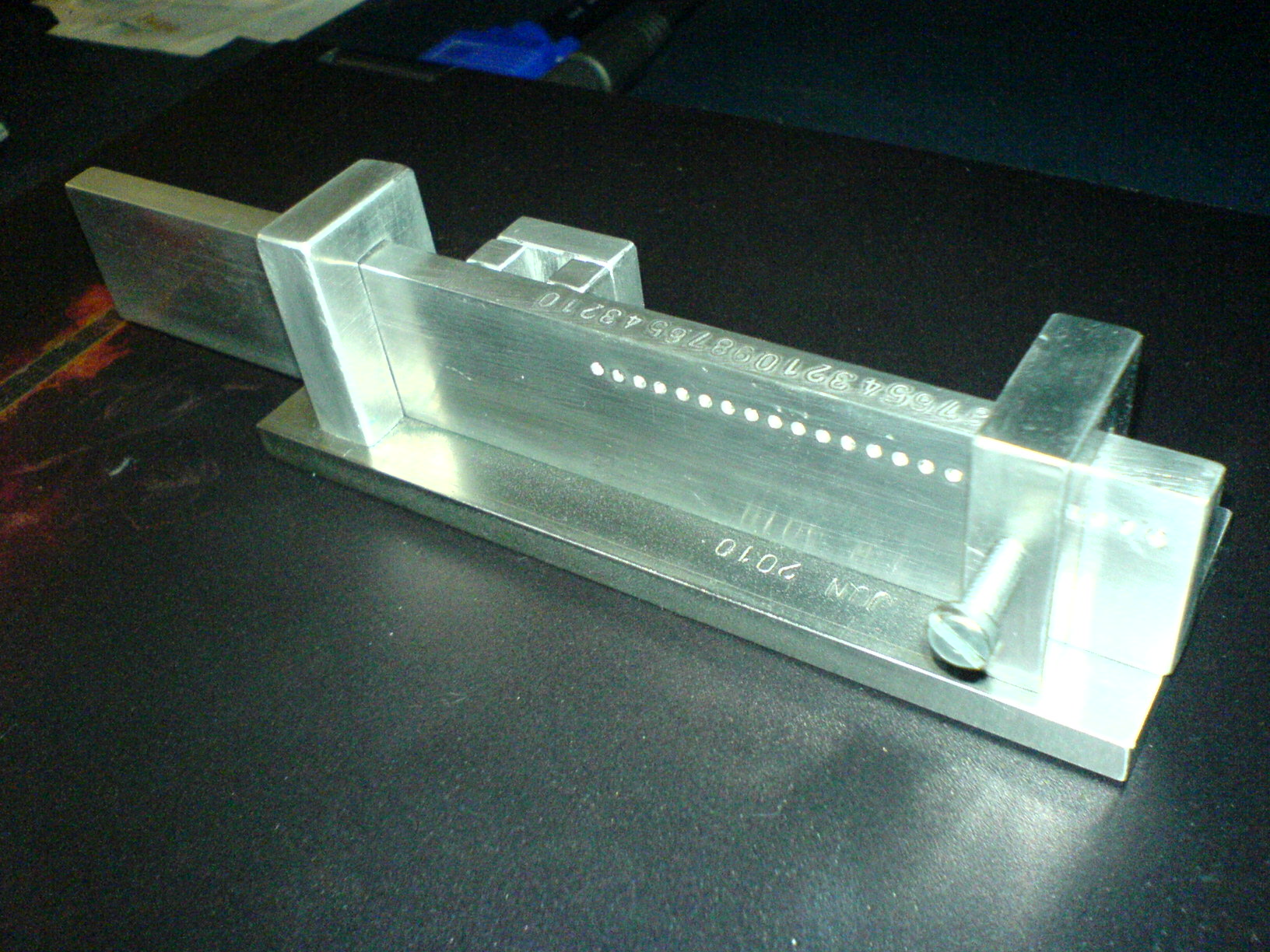

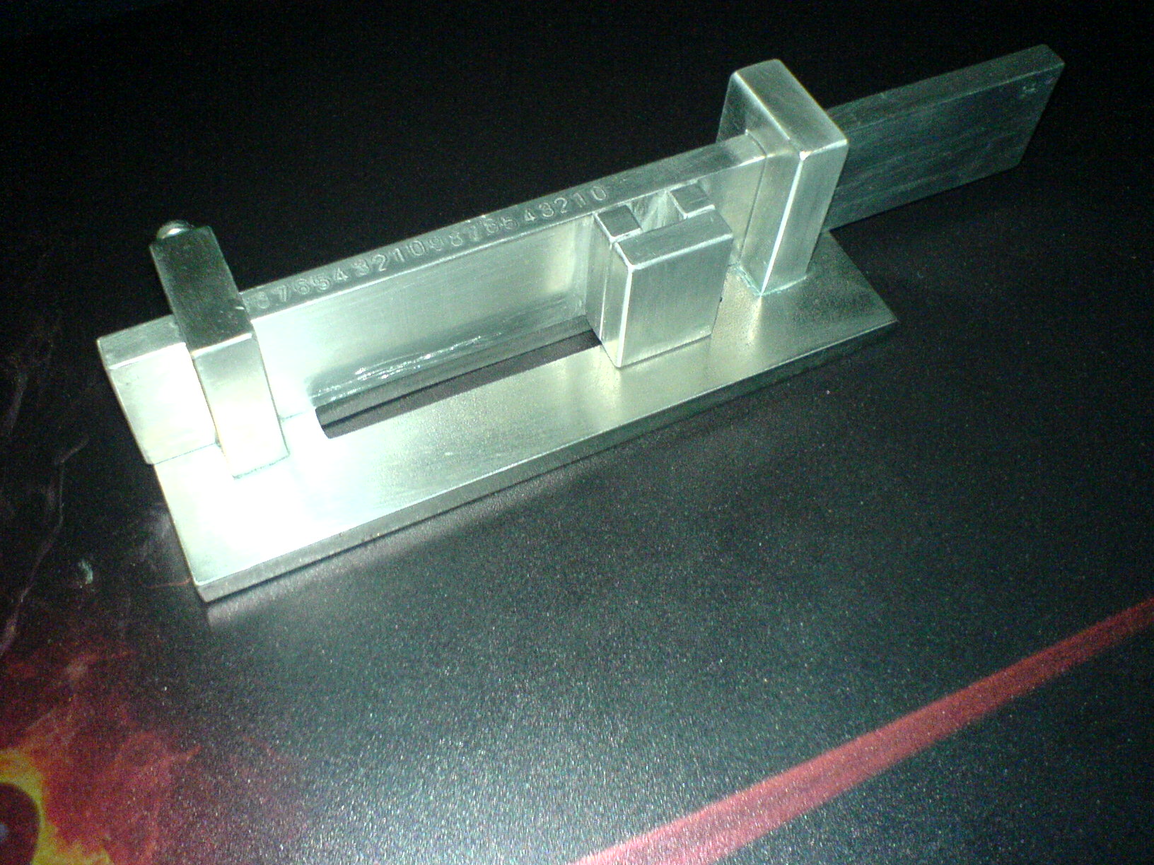

    I made a simple jig that ensures even spacing. It is only really useful when you have a large enough flat surface to clamp it to. Even pressure was obtained by dropping a weight down a tube onto the punch. But as already mentioned, different characters need different striking pressures...
    Tony - I much prefer the design you just posted!
