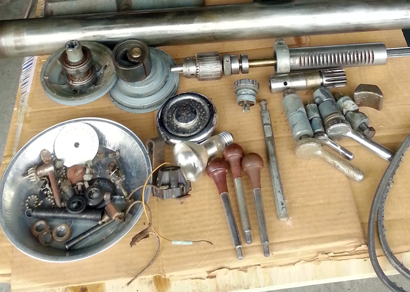

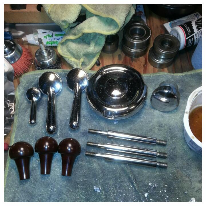

    Hi Mark, Just wanted to say thank you for the tip on Al Foil and Coke. Definitely works. I'm restoring an old Drill press (49'-51' King Seeley Craftsman) and the chrome pieces had some bad spots that nothing I had would touch them including Dad's old rubber block. I gave your technique a try and it worked darn good. There were still some rough spots when I got done so I hit them on the buffer with some green rouge. They still show but are flat and filled in now and think the spots are actually substrate for the chrome..should be OK now. The spots work ok me considering it's that vintage and had been sitting in a horse stall on the ground for several years...ran fine and strong when I tested it before I got it. Here are some before and after shots of the chrome stuff. Please forgive the rough C-phone shots.
    Very easy surface rust remover for chrome-small-chrome-parts-_original_web.jpg Very easy surface rust remover for chrome-2016-11-18_18.27.41.jpg
    Thanks again, great technique! ~PJ
