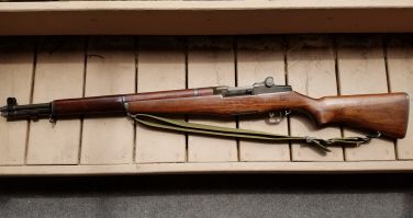

    I have always used raw linseed oil on the stock of my M1 Garand. It does have a peculiar smell to it, but I have learned to love it.
    Ron

    I hope you warm your stock by a fire before and after oiling. Takes a long time to dry but sure preserves the wood and easy to repair a ding.
    Can't tast anything when used on cast iron except good food.

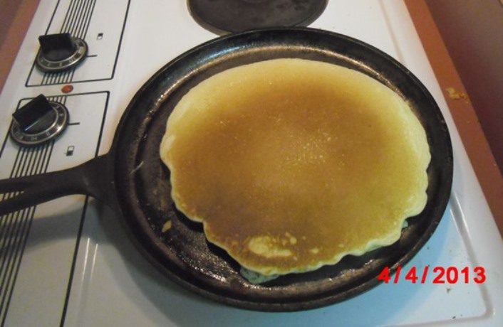

    This is what I always use to make my omelets, fried eggs, pan cakes, sausage patties, bacon, or hamburgers in
