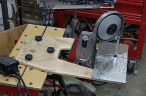

Homemade vertical bracket for a portable bandsaw constructed from plywood and mounted to a folding work table for maximum flexibility. Controlled via HF foot switches, the saw's power switch is retained in the depressed position with a Velcro strap.
