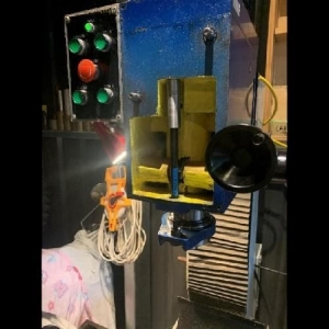

Homemade Quill Backlash Reduction Method
Rick Sparber on rick.sparber.org
Homemade quill backlash reduction method for an RF-30 mill/drill. Utilizes an automotive gas spring to apply downward pressure on the quill and, thence, to the pinion.
