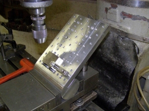

Homemade tilt table fabricated from 3/4" aluminum and intended to be utilized in conjunction with a mill vise. Measuring 6"x8.5", the table features a 2.725" large roll. Inclusion of an adjustment roll enables movement in 1.25" increments.
