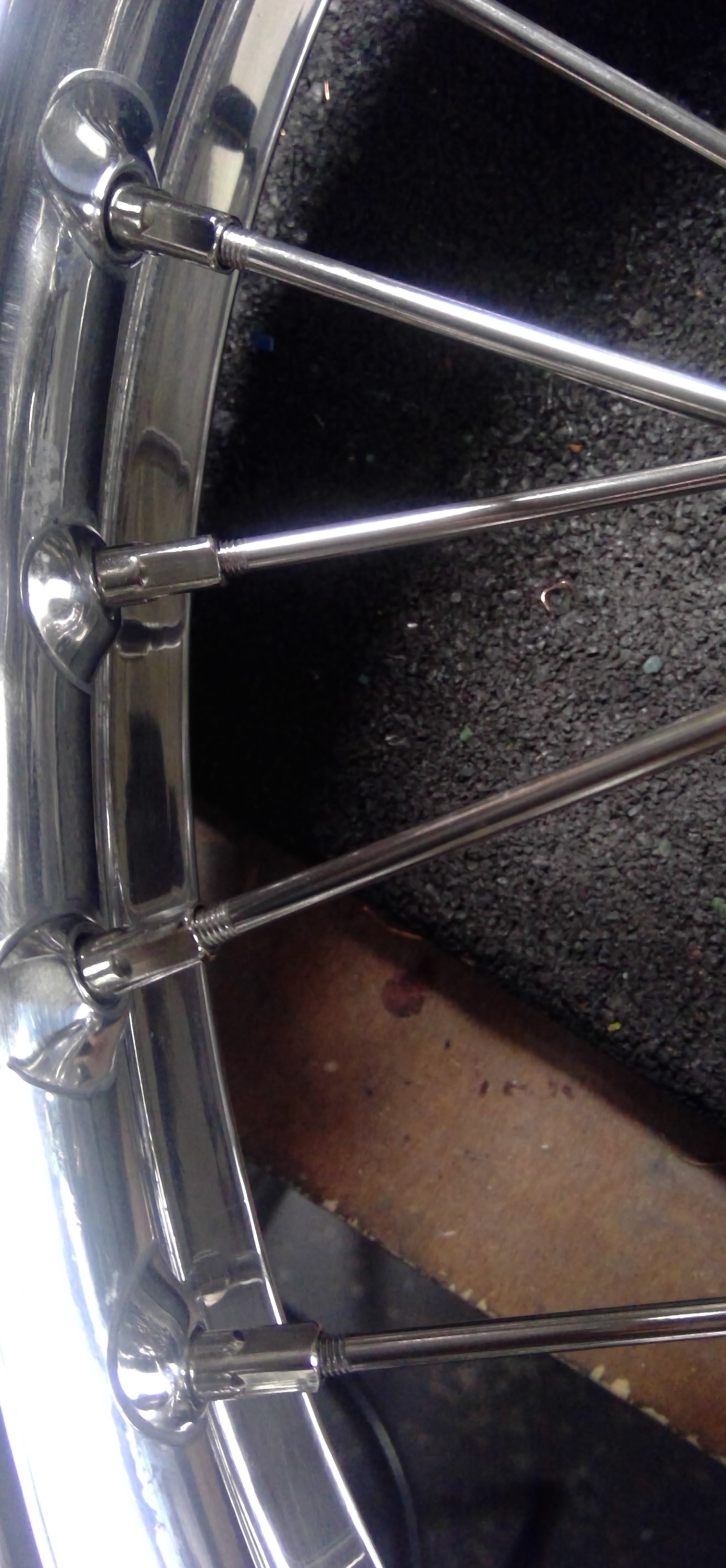

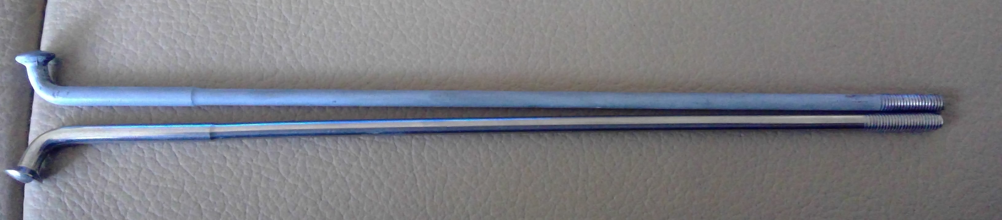

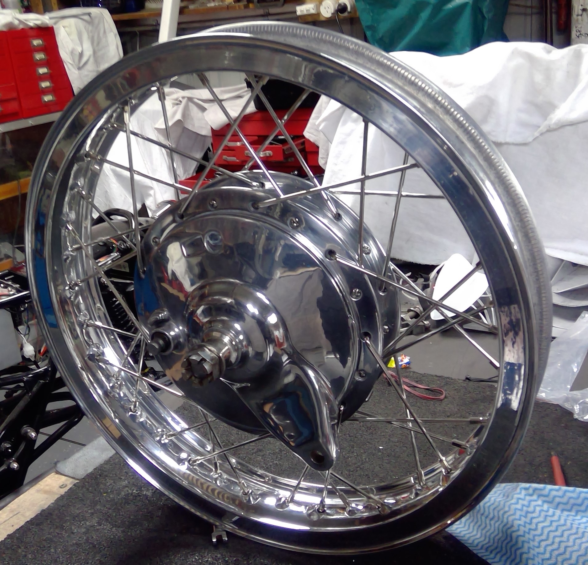

    Just watch who you get your spokes from. The thread on the spokes I bought is longer than stock spokes, so when trued there is about 3mm of thread visible between nipple and hub. Probably wouldn't bother most, but I'm not most! If you blow up the picture you'll see what I mean, the dull grey ones are stock. Not happy, I complained to the seller, GeoffsXS , he now says he wont deal with me and sent me a number of abusive texts and emails. Not that I need him, there are a plethora of XS accessory shops around.

    You are correct that that is unacceptable. I will not do business with GeoffsXF if I ever need spokes...

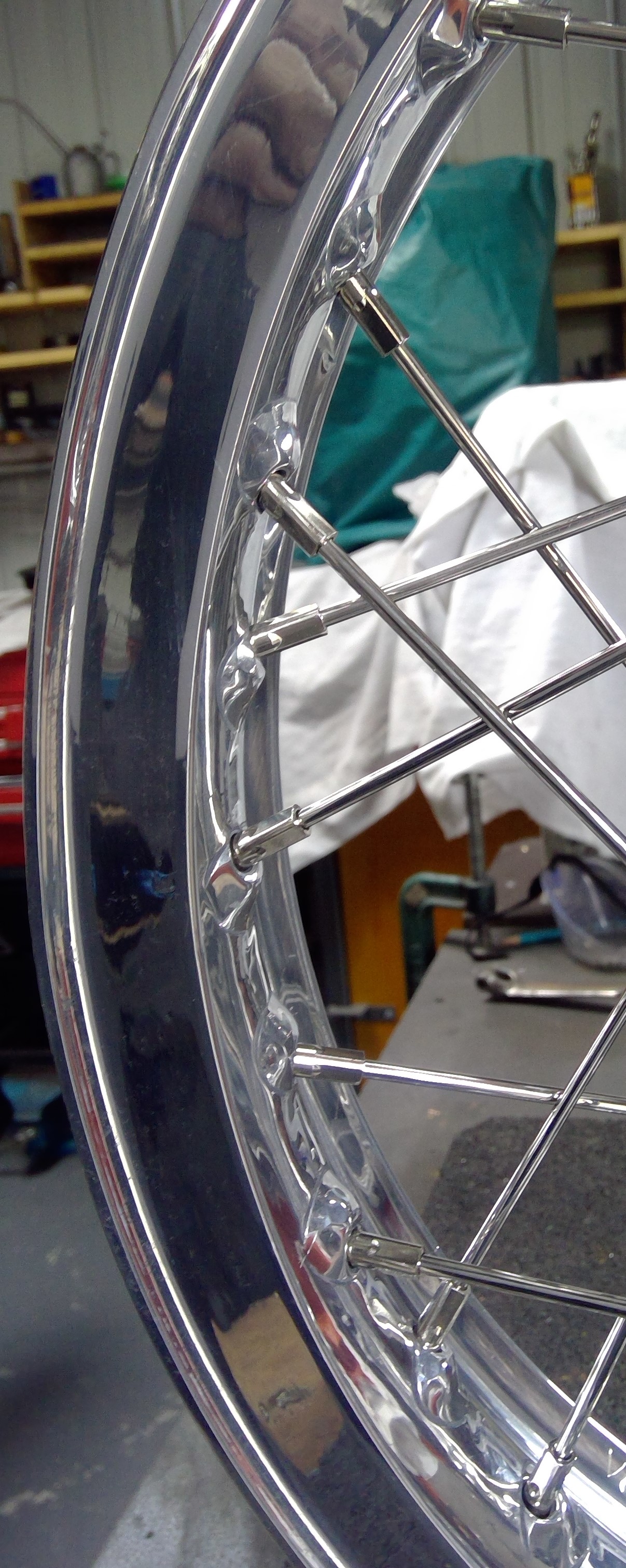

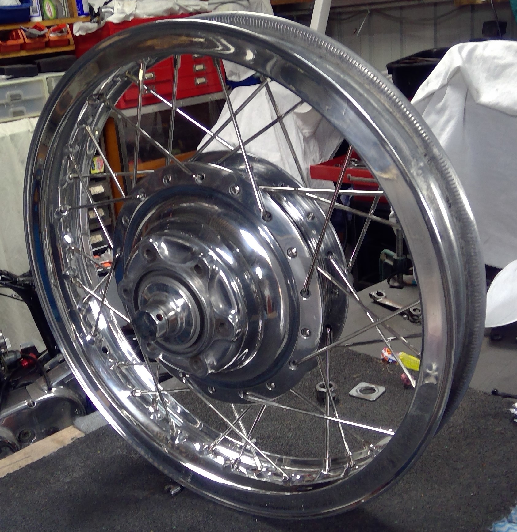

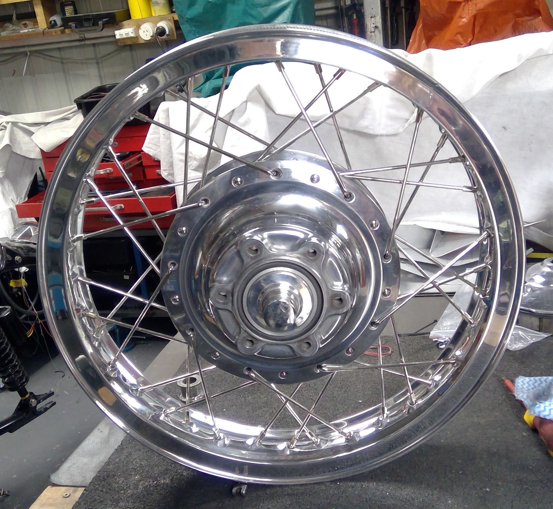

    Spokes arrived from Heidens this afternoon, so laced up the rear wheel. What a difference, no exposed thread on any spokes.

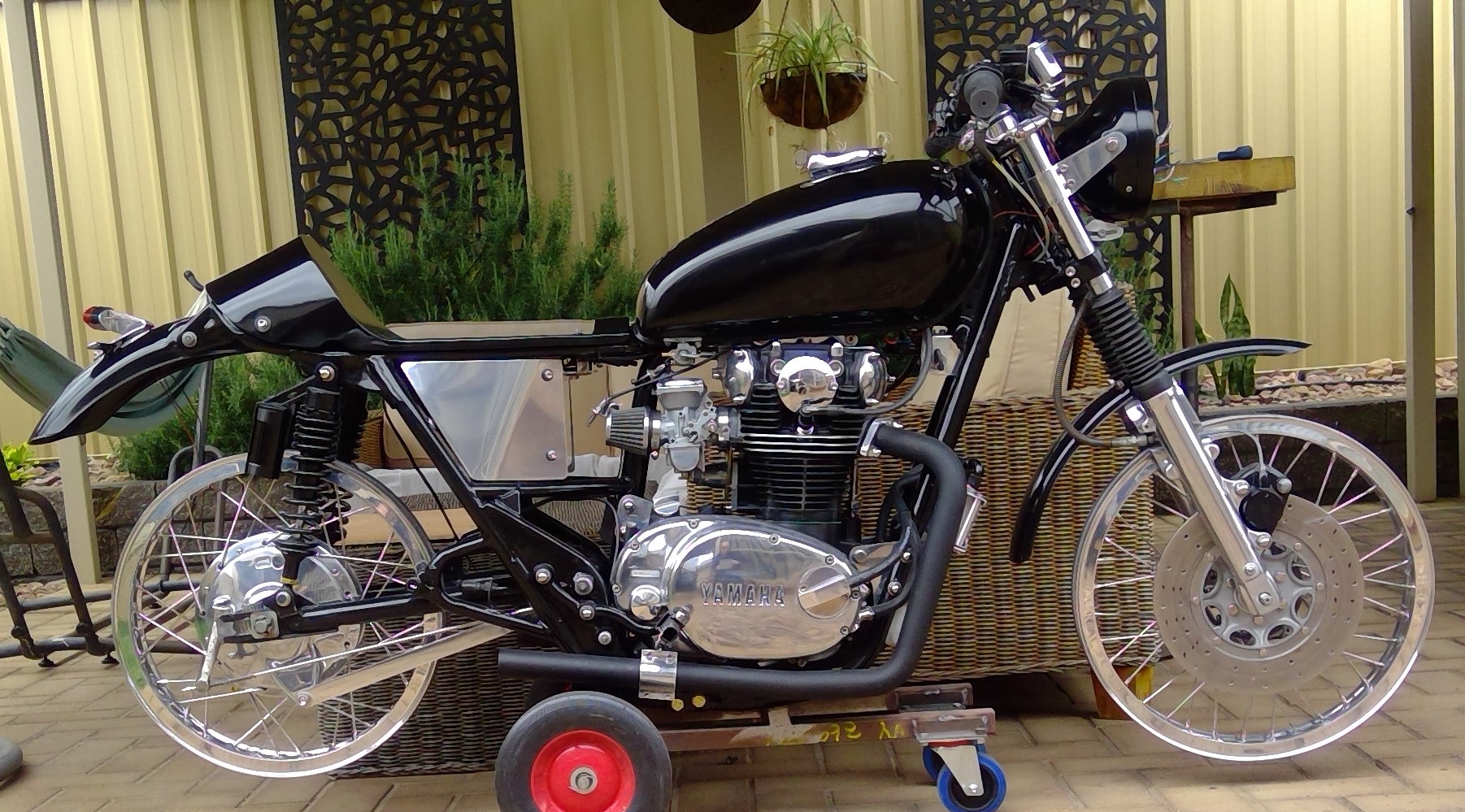

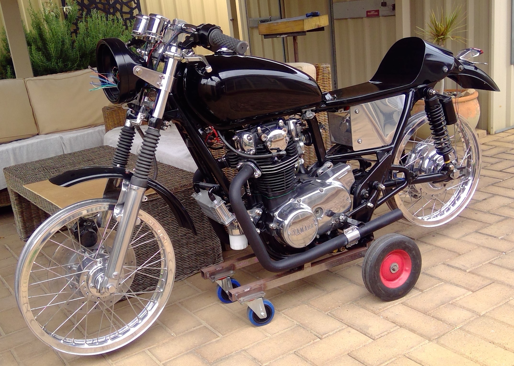

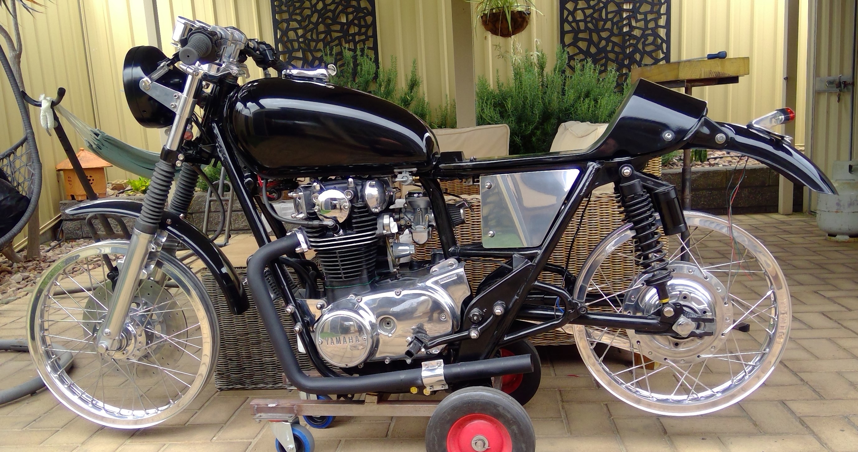

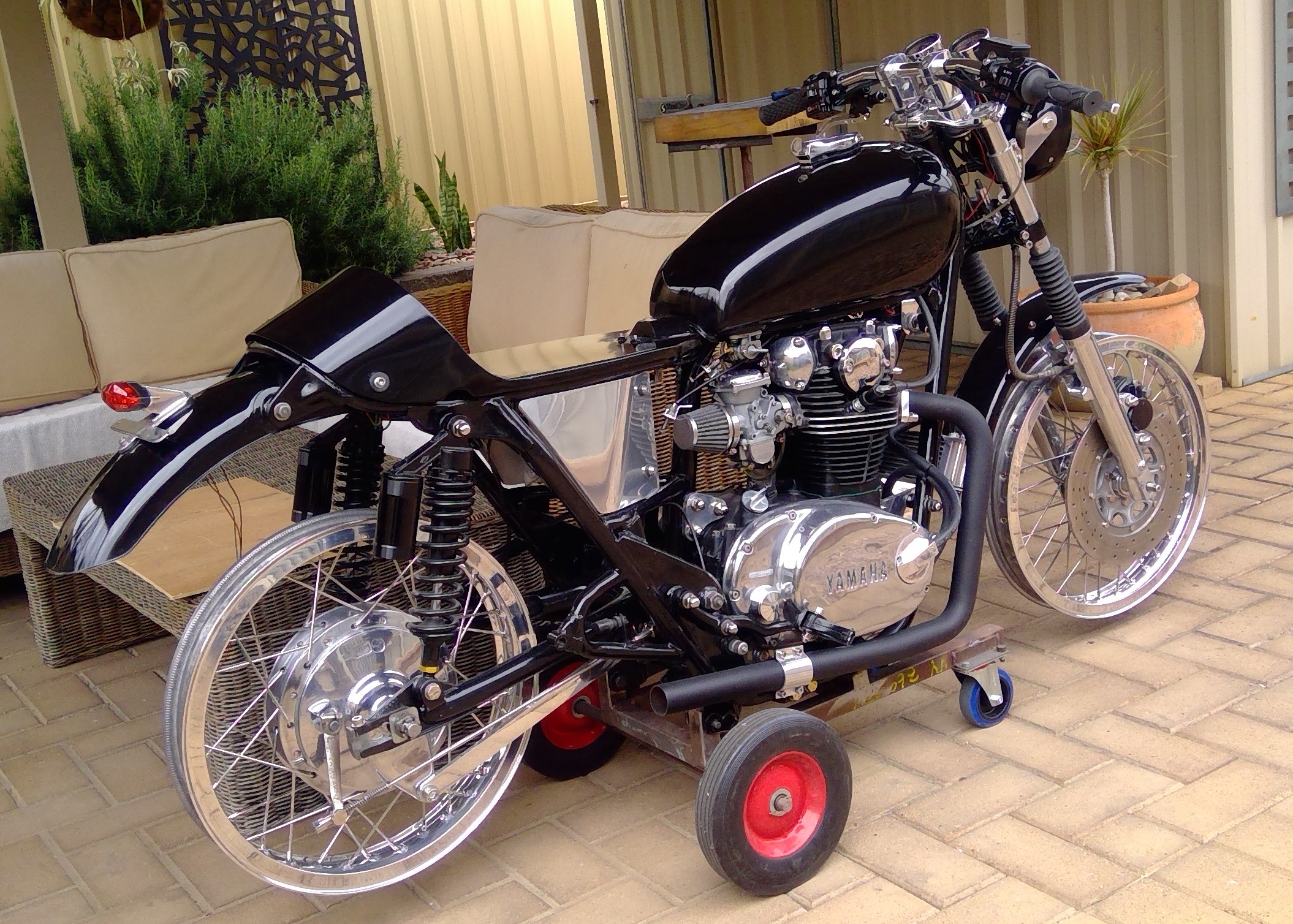

    Some progress shots. Looks much better with spoked wheels. I've taken the carbs off as one diaphragm has been holed, so, I'm tossing up between VM round slides or fixing the BS38 carbs. Not real keen on vacuum carbs, so leaning toward the VM round slides. Damned expensive though at $600. It's come a long way from such a humble beginning.

    Changing the diaphragm on the carb that you already have put time and effort is the way to go. The money saved will surely be used for completing the project. Spoked wheels are definitively the way to go. Nice job !
