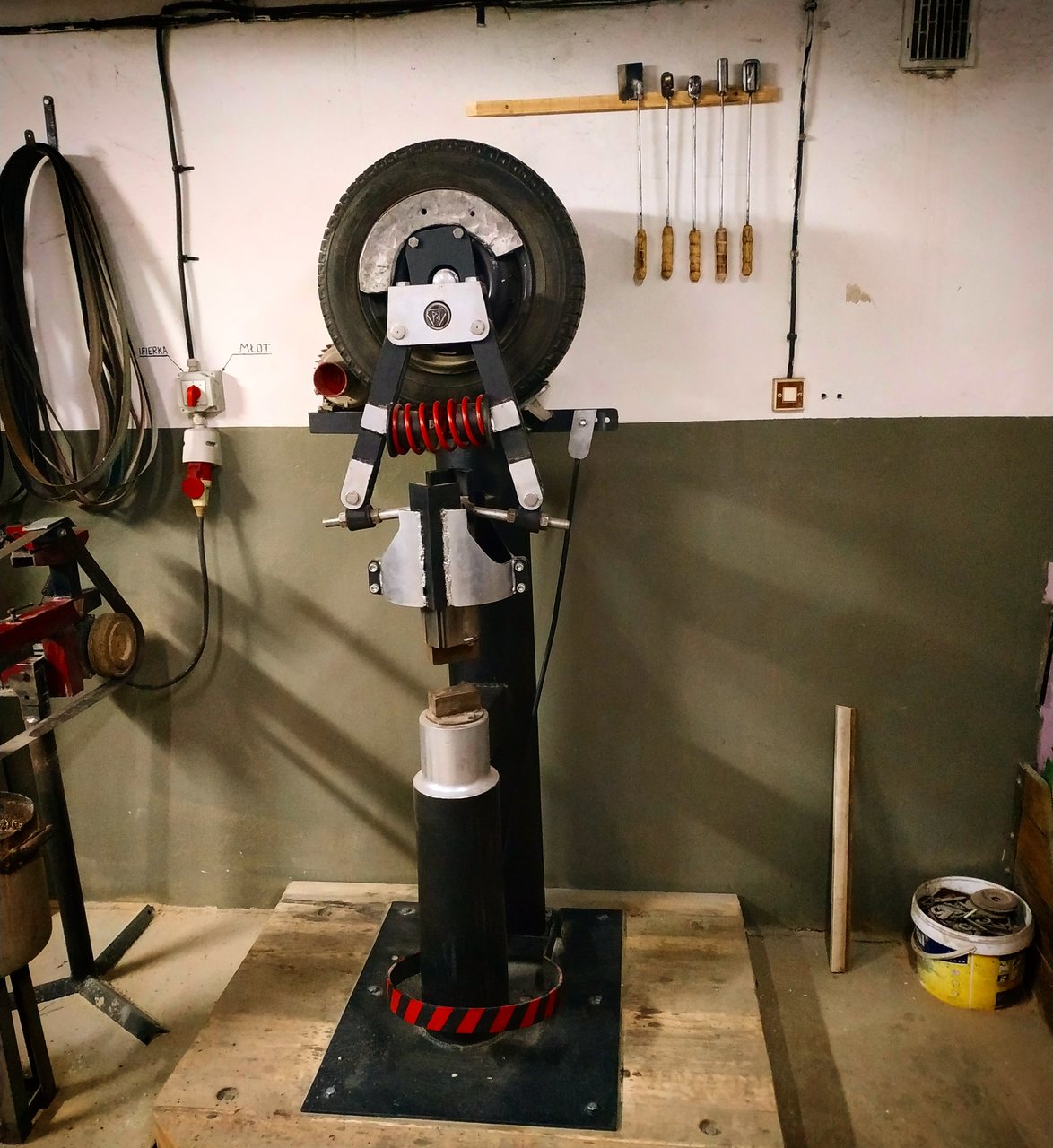

    Power Hammer build video (29:07) by SteelCraft
    This was my first big project, and first video of this type, so don't be mad about music
    Some specs:
    Ram weight: 80Lb,
    Dies are made out of 50x50x100 [mm] C45 (1045) steel, quenched in water,
    Motor: 3 phasic (380V) 1410 rpm, 1,5kW (2hp)
    I put whole machine on wooden base and 22 [mm] thick rubber mat because of thin floor in my workshop. After 2 years of using, nothing bad happened.
    In build video you can clearly see shaking of hammer, I simply put to much counterweight, after reduction, runs smoothly.
    The only change I want to make is to mount a stronger spring.

    how does the variable speed work?
    Just friction between motor pulley and a tire. Harder you press the pedal - less friction more spin. You can change top speed by changing pressure inside tire.
    I recommend to have smooth pulley without grooves which "grind" a tire during operation.

    I did not see the pedal, does it move the motor?
    Pedal is painted with red warning strips, connected with linkage to motor arm. When you push this pedal motor is lifted and pulley is pressed into tire
