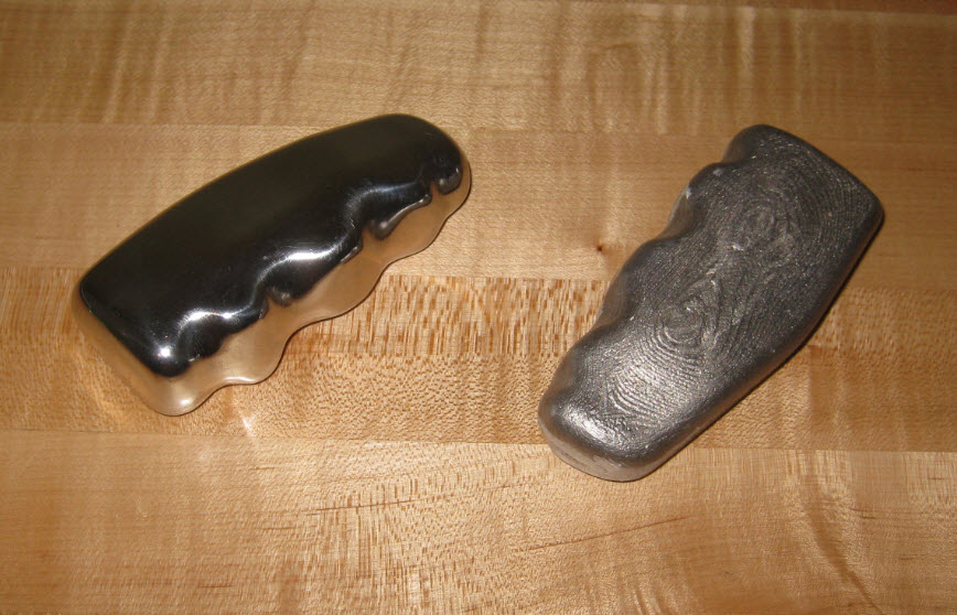

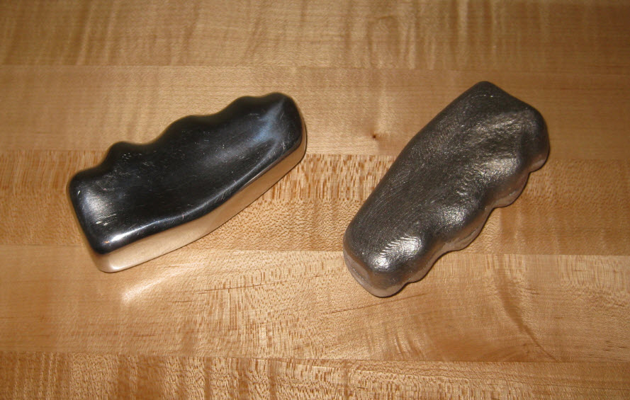

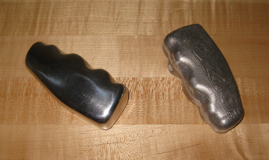

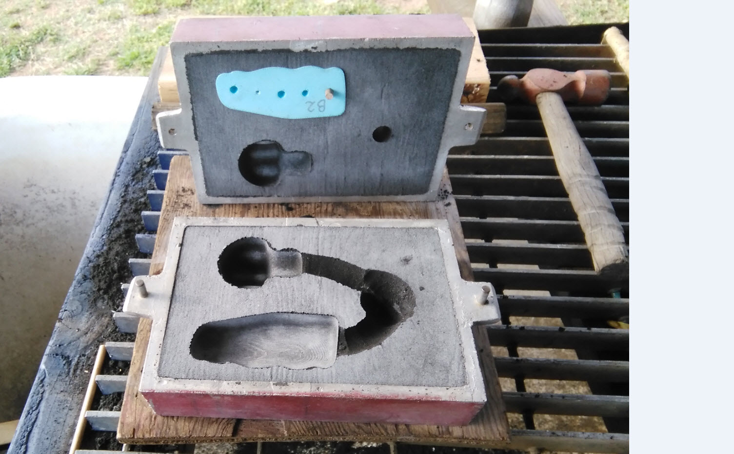

    In the Sand Casting Flask photo you can see there was another part that SuperDave Cast.
    It is a Shift Knob for my 1999 Jeep ...

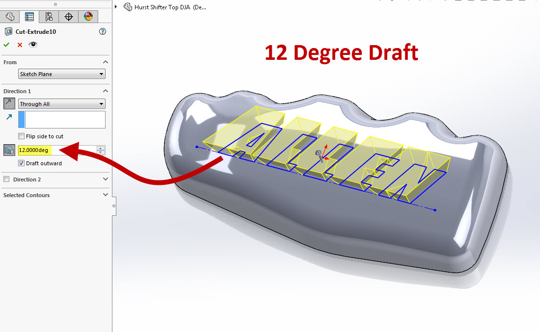

    Also drew up in SolidWorks a Hurst Type Pattern for SuperDave
Name:	12 degree Draft.jpg
    3D-Printed the Split-Patterns for casting and sent them with the Drill-Press Knobs to SuperDave.
