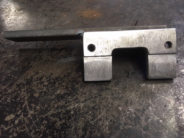

    I knocked up a new soldering fixture to aid the alignment of the two ends. Once the blade is cut to length I grind the two ends at approximately 45 degrees to increase the surface area of the joint rather than just butt the ends together. I have used this technique for years and have never had one break yet. The photos below show the fixture. Two M6 penny washers are bent to clamp/hold blade in place
    Fixture with welded bar to enable it to be held in the vice so the heat source can be placed beneath the blade.

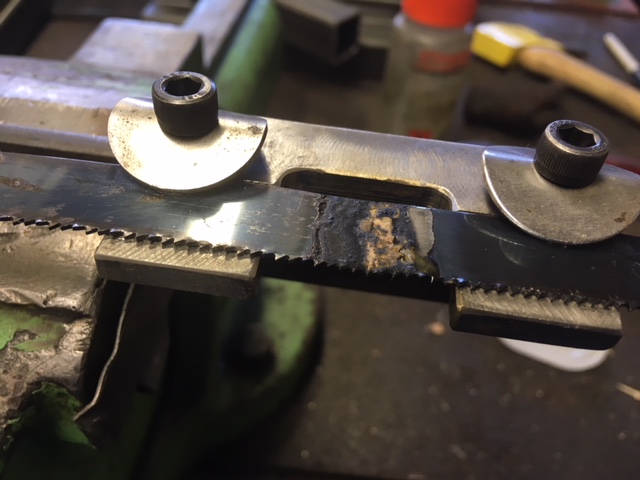

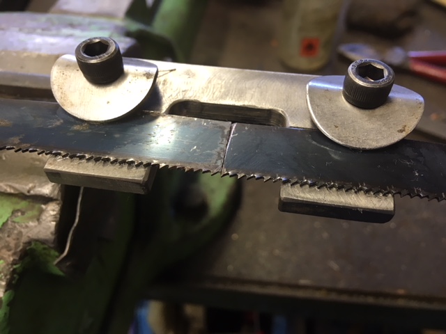

    Ready for silver solder NOTE the splice to increase the mating face surface area and bent M6 clamp washers.
    Silver soldered together. Another advantage for silver soldering the blade doesn’t require annealing

    Nice job,
    I was taught to flip one of the blade ends over and then grind the ends at the same time. That way the resulting joint will be straight. Of course we were using a blade welder, not a brazed joint. The annealing process was to first hold the lever on the welder down until the weld was made and then pulse it in decreasing amounts to anneal the weld. Never had one break.
    Too bad the stand-alone welders are in the $600 and up prices here in the U.S.
    Fortunately, a good braze job is stronger than the metal being joined.

    "I was taught to flip one of the blade ends over and then grind the ends at the same time." Let me add: one end <1mm offset; and grinding both 45° angles at the same time. Then the exact angle doesn't matter.
    The clamping spots should be at a greater distance, say, 2"; to give room for a generous flame >> brazing time just a few seconds
    What saves a lot of adjusting: precisely aligned shoulders for both backs of the blade. Like one sees it on
