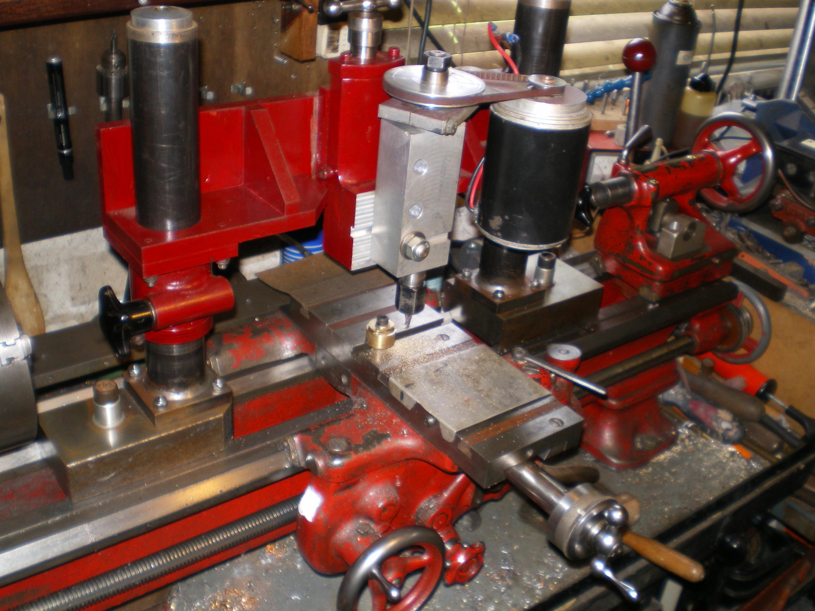

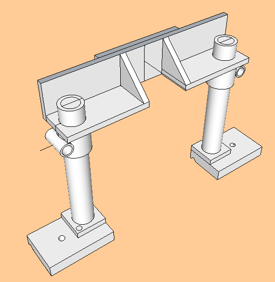

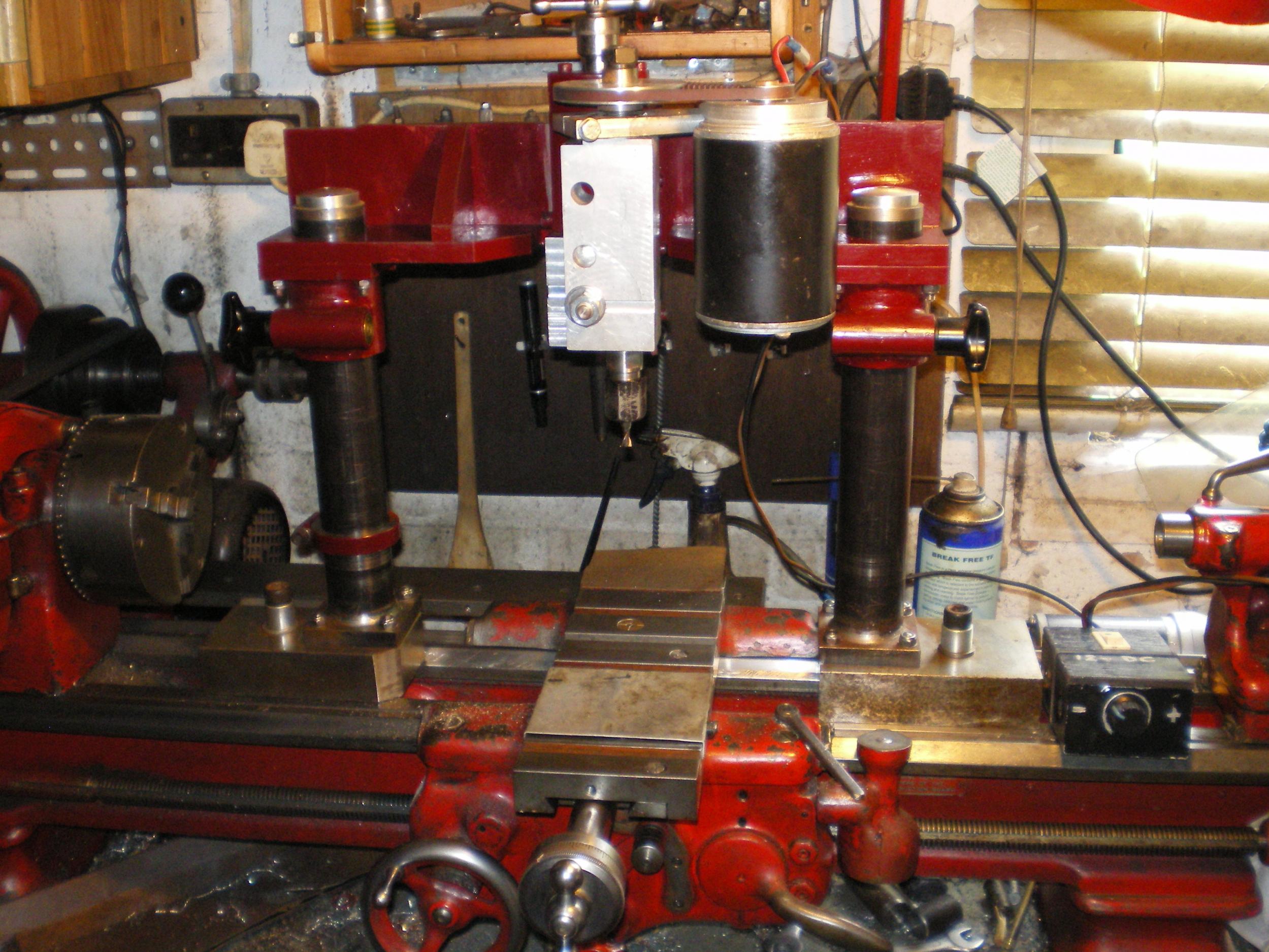

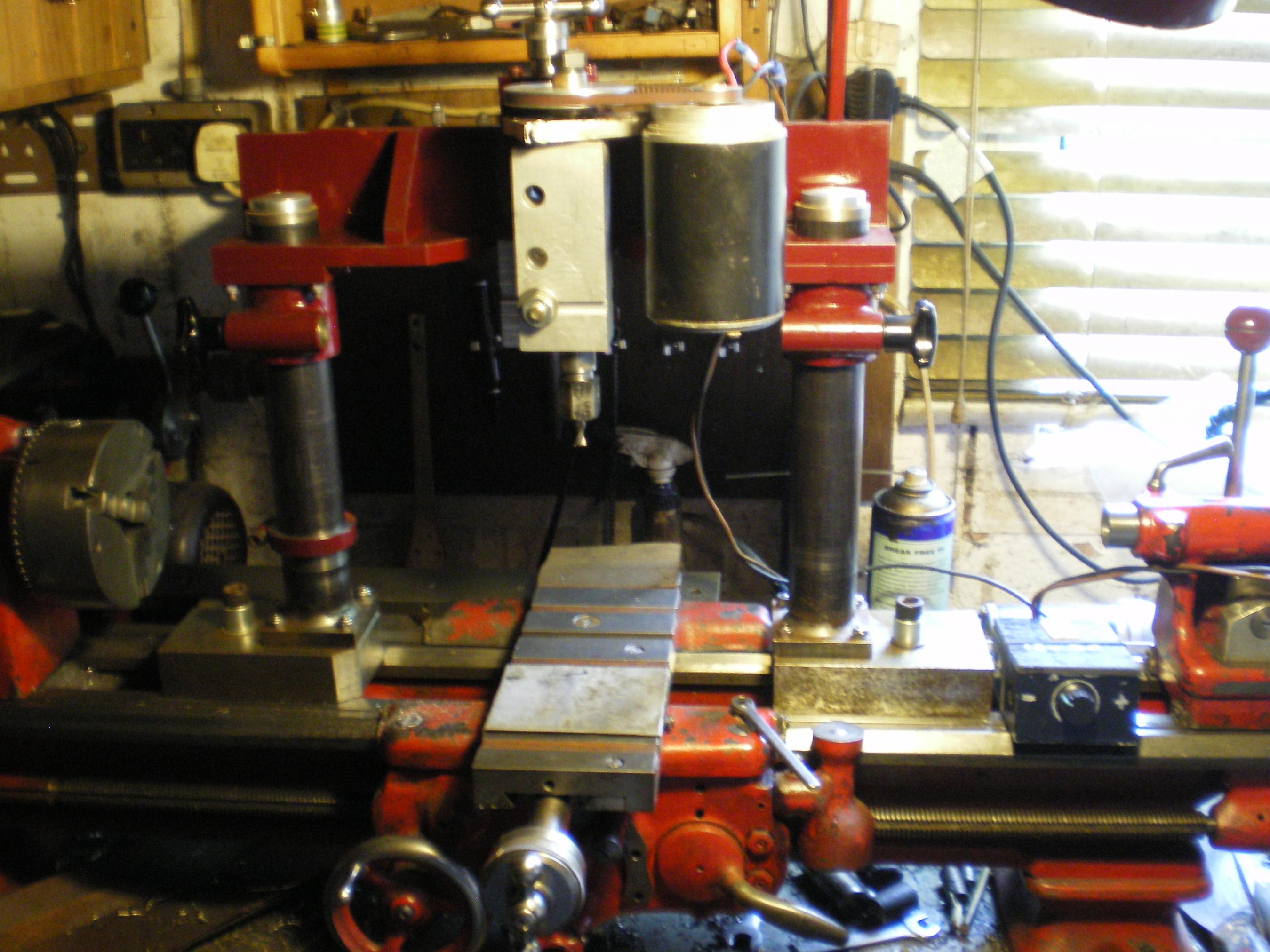

    I had at some point made raising blocks for my SB for a one off job but had not used them for years so I found another use for them.
    They formed the basis for a rigid milling attachment together with some thick walled tubing, some ½ inch steel plate and a surplus topslide with 2 ½ inch travel for use with my light milling spindle.
    All parts were made on the lathe paying great attention to squareness of all milled parts which are pinned and bolted together, any welded parts were machined afterwards to maintain accuracy.
    By raising the head on the pillars the range is from zero to 7 inches from the table although limited to the topslide travel for any given setup.
    Two ¾ inch brass cotters clamp to the columns and these maintain alignment quite well.
    I have found this attachment very useful but being limited to ¼ inch cutters is not fulfilling its potential so a ½ inch capacity 3 speed geared cutter spindle is in the making, this device has helped a lot in making that in accurate hole spacing.
    Future mods will be an acme thread raising adjustment to the whole gantry, in the meantime I have a stop clamp which enables me to raise or lower the head by using gauge blocks and also stops it from dropping while adjusting.
    The fact that the head will travel the full length of the pillars without binding proves that attention to machining has paid of.
    With my extended crosslide I have 8 inches of travel and 6 inches of saddle movement between the pillars.
    The whole assembly is mounted by two ½ inch cap screws with clamp plates tailstock style and can be fitted in a few minutes.

    I especially like the use fo twin posts to form a gantry this places the work piece within the confines to the columns thereby greatly reducing stresses on the parent machine
    The one issue that I see and this may be a product of intended design or the viewing direction of the photo, is To me it seems with the mill attachment mounted use of the carriage in normal lathe turning would be restricted if not close to impossible Though as said I can't really tell from the pictures
    Thanks Frank
    This is a set up for milling only, unable to turn while in place but only takes a few minuets to change modes.
    I to thought about the stresses on a bench lathe bed and decided to place directly over the bed instead of mounting over the rear, I have noticed some recent posts about rigidity issues with some commercial attachments mounted this way. You have to work with what you have with consideration.

    Is surface grinding to square the riser block pads to centerline of post and/or threaded portions? Dissecting the photo hinted slight design alterations to work around that.
    Sorry for the minimal post, I have been busy of late.
    To explain a little further, the raising blocks were ground to the same dimensions as the tailstock base until a DTI mounted on the boring table clocked zero over the over the width of the blocks, this would also also take into account any wear in the bed, saddle and slide ways on a very old lathe and would match the way the lathe is.
    The blocks were not milled but the V was plunge ground from solid with a form wheel, this was the start point for further work.
    The base of the pillars were faced after welding using a 3 point steady and the pillars running true, the top clamp faces were trued in the same manner using a service mandrel. Using this method it was at least possible to ensure correct tramming in one direction, the other could be adjusted on the verticle slide.
    As this is an attachment and not a milling machine some compromise must be accepted but it has turned out better than I had hoped for, and the blocks are still able to be used for their original purpose if the need arises.
