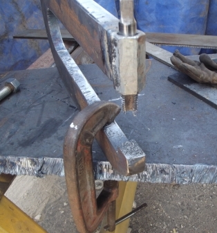

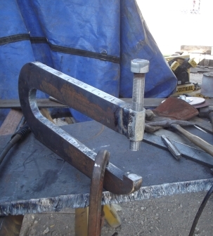

    Sometimes there is no getting around the need for a reasonably strong very deep throat-ed "C" clamp
    I made this one today for a project I needed to complete before tomorrow

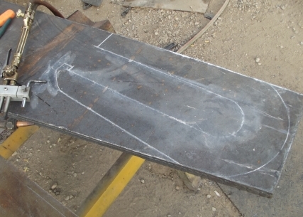

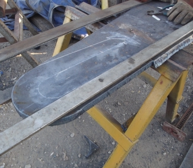

    I can't relly class this Stainless cutting bar as home made because it is just a salvage piece I found and use for a straight edge or as seen a cutting guide

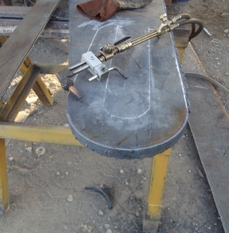

    OK the circle burner attachment is another tool I made awhile back . over the years I bet I've made dozens of these to fit just about every torch imaginable the nice thing about this one is it is light and hardly ever in the way, for normal cutting I just rotate the point up against the torch body out of the way
    not wanting to take the time to thread a piece of hollow stock I used a 7/" coupling nut then ran a tap through it after welding to remove the burnt coating
    A quick clean up and a piece of all thread and the clamp is ready for use
    Later when I go to town I plan to buy some B7 grade threaded rod as regular all thread is too soft for long term use
    the 1" deep throat worked perfetly

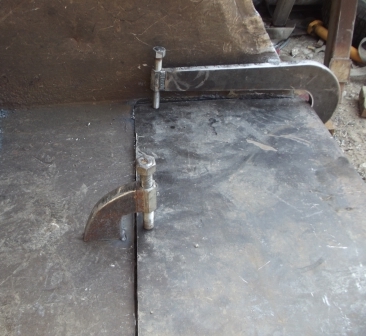

    Then there are always my old stand by weld on clamps made out of the same materials

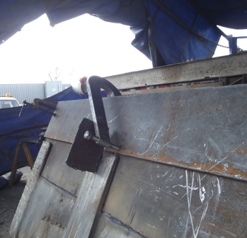

    and no job is ever complete without one more homemade from scrap item
