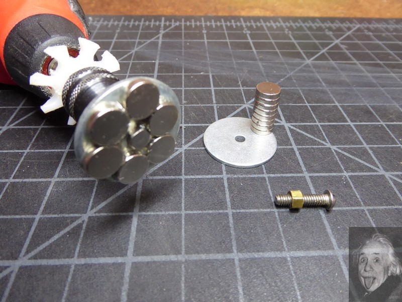

    Miniature mechanical demagnetizer
    For bigger tools, I demagnetize with a bulk tape eraser (remember those?). For smaller tools I use my old Weller soldering gun.
    However, when I saw Mark Presling's ingenious mechanical demagnetizer...
    DIY Demagnetising tool that works
    I had to have a miniature version for my in-house small job bench. Beyond its undeniable coolness, it would save me the trip to the garage to retrIeve the soldering gun and could be spun with any of the Dremel/Foredom-like tools lying on the bench.
    I was fortunate to have some 1" fender washers with a 1/8" hole that just fits a 5-40 screw to provide a shaft to grasp in the Dremel. Six Harbor Freight 5/16" diameter super magnets were epoxied to the washer in an alternating polarity configuration.
    Spun at even a low speed, it does a fine job of demagnetizing small tools.
    Regards, Marv

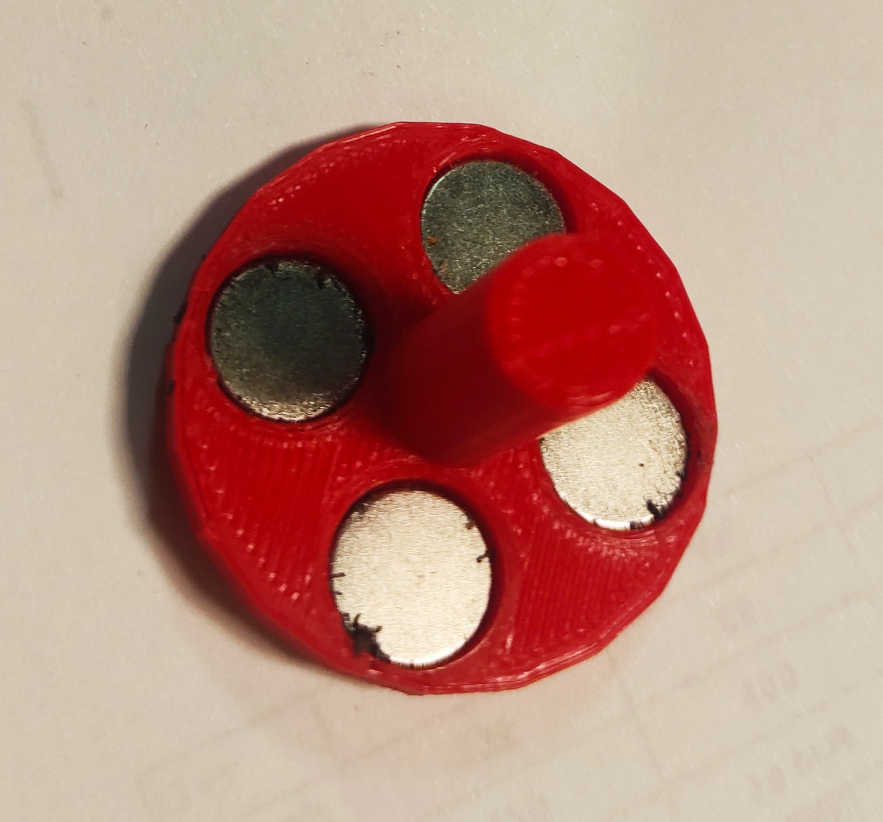

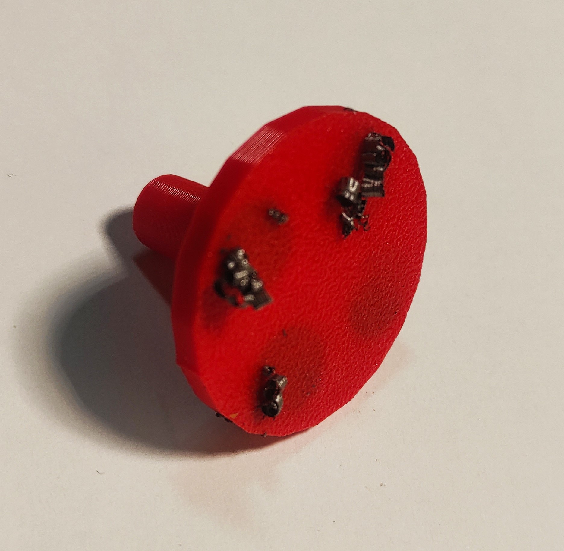

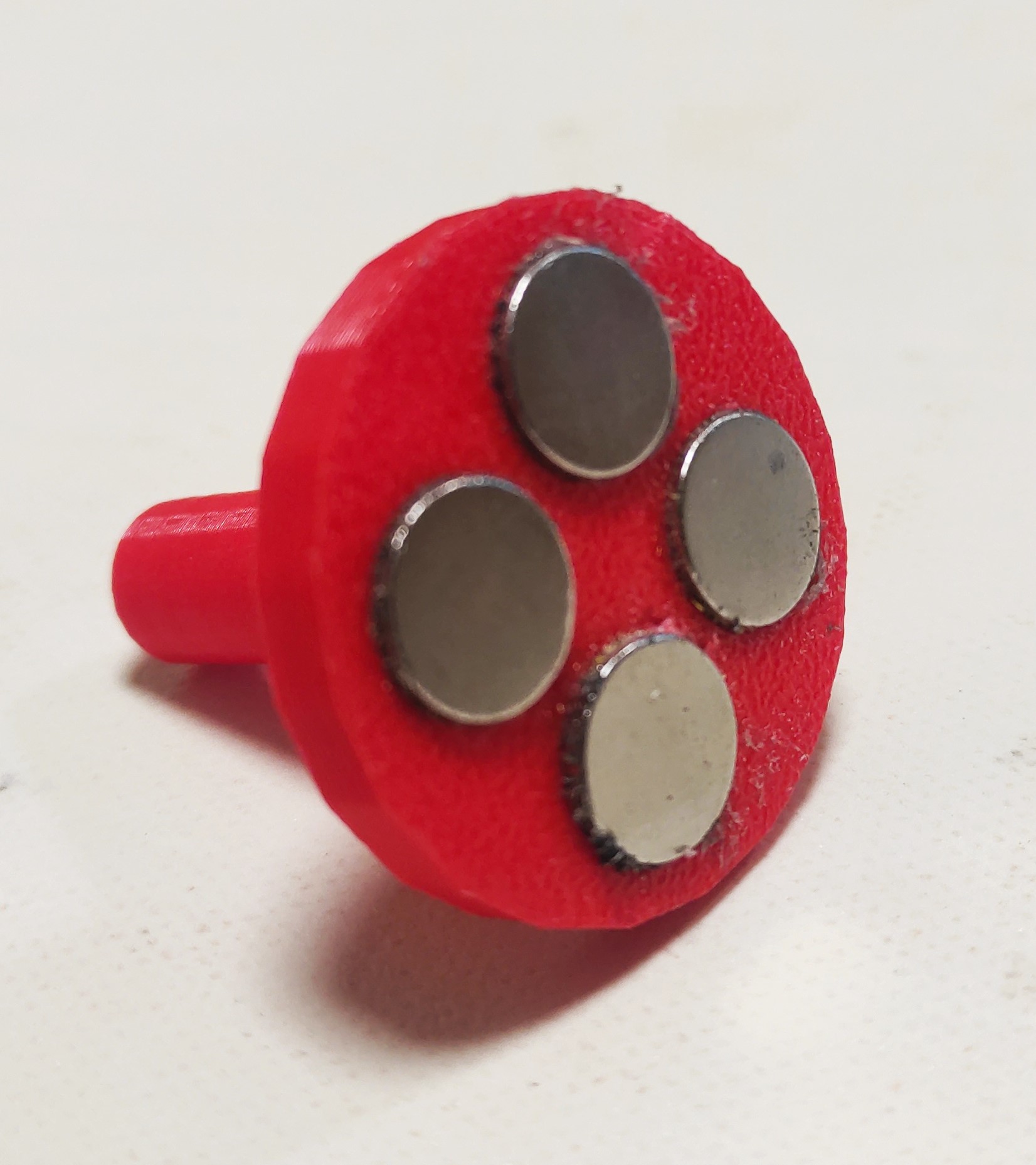

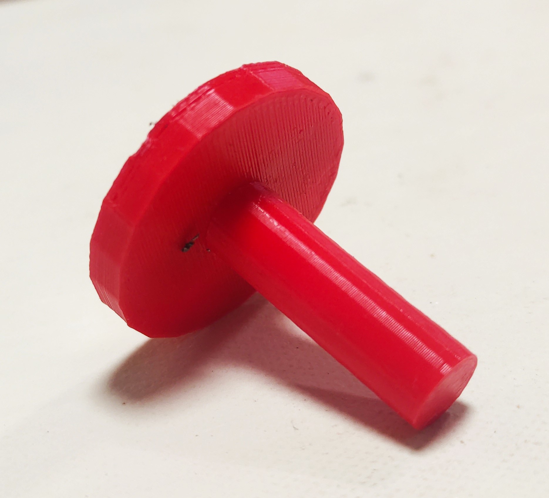

    Nice idea! This is my 2024 3D-printed version. Since it is plastic I don't have to worry for the magnetism of the stem.DIY Demagnetising tool that works-magnet1.jpgDIY Demagnetising tool that works-magnet2.jpg

    Only after posting my thread did I notice that there was another one, containing a 3D file of this tool. Great minds think alike... Magnetising and demagnetising tools.
    I happily adopted his concept.DIY Demagnetising tool that works-magnet3.jpgDIY Demagnetising tool that works-magnet4.jpg
