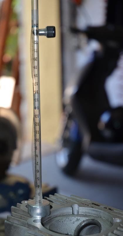

    Wow interesting and well done project. Maybe you arelady said this somewhere and I missed it, but why impact bounce relates to hardness?
  8. #16
    Nov 2016
    Spain
    1,565
    689
    Thanked 2,646 Times in 709 Posts
    tonyfoale's Tools
    Quote Originally Posted by Claudio HG View Post
    Drop a tennis ball on concrete, then go and drop the same ball on some soft ground.
    Softer material deflects more and more energy is lost when impacted.

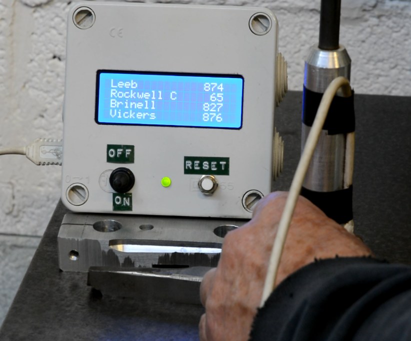

    Tony Foale is only partly correct with his claim to measure hardness with his (ingenious) device. What it does measure is the energy loss an elastic ball experiences when rebounding from a surface, since
    KINETIC ENERGY = mass times VELOCITY squared
    and velocity is what Tony's device measures. Genuine hardness testers measure, however, only the energy consumed by moving material sideways and upwards, the energy consumed moving the test piece downwards is ignored, because reading takes place only AFTER all dynamic effects of doing the measurement have died away. This has consequences for what parts can be hardness tested.
    Firstly, the test piece needs to be thick enough that elastic or inelastic bending does not consume appreciable energy. If Tony were to measure the hardness of a THIN knife, with supports way away from the point of impact, he would obtain a different "hardness' than what he would if the knife blade were supported by a sandbag, or, worse, by a heavy and smooth steel anvil.
    Secondly, the tested material must be uniform, i.e. the orientation under which the piece is tested does not make any difference to the outcome of the test. This demand arises from doing hardness conversions, such as to Brinell or Rockwell. Thus, materials with directional properties, such as fibre re-enforced materials, but also cold deformed steel, will produce ridiculous hardness results.
    Thirdly, if you are old enough to have been exposed to Silly Putty, you'll know that its response to deformation (what we commonly call hardness), seriously depends upon the rate of deformation, to such a degree that it may be claimed with perfect validity it has hardness zero, by just watching a steel ball slowly being swallowed by no more force than its own weight. But, when doing the deformation fast enough, e.g. by dropping a silly putty ball onto concrete, its rebound is higher than what you can achieve with a hardened steel ball, which has a hardness of more than 50 Rockwell C.
    Thus, be careful when you do measurements with Tony's device. It may be "hardness" what you get, but it may also be a load of bull. It all depends on your own setup and understanding of what you are doing.
    Lastly, a word on data conversions, since Tony's device relies on them. There is a reason behind reporting hardness as a number such as 50 Rockwell C, and not as, say 1000 Newton per square millimetre (the stress to produce a 1mm2 indentation, or 1000 Newton millimetre per cubic millimetre (the energy to produce a 1mm3 depression). Rockwell C specifies the load that your testing machine applies to be 100 kilogram, i.e. a mass of 100kg is lowered onto your sample, making an impression, via its diamond cone front end, a fraction of a millimetre in diameter. This diameter is then converted into a number, using a standard table. This table assumes, for example, that the impression is a perfect circle. But visual inspection with the measuring microscope shows that it is not . . .
    Why? Take a Knoop hardness tester, which leaves impressions only a few thousands of a millimeter wide, and repeat your hardness measurement on 100 positions on the same test piece. Result? 100 different results, with a standard deviation of easily 20 percent, and I have observed 50% standard deviation.
    Again, be careful with what you conclude from using Tony's device. If you do Quality Assurance, and your customer has told you to use it, then do use it. But if you do process development, and you need to optimize both wear resistance ("my knife gets blunt so quickly") and fracture resistance ("the cutting edge chips"), I at least would stay far away from the gadget, as in that situation it is just a waste of time.
    As I have said before, it is a brilliant design, but it also totally ignores the reality of the physical metallurgy of a real piece of metal, its composition and its internal structure from grain size and orientation, inclusion content, via dislocation density and orientation, down to chemical bonding. They all matter, as only when interacting together they produce hardness.
    Take your pick. I won't build it. For my purposes, and with my background both in process design and quality assurance, a file is just as trustworthy a hardness measuring tool, and I don't need to build it.
    And if you truly need a portable hardness tester, ebay sells a portable Brinell one for USD1580.00. And of all the hardness testers I have used, Brinell is the most repeatable one, because it samples a larger area than any other tester I have used. Vickers comes second, but that is clearly a research tool, not for Production use.

    True; but limited. At the commercial level certified instruments, de rigueur, in a private setting excellent.
    Grassroot demystification of a scientific principal.
    A collection of known coupons [ie Rockwell discs] would easily bracket a sample, even somewhat out of the lower range of a Leeb device. Immediate velocity at the part seems quite reliable compared to discerning bounce height, even though they are related. That a sample must have full support is a given. Demonstration of bearing ball on HSS bounced as one would expect. The need to interpret softer yet metallics virtually non existent, but camera and standard rebound instrument cover most remaining conceivable work. Safe wager says not 1 in 1000 private environments have test apparatus, while a good number are heat treating simple work often; oil and water varieties, probably casehardening most of all. I'll lay down funds now to build a portable tester, over a bench bound item requiring destruction of large part, 10:1.
    And it wont be a chinesium imposter.
    I realize this could be taken as pugnacious, but experience sourcing and building a $10 kit soundly beats 1.6k for incidental use.

    So much to look at here. For starters, this device does not measure velocity as you assert, it measures the ratio of the initial and rebound velocities. That is a very different thing. That measure is a accepted by ASTM and similar standards bodies as a valid hardness test. Like any test, it has to be done properly and within the intended use or it will as you say report a "load of bull."
    A Rockwell tester will not give useful measurements if used on "materials with directional properties, such as fibre re-enforced materials" as will a Vickers, Brinell or other similar tools, That is not what they were intended to do, and neither is this.
    If you "measure the hardness of a THIN knife, with supports way away from the point of impact" or that "were supported by a sandbag" with a Rockwell tester you will not get valid results either. That does not make a Rockwell tester suspect, it means you are using it improperly.
    As for the "speed of impact" example, Silly putty and steel are entirely different things that behave entirely differently. A steel ball placed on a steel sample will never be "swallowed by no more force than its own weight" no matter how long you wait. Silly putty is designed to behave exactly as you describe, and does, but that has zero bearing on what is being discussed here. The use of the ratio of velocities is specifically to take the absolute speed of impact out of the equation.
    The design in no way "totally ignores the reality of the physical metallurgy of a real piece of metal, its composition and its internal structure from grain size and orientation, inclusion content, via dislocation density and orientation, down to chemical bonding." That test was defined near 50 years ago by a Swiss company that develops tools for materials testing. Google it. Tony did not define the test, he rather created a homebrew version of a tool to perform the test and it's a rather clever one at that.
    "Again, be careful with what you conclude from using Tony's device. If you do Quality Assurance, and your customer has told you to use it, then do use it. But if you do process development, and you need to optimize both wear resistance ("my knife gets blunt so quickly") and fracture resistance ("the cutting edge chips"), I at least would stay far away from the gadget, as in that situation it is just a waste of time."
    Did anyone suggest that this was an acceptable substitute for qualified testing in a commercial setting or for process development? I didn't see that. As for wear or fracture resistance, no hardness tester tells you that. Neither will a file. One needs to be careful what one concludes from ANY test or measurement. If one misapplies any test in the ways you describe for this one, the results will be suspect at the very best.
    To recommend a $1580.00 tester from ebay as an alternative for a bunch of home shop folks on a homemade tools forum (It's right in the name) is a bit over the top, really. Now that I think of it, if one is doing process development or quality assurance work for customers, I would probably steer them away from buying their development and QA tools from ebay.
