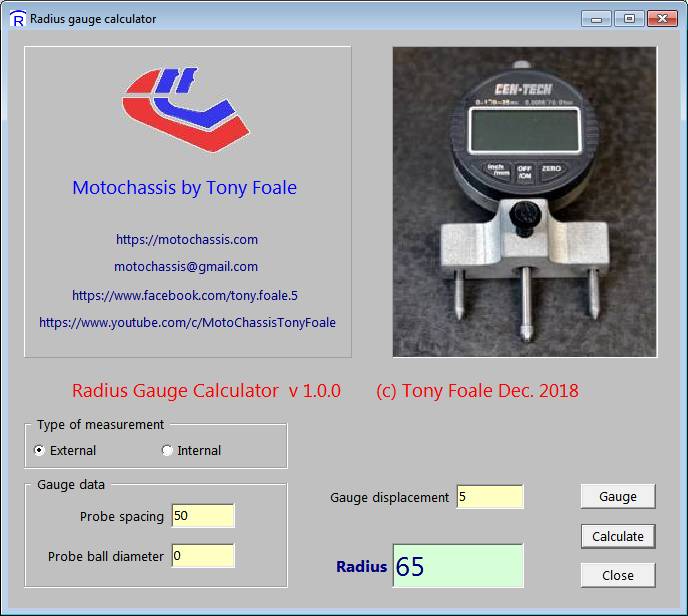

Tony Foale has described a radius gauge...
http://www.homemadetools.net/forum/r...ineering-70673
based on the principle of measuring a chord and its related sagitta and then using these values to compute the radius of the measured curve.

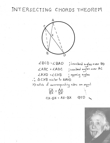

This diagram will help to understand the mathematical notation...
The tips of the caliper jaws are at locations B and D. The line BD is the chord and that is what the calipers are measuring. The sagitta, EC (marked S in the diagram) is the distance from the chord to the circle's circumference. It should be obvious that that is the length of the caliper's jaws. Just to be clear, the following picture shows what you need to measure to find the length of your caliper's jaws...

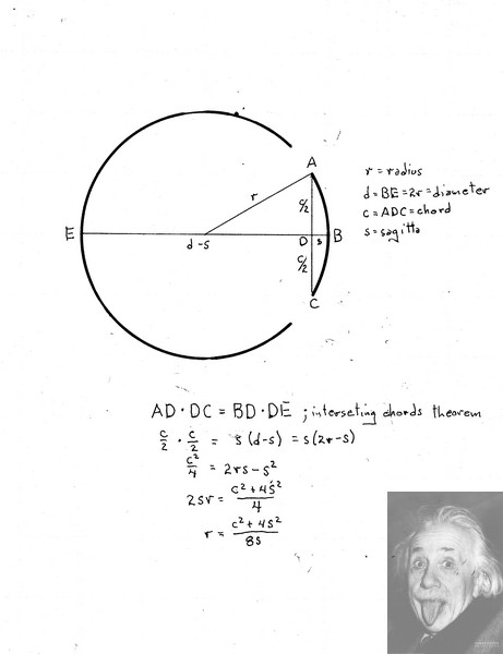

Now, if you know the length of the chord and the sagitta, you can compute the radius of the curve from a simple formula...
r = (c^2 + 4 * s^2) / (8 * s)
d = 2 * r = (c^2 + 4 * s^2) / (4 * s)
c = chord
s = sagitta
r = radius
d = diameter
How well does it work ? Well, of course, that depends on your instruments and how carefully you measure.
For the bench block pictured, I made the following measurements...
c = 2.859
s = 1.159
and computed a diameter of 2.922. I then used my height gauge to measure the diameter (the jaws of my larger calipers are too short) and got a diameter of 2.924. YMMV.
