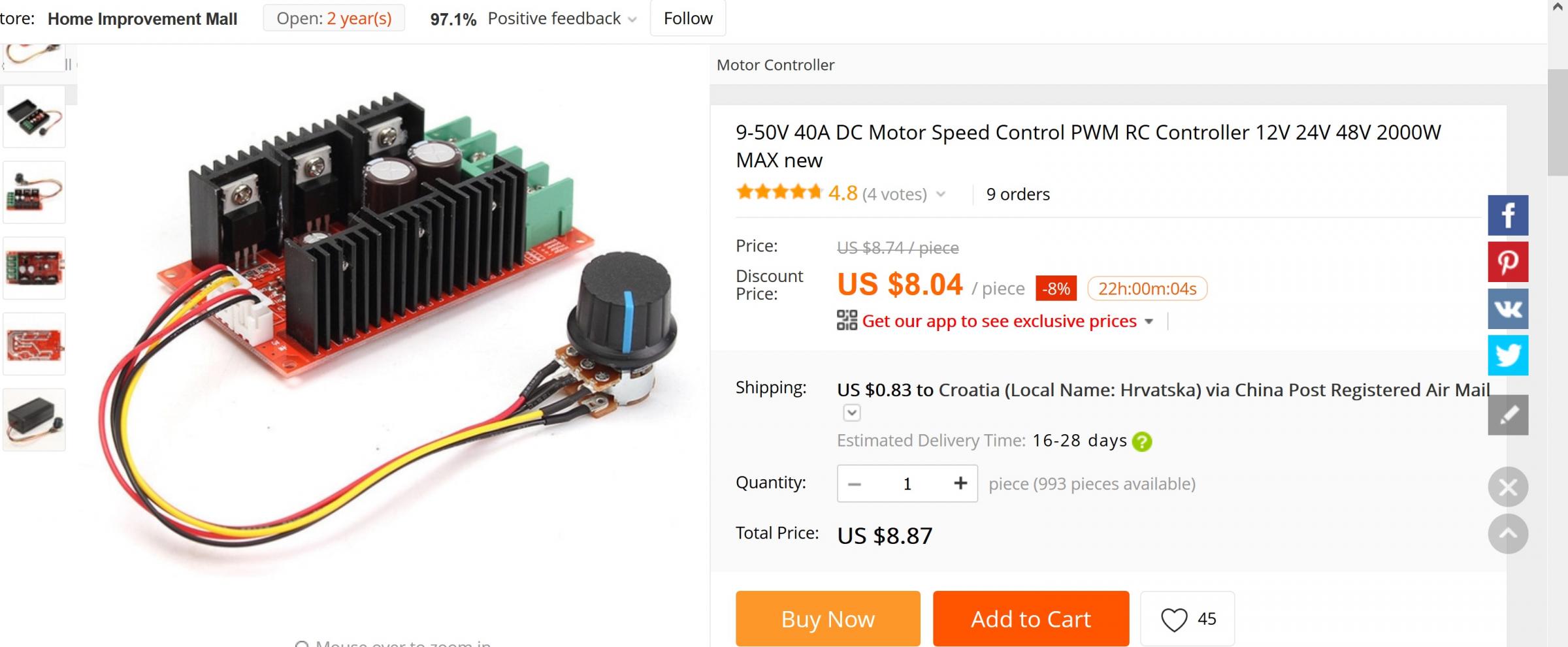

    Additional info
    PWM Controller
    9-50V 40A DC Motor Speed Control PWM RC Controller 12V 24V 48V 2000W MAX
    can be found at
    https://www.aliexpress.com/item/9-50...5bc57f6927jZ1J
    Cheers
    LMMasterMariner
