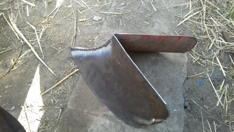

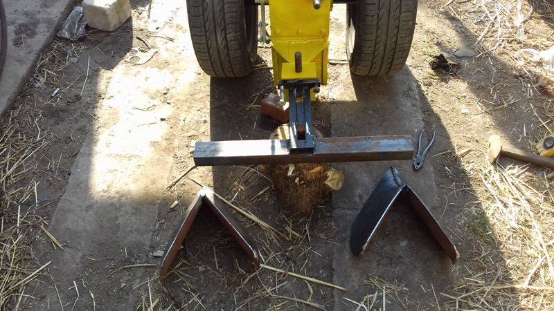

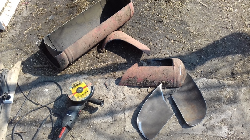

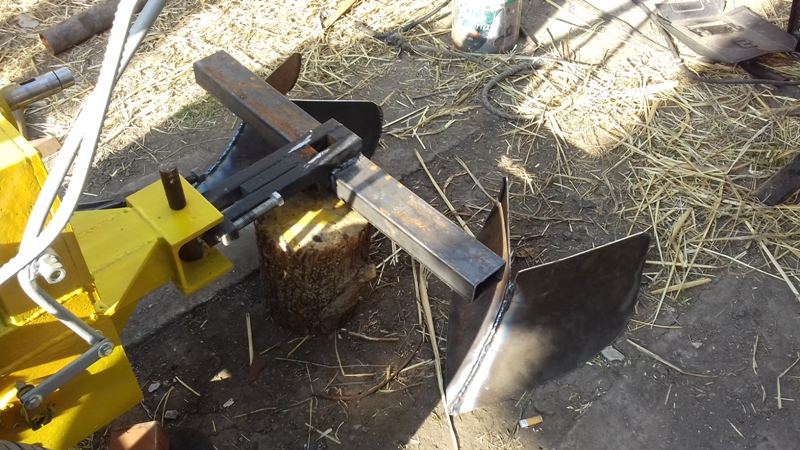

    Making a plow from an old propane balloon
    Homemade two wheel behind tractor-20190406_103848.jpg Homemade two wheel behind tractor-20190406_164401.jpg Homemade two wheel behind tractor-20190406_164318.jpgHomemade two wheel behind tractor-20190406_164329.jpg

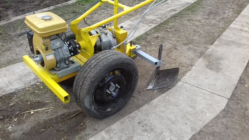

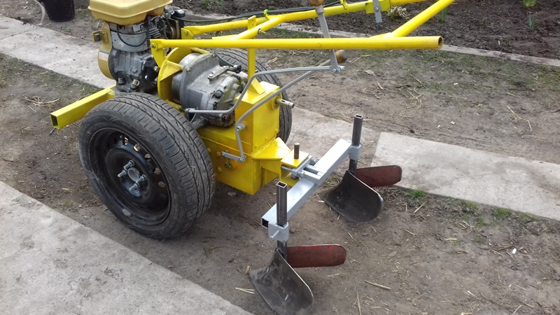

    Finally, the first work and field trials
