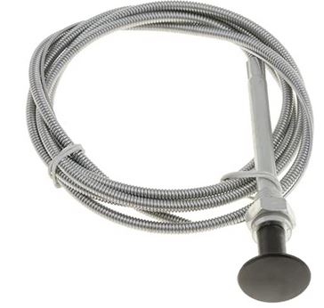

    This brings to mind one of my favorite problem solver devices. On big trucks and other machinery there is commonly a power takeoff control, which consists of a rubber coated long spring guide through which a solid but flexible metal wire travels with a knob at one one, used to operate machinery controls. Since it can deliver a significant amount of force by pushing or pulling on the knob and the guide is small and flexible enough to reach into many difficult to access locations often times it's a great, cheap solution for difficult controls. Some even come with a hand tightened friction nut to lock the wire at any position within its travel range.
    Here's one I found at Amazon that's only $7.
