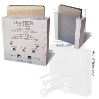

    Nice work on your build. This would be just the tool for cutting a circlip groove in a screw for various reasons.
    If one is simply needing a screw shortening tool, a guillotine style bolt shear such as this one used in the aircraft industry, works well and is fast & easy to use: SCREW & BOLT SHEAR from Aircraft Spruce
