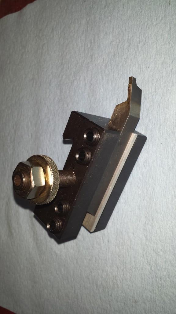

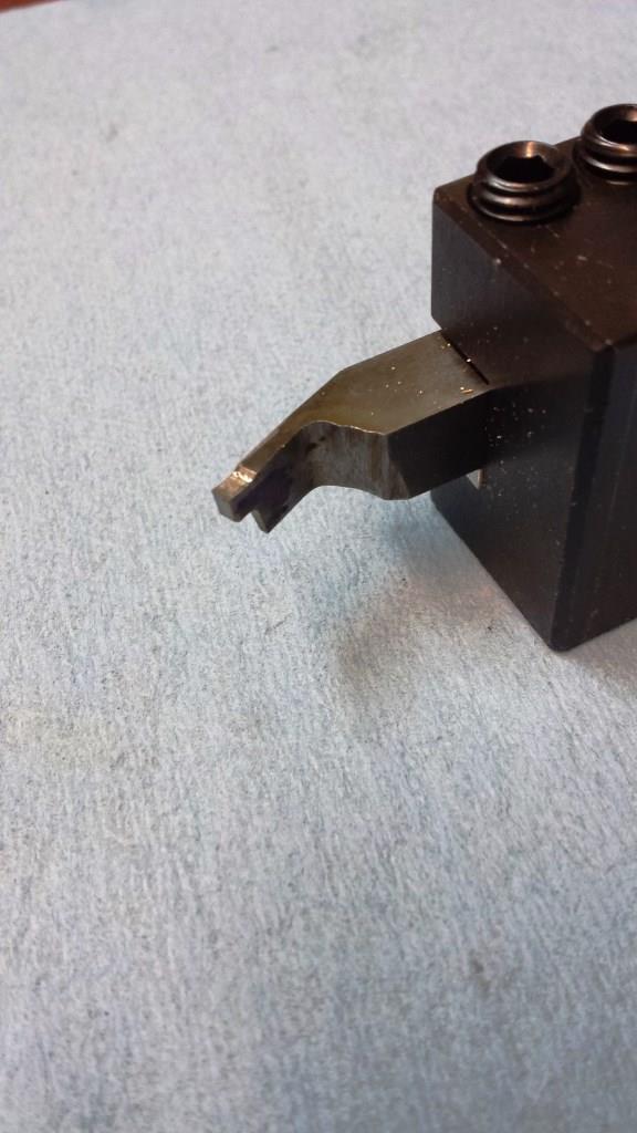

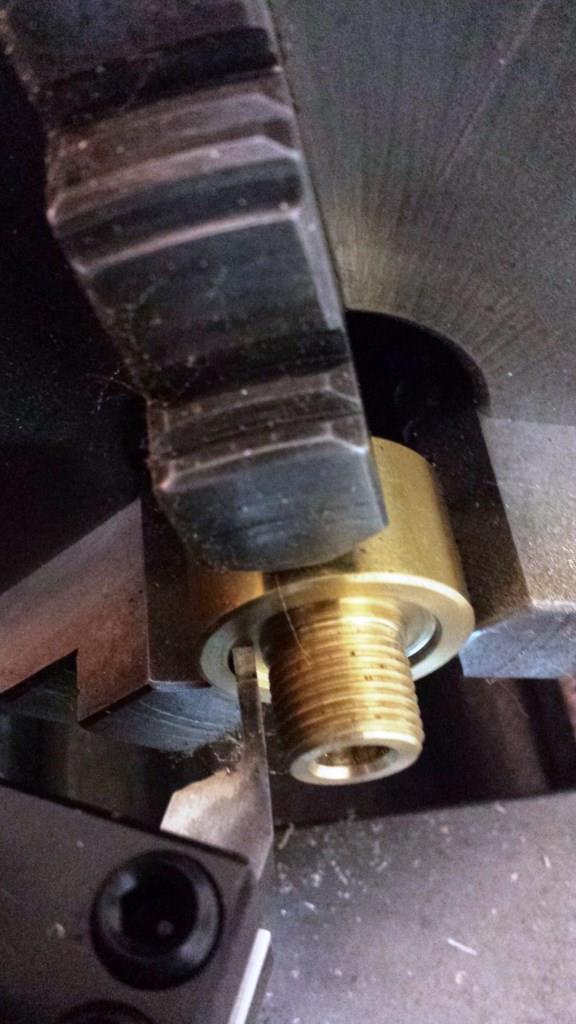

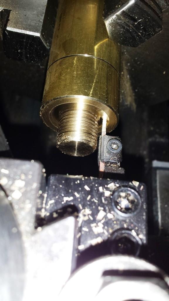

    I machined an O-ring groove located a little too close to a part’s inner corner for using my old lathe O-ring cutting tool. I tried running the lathe in reverse so I could approach the O-ring groove from the more narrow side of my O-ring cutting tool but still not enough room for the tool.

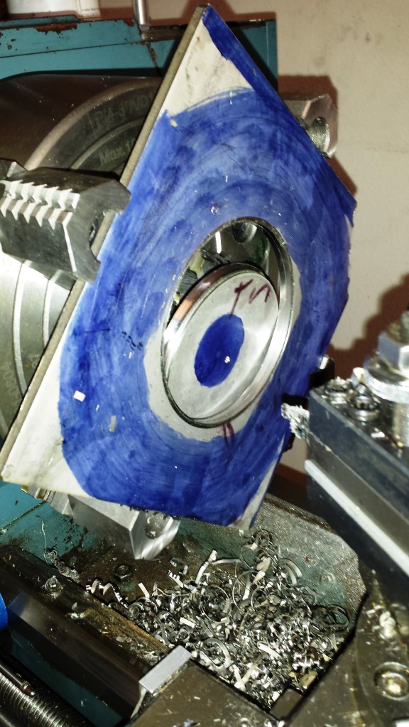

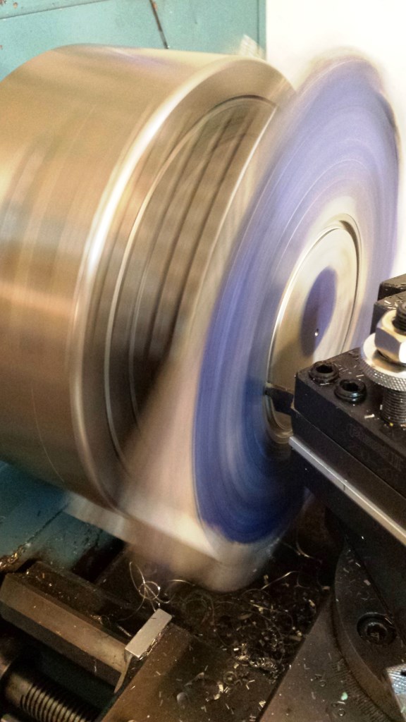

    I have been wanting a more universal O-ring cutting tool so I ground a new O-ring cutting tool made from an old blank of Rex AAA HSS. The tool cutting face width is 0.095” and 0.5” long (to the shoulder) and ground at an offset of 30 degrees from the center line to provide better access. In addition to using the cutting tool for making O-ring grooves, it is also does a great job as a trepanning tool. I used it recently to remove a 3.5” diameter center section from a plate of T-304 stainless steel. The Rex AAA HSS had no trouble trepanning the stainless steel. I included some photos of the tool at work.

    Thanks Paul! Your grind work is beautiful and the radii...Wow! Never heard of the tool material but took a look at Crucible's site. Lots of tungsten (18%) and seems to have a balanced all around toughness, hardness and abrasion resistance at 64-66HRC. Did you have to grind it with diamond or special stone and are they good for particular metals? Can't see much of a rake (clearance angle) to it? Thanks for the tip on these!
    Looks like your 4 jaw was about maxed out on that plate but the finish looked great from what I could see!! Made a custom trepan/o-ring cutter out of a P1 cuttoff blade a while back to use on acrylic. The thin undersection of the P1 worked great for cooling from the hot plastic...slow to work but did fine with it. Thanks for sharing your great work! ~PJ

    Thanks PJs. The Rex AAA HSS tool bit is one very tough cookie but can be ground with conventional aluminum oxide wheels on a pedestal grinder using a rough 36/46 grit to take away most of the material. The final grind finish was with 120 grit silicon carbide wheels.
    I have another pedestal grinder (toolmaker style) that has 100 and 220 grit diamond wheels but didn't want to waste the diamonds on this tool but may use the 220 grit to product an ultra smooth finish if needed next time. I ground a 10 degree side angle clearances on the sides of tool and added an undercut to the front tip by removing 0.22" for more clearance for the small radius O-ring grooves. In the trepanning work for the T-304 stainless steel plate, I had to run the lathe at 70 RPM and still ran into a lot of chatter and squeak (you know it is bad when even the dogs leave the garage because of the noise - I had my -30dB ear muffs on ). Thanks for the questions, Paul
