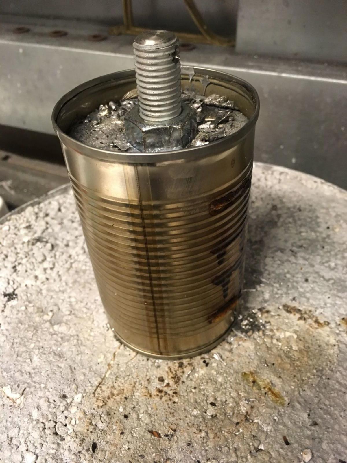

    Cheapo tip for free* lead alloy (app 2-3 % tin):
    Some forty years ago I had a need for lead, and a few dozens of kilos would suffice (I won't tell what for),
    so I fixed myself an improvised shovel from thin perforated steel plate with lotsa 4 mm holes in it.
    Brought that and a few empty 10 L paint cans to the local .22 cal shooting range,
    and (at a time it wasn't in its intended use) I dug thru the sand bullet trap (or whatever it's called in H M English).
    The low energies of these bullets gives you fairly shallow and easy work. Sand sifts thru - bullets stays in the shovel.
    15 minutes of labor and the filled cans couldn't even be budged (113 kg per 10L).
    Had to empty them out to 1/3, and they still weighed app 35 kilos apiece...
    Smart thing: .22 bullets don't have any jackets and the thin plating goes into the dross, giving you a clean pour.
    *Don't know if this practise is acceptable or allowed today, tho.
    I still haven't run out of lead, 40 years later.
    Filled a crushed tomato can last February to easily achieve a Q & D 4,4 kg point load weight for a colleague,
    instead of his suggested "Just turn away 55 % of this free cast iron block I brought you":
Name:	4.4 kg lead can.jpg
ID:	31106 Click image for larger version.
Name:	Finished point load.jpg
    How to:
    Use a gas absorbing respirator and PPE as you already stated.
    Melt on a stovetop in an aluminium saucepan, though it takes some time and is tedious
    as the heat conductivity of lead is pretty bad, spoon out the dross and pour in mold/ into billets.
