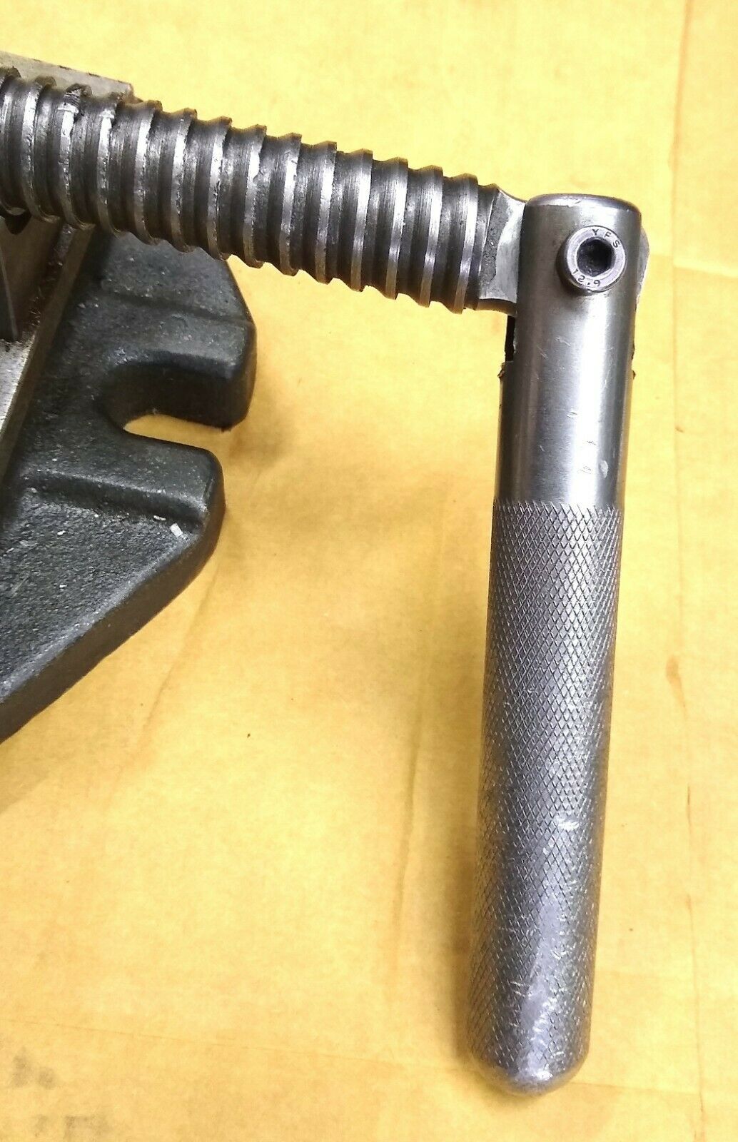

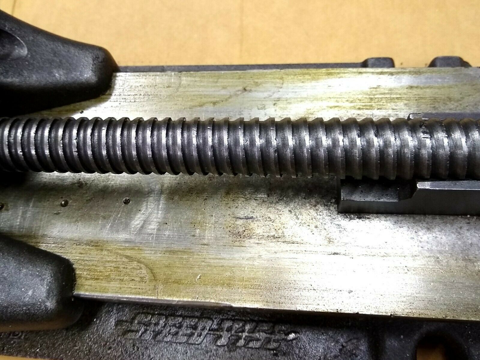

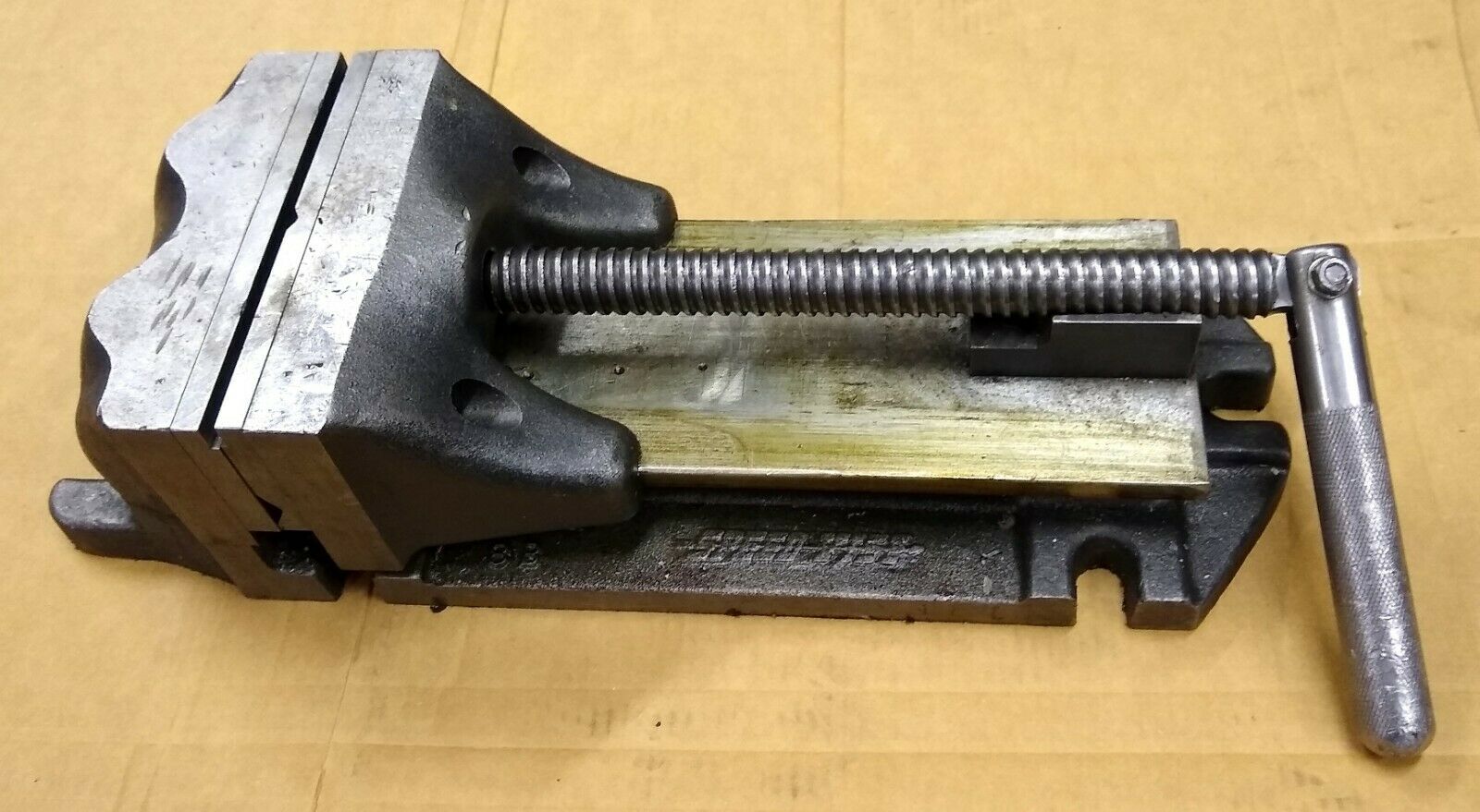

    Vise Frank S refers to is likely a "Cardinal Speed-Vise" With half nut about 3 or 4 diameters long, heat treated, and screwed to base casting.
    I doubt one would strip under load like Tuomas's vise. And if it did, make a couple spares beforehand.

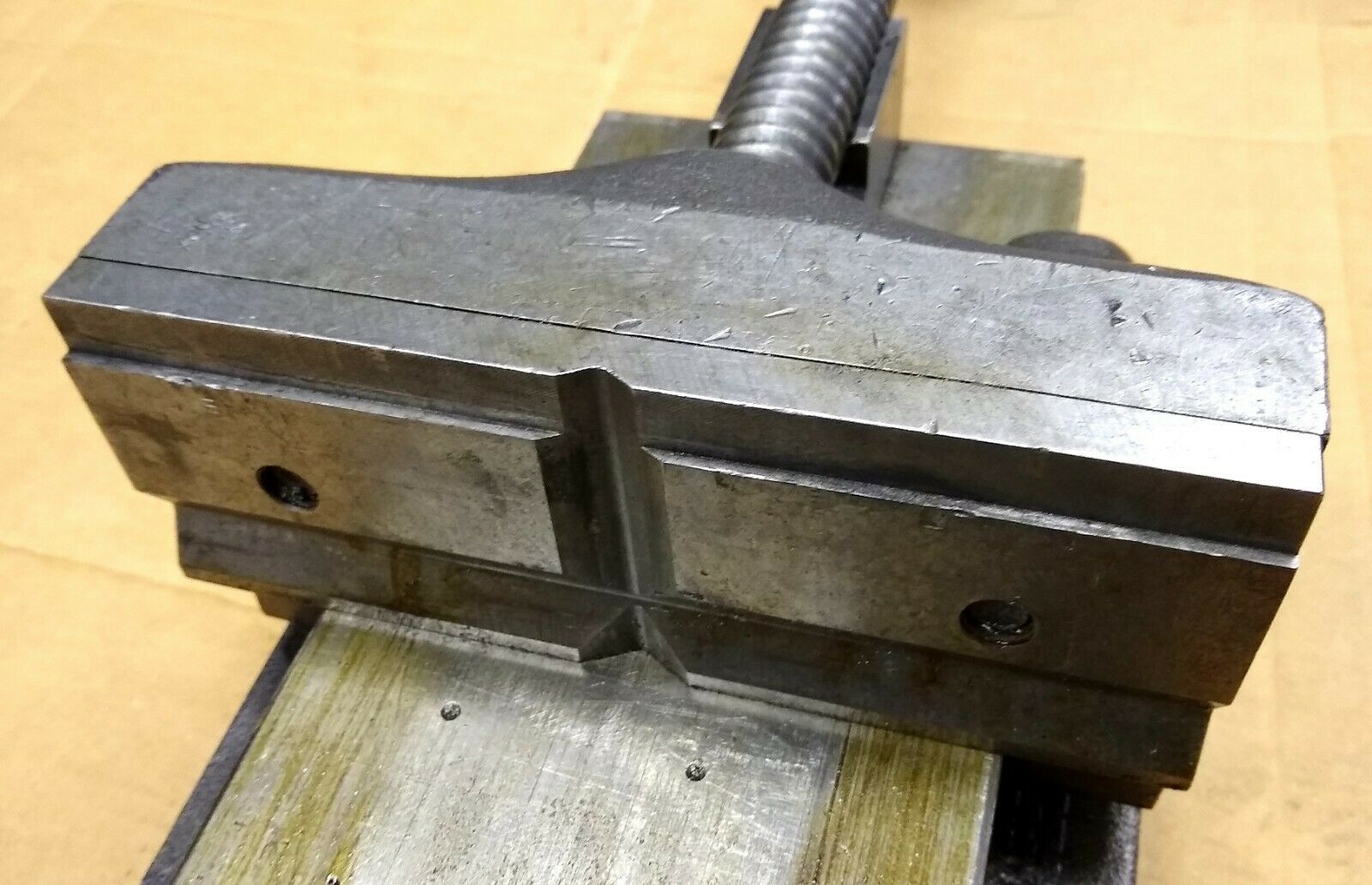

    Yes that is exactly the vice I had, here is some pictures of one just like mine

    I didn't meant to be rude in my previous answer.
    Its hard to find right words sometimes when things are said different way in my culture.
    Like this vise that you posted.
    Its the trheaded rod that moves, and if you don't lift it with your hand, it leans to half nut.
    That would have been unwanted feature when used with a jack.
    I designed mine, so that threads move inside outer "slide" and stays secured from wearing out / leaning against any surface when vise is converted to be used with a hydraulic jack. That kind of vise is great in drill press etc, but maybe not optimal design when making a vise with bigger/higher jaws?

    Yes I understand how your design worked for the quick vice feature by clamping both sides of the slide.
    What I was thinking of would have been an opening and closing half nut design where the 2 halves move in to close and out to open then the lead screw would function just as yours does. However there might be a downside to a system like the one I mentioned, that being slots may have been needed in both sides of the slide thereby weakening the vice or causing the design to need altering to reduce any weakening.

    Yep, that's the guy. I recall the nut longer, but maybe there was a selection. These were spawned by the aircraft industry to enhance production, Gardena CA. Parts are still available, but didn't find who holds the rights.
