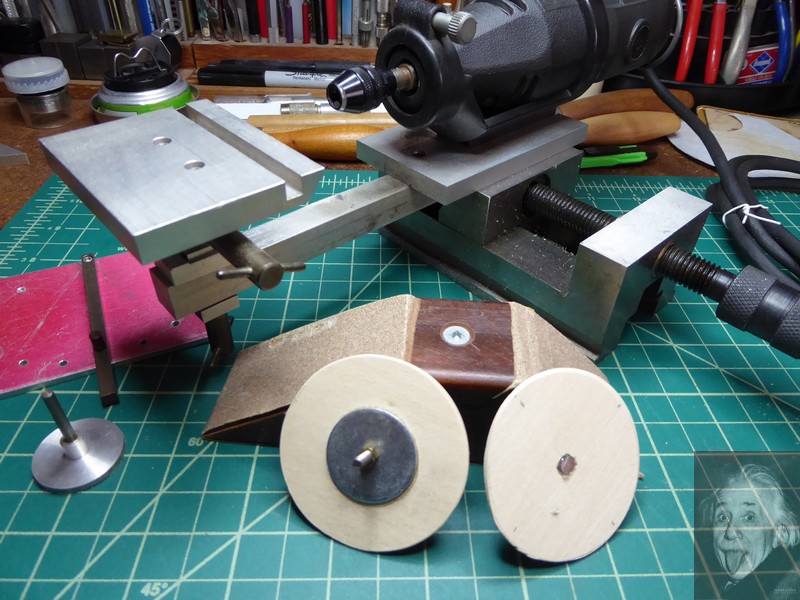

    My Dremel sanding/grinding setup would benefit a lot from a sanding disk larger than those sold by Dremel so I decided to make my own.
    I used the fender washer & 5-40 screw and nut assembly described in my mechanical demagnetizer post...
    DIY Demagnetising tool that works
    as the basis and glued a 2" diameter wooden disk to the washer. A central hole in the wood provides relief for the screw head.

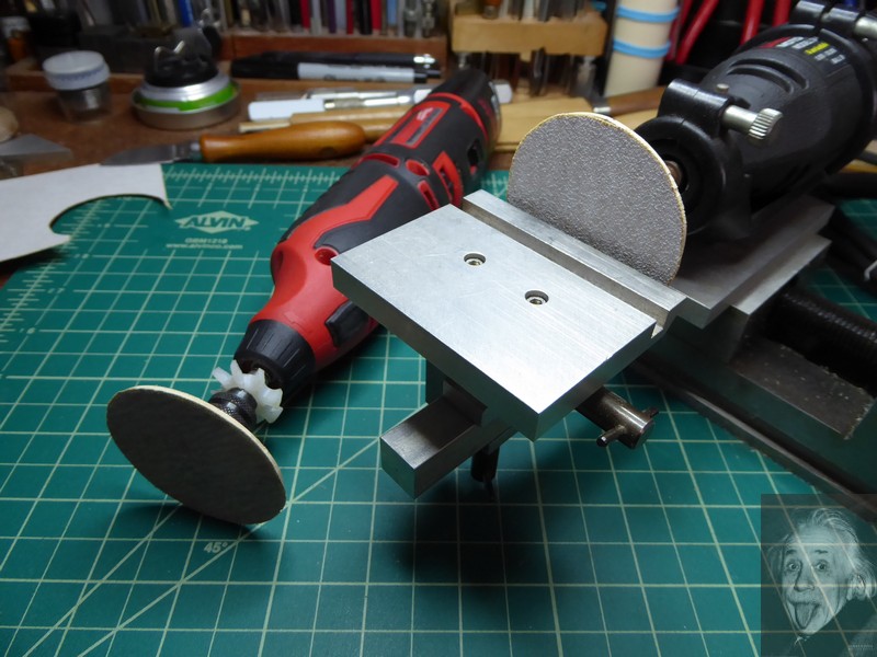

    Sandpaper disks were cut from some self-stick sandpaper and applied to the wooden disks.
    I'm pleased to report that they work very well.
