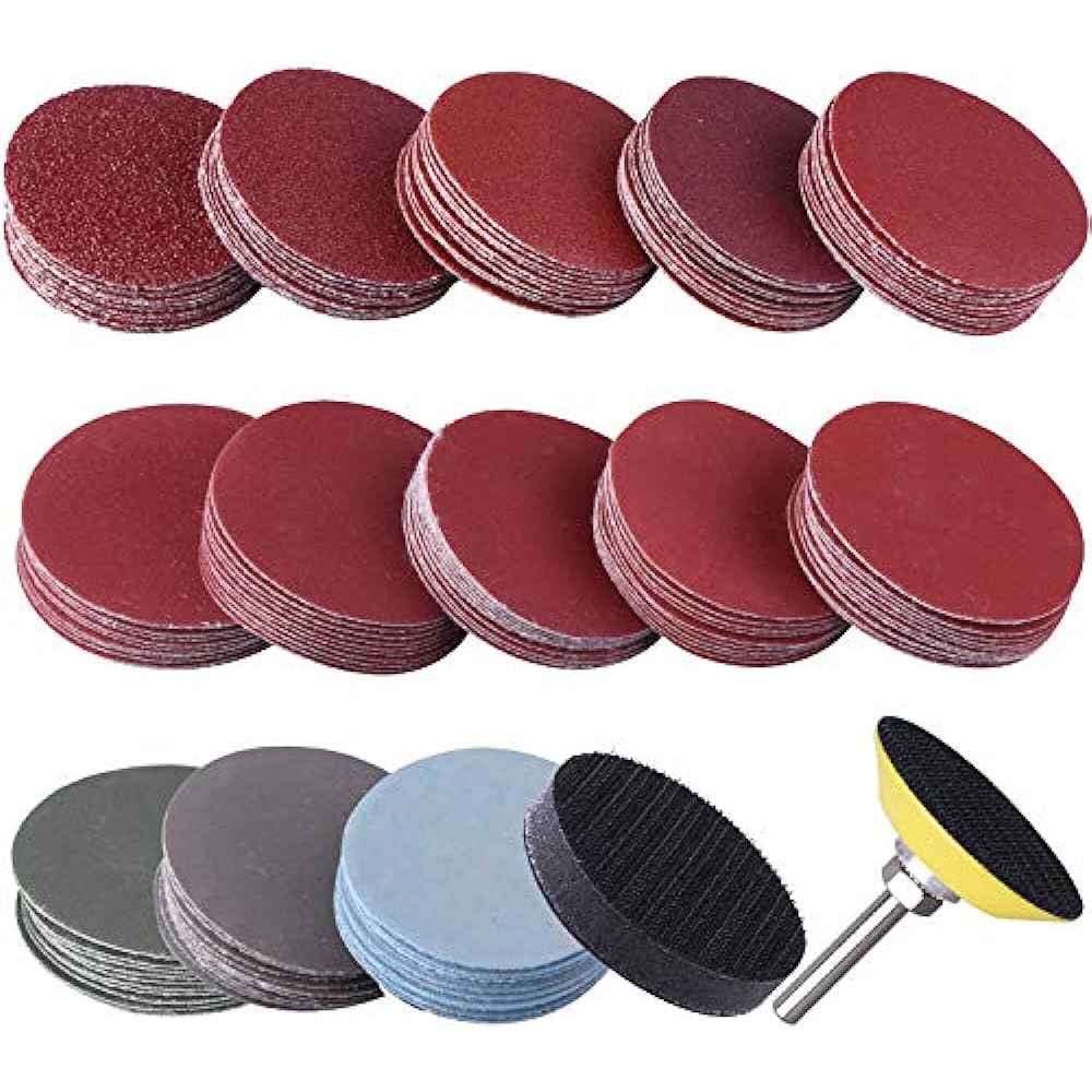

    2 of my rotary tools have interchangeable collets allowing me to use 6mm or 1/4" shank die grinder burs and attachments. for sanding disks I use these.
