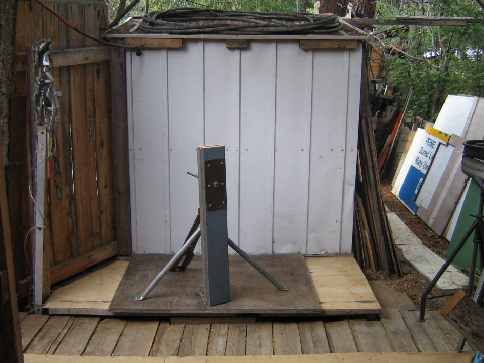

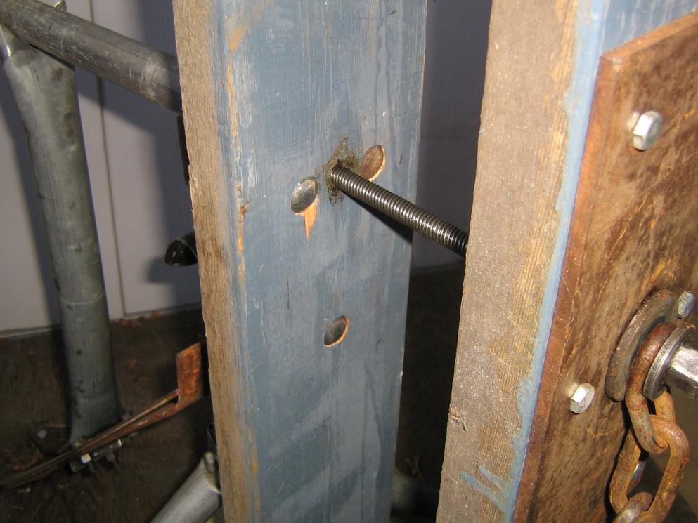

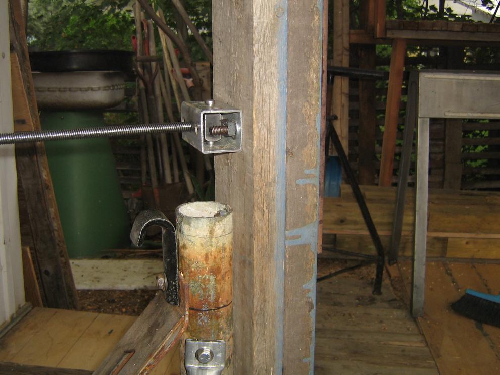

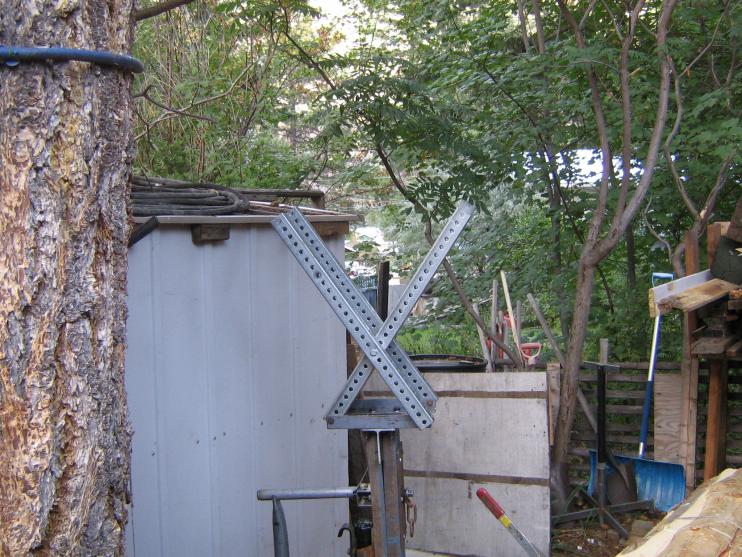

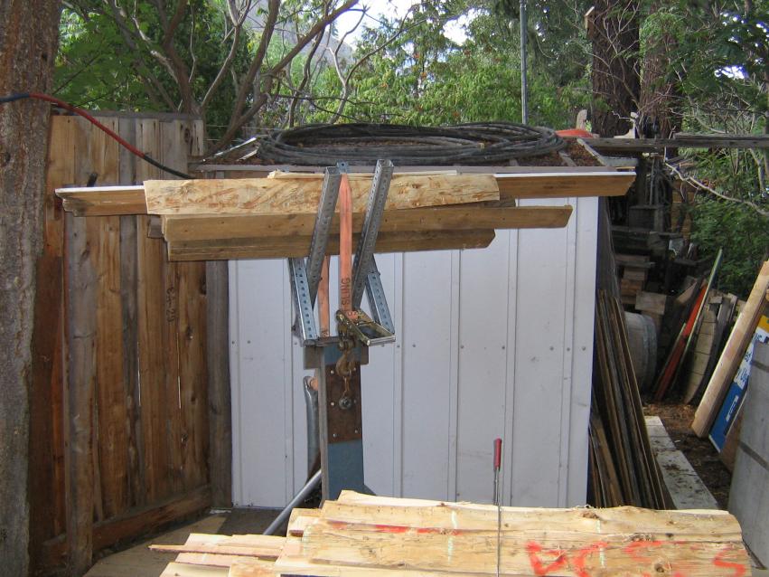

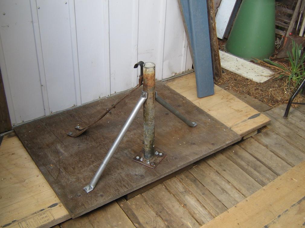

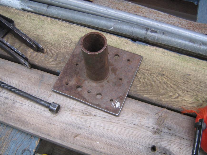

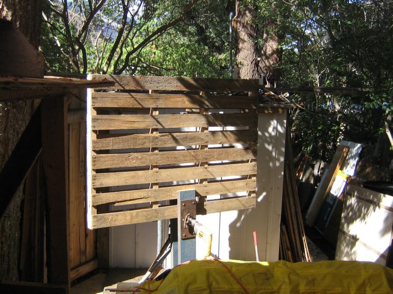

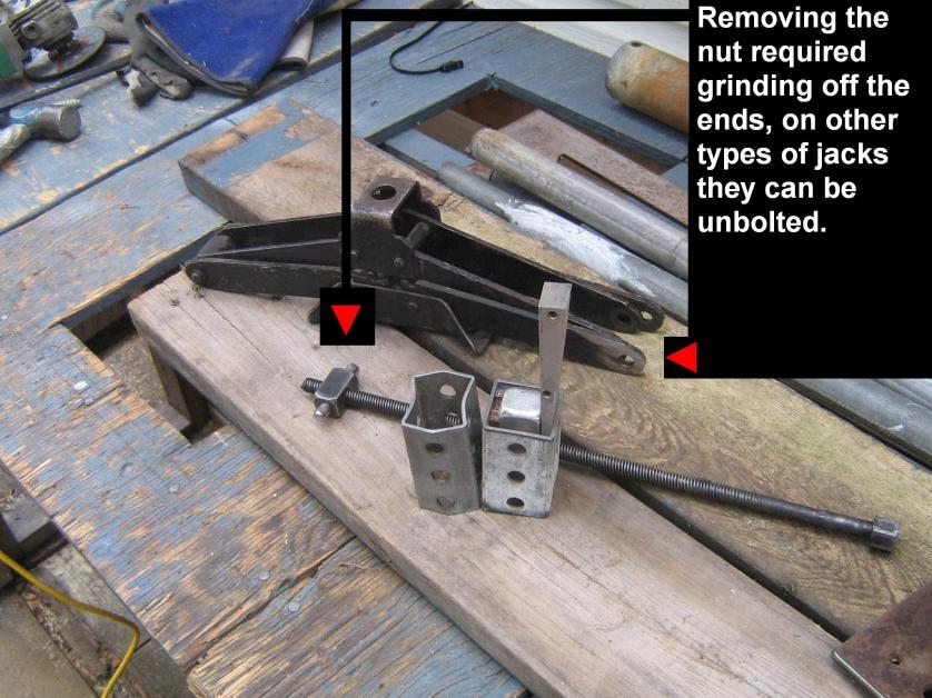

    Building a post type leg vise for safer wood cutting. Click this link for more details.
    Wood Vise | Motorsports Forum
    Attached Thumbnails Attached Thumbnails Post type leg vise for safer wood cutting.-woodvise1.jpg   Post type leg vise for safer wood cutting.-woodvise2.jpg   Post type leg vise for safer wood cutting.-woodvise4.jpg   Post type leg vise for safer wood cutting.-woodvise5.jpg   Post type leg vise for safer wood cutting.-woodvise6.jpg

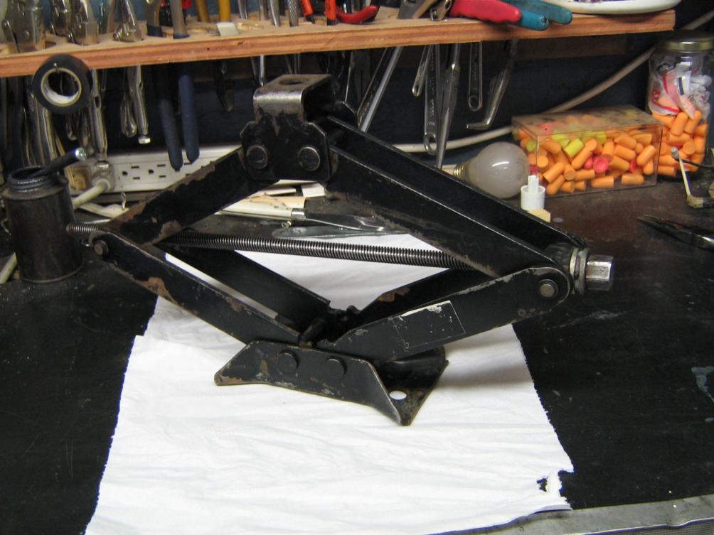

    I've seen a number of interesting projects lately that make use of a scissors jack. Never thought to use one for a vise type contraption. Time to go to the junkyard.

    Great idea pursang! Looks very stable. Quicker and safer than using sawhorses. How tall is the vise btw?

    Thanks Altair, I think my old sawhorse is pretty much retired now the stationary and moving 2"x6"s are both 36" tall.
