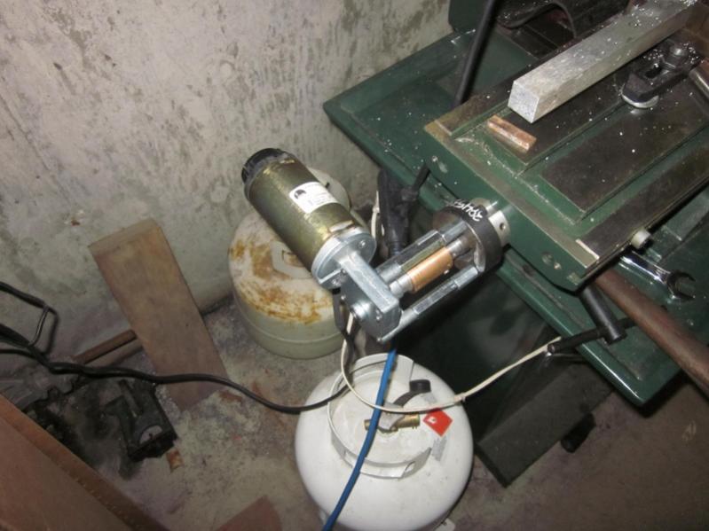

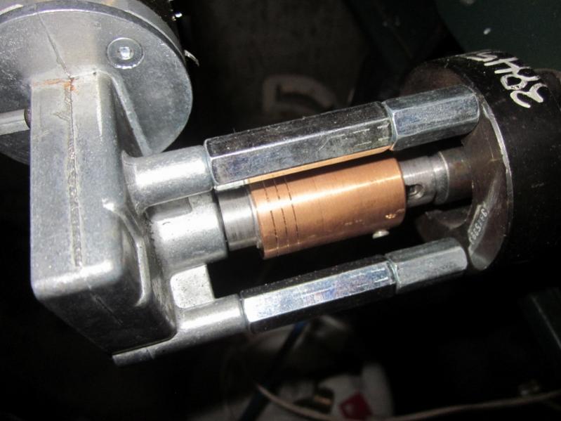

    I built this power feed for my mill a while ago and thought I would post it. The motor was purchased at Princess Auto in their bargain bin so I don't have much info on it. The speed and direction controller I got off of ebay and the power supply is a garage sall item. When I first built it I tried it out and then left it sit, it was to much trouble to unhook it when manually doing some work. I found a dog clutch article by John Krueger on-line and recently made one following his plans and changing what I had to to make it work on my Craftex mill. Now I use the power feed for most things and the amazing part is how much better finish you get with a power feed especially when fly cutting. The speed range is very good, it will go slow enough to move only .25 of an inch in 2 minutes and will move 5-6" a minute on faster setting. The clutch is very easy to use so if I want to move very fast I disconnect the feed and do it manually. I will attach some photos and the PDF file of John's clutch. The pdj is to large to upload but this is the link to it. littlemachineshop.com/projects/Drawings/ClutchConnnector.pdf

    Thanks blackangus! I've added your Mill Power Feed to our Electrical category, as well as to your builder page: blackangus' Homemade Tools. Your receipt:
    3,056
    773
    Nice build, blackangus! As you noted, I like the speed range of your power feed.
